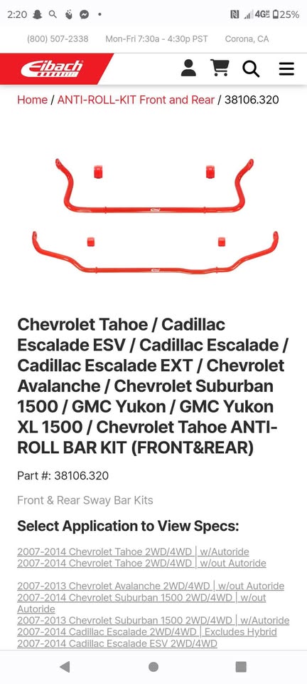

Hey guys,
I found a deal for both front and rear sway bars for $250, but I can't find any concrete answers on if it would fit my 2019 Yukon. Anyone know for sure if they'd fit? I know the Hellwigs would be better, but at $250 for this set...would it be worth it?
Thanks for any input you have!

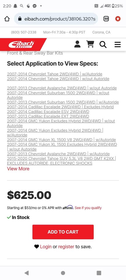

It's an FB marketplace posting, it shows 38106.320 on the listing. I did some searching and found this thread, but didn't really find a concrete answer on it: https://www.tahoeyukonforum.com/threads/has-anyone-upgraded-sway-bars-yet-on-15.100100/
Here's the pictures from the listing:

Does your Yukon have Autoride?
50,933
19,327
Then it should work. Your 2019 Yukon will be the same as Tahoe and it says that 15-20 Tahoes work as long as it doesn't have Autoride. So you should be good.

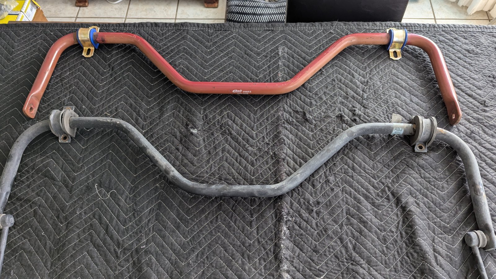

I edited the above, rear is different for the k2's (15-20) front is the same 07-2020
what the actual difference is I don't know haven't experimented with trying them
from pictures they look fairly close the endlink holes are wider, perhaps due to vehicle height differences from the gmt900 to the k2's
top is 07-14, bottom is 15-20
the hellwig endlinks are adjustable so unless the bends are different horizontally then you could probably make it work either way

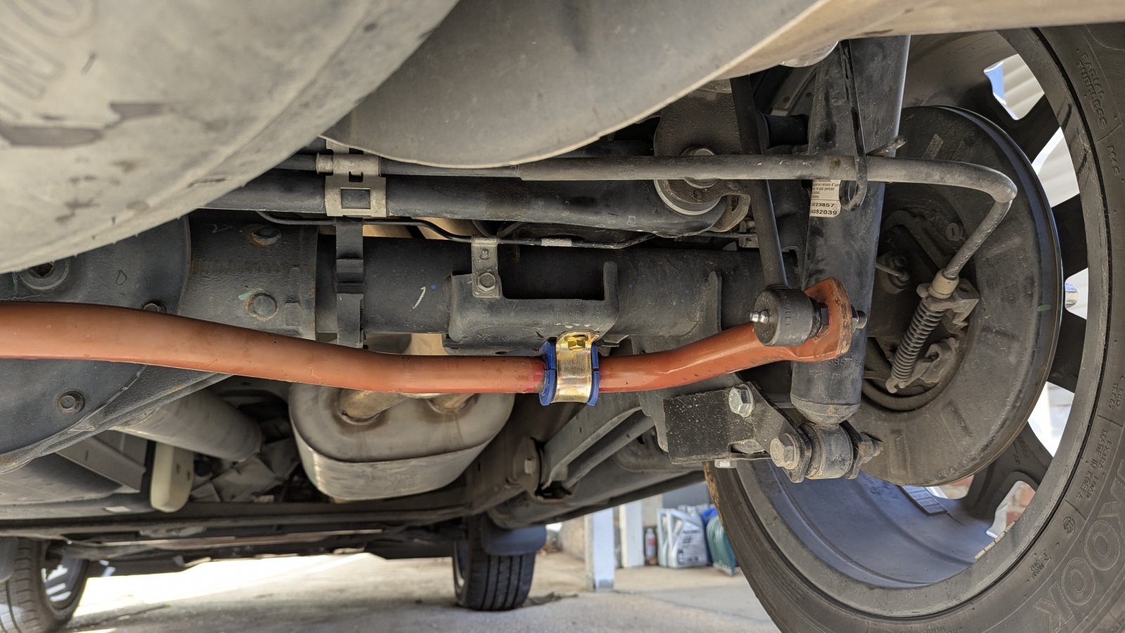

Rear bar is completed. I used some stock Moog replacement endlinks, and Moog K7326 Bushings. Everything bolted right in. What a difference! I haven't sourced front bushings yet, but once I buy those I'll be installing the front bar.
