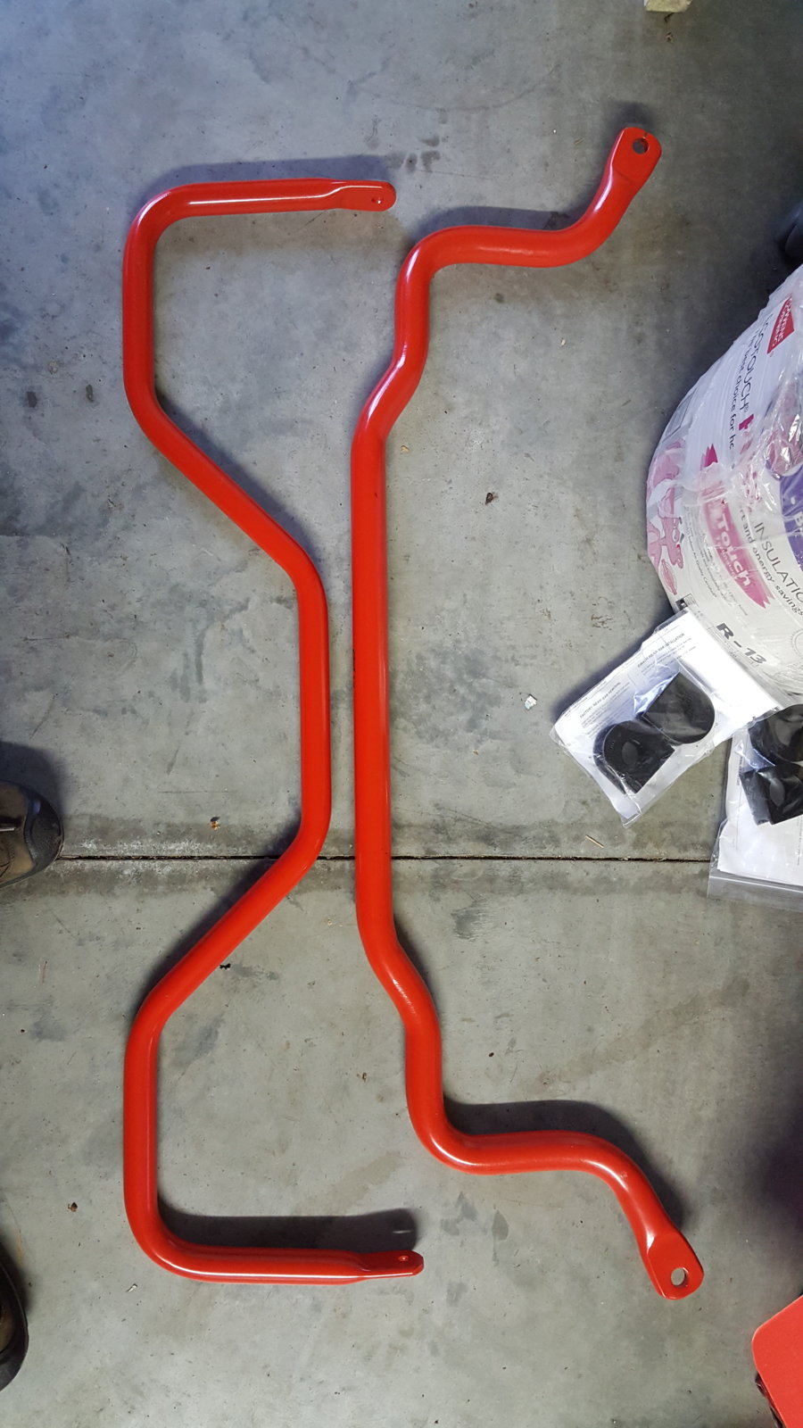

Any major difference between the Eibach swaybars versus the Hotchkis? I’ve had Hotchkis on precious vehicles and really liked how light they were with their hollow design.

Is 38106.320 the correct eibach kit for a 2015 yukon without air ride?
minytrker
Dec 4, 2014
116
30
Thats the 38mm/32mm, on summit that was the bigger kit. The other had 35mm/32mm, is there another kit out there?
CMoore711
Jul 18, 2017
1,586
1,526
Disturbing to hear that since that's the part you sold me for my 2017.
Box number: 38106.320 Front bar is: 38106.320F Rear bar is: 3882.320R
According to Eibach's descripton of the 38106.320 the front and rear sway bar kit consists of a front sway bar that is 38mm and a rear sway bar that is 32mm.
https://eibach.com/us/i-7231-anti-roll-kit-front-and-rear-sway-bars.html
as well as on Summit Racing: https://www.summitracing.com/parts/...MI9aW_hLCy2QIVkIJpCh3Uqw3REAQYAiABEgKnS_D_BwE
So unless Eibach offers a front sway bar that is larger than 38mm and a rear that is larger than 32mm, and not listed on their site, I would say that your 38106.320 kit is for the largest sway bars Eibach offers?

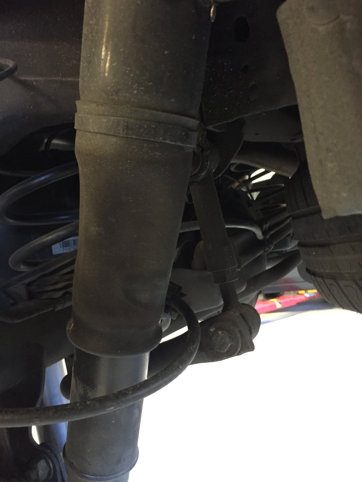

Which front and rear sway bar end links are everyone using for their lowered trucks? I know Energy Suspension has a couple that are adjustable, some sway bar kits from the various manufacturers come with end links, some don't. However, the ones that do are not always suitable for lowered trucks, but are rather suited for stock height trucks.
I will be lowering my '15 Yukon Denali XL 2"/3.5" and picking up some sway bars. Want to make sure I get shorter sway bar end links to keep the sway bars parallel after lowering.

I used a set of Hellwig adjustable for the rear. Very good quality, many different lengths, and great support! Highly recommended.

7690. 6-8” adjustable with 2” rear drop. Check your required length based on where you want the sway bar—your results may vary.
dbbd1
May 12, 2017
924
357
I think this is a typo, should be Hellwig 7960.
How did those links fit, did not have to drill out/enlarge any holes or such?
Kpwweb
Dec 11, 2015
771
357
I jave written down 7690 in my maintenance book, but it could be my lexdysia!
They fit fine. No drilling. I did have to get some more SAE thick washers as the end links were originally at an angle. Used the washers as spacers and they are more vertical now. Hellwig’s customer service was great! Top notch.
