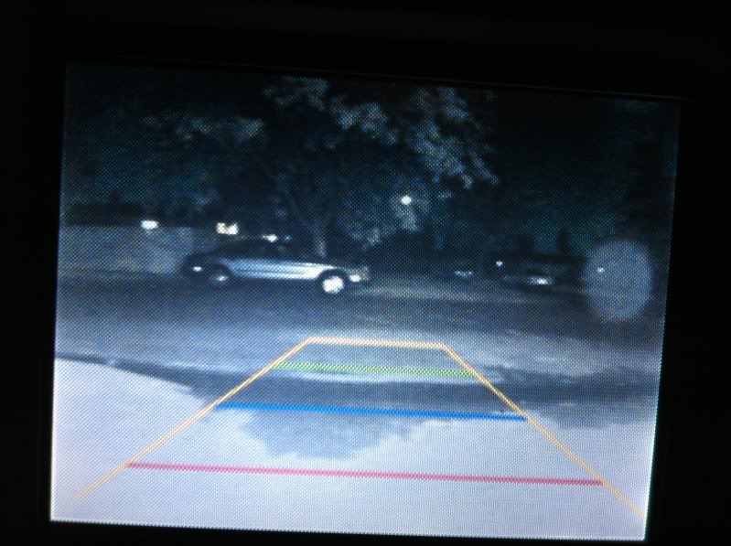

Here is another about 30 mins later it got a bit darker out side. The only issue I have with this is every time you get into the truck and its night you have to turn the brightness down on the screen. The IR light is almost too bright.
Looks like I have a water spot from today's wash I need to get rid of.
BTW the resolution on this little screen 3.5" is great for 10 years ago. It not meant to be a high Res screen. It is good enough at 2 feet away to tell where everything is at. For $48 complete for my hack job I can not complain one bit. My wife loves it so it makes it soooooo worth it, hopefully it will keep her 5'4" little butt from backing into anything.
