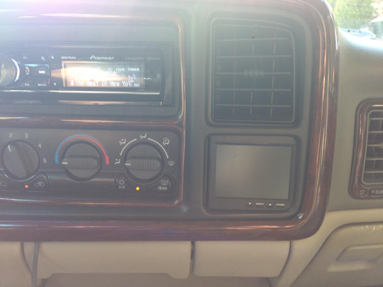

My dash seems to be different than everyone's. My radio doesn't bolt in, it slides in and there are plastics tabs that hold it in place. With that said, I can't get the left side of the screens mount all the way in because the plastic where the HVAC attaches on the right side is sticking too far over and blocking it. I took out the Dremel, but if I keep shaving, there will b no bezel left for the HVAC to attach to. Am I the only one with thi type of dash?

My guess would be that is because you have the pre '03+ dash... People with that style of dash are usually S.O.L. when it comes to things like this and have to modify things to fit right.
I have done the double din conversion and mounted my reverse camera to go with the DD
