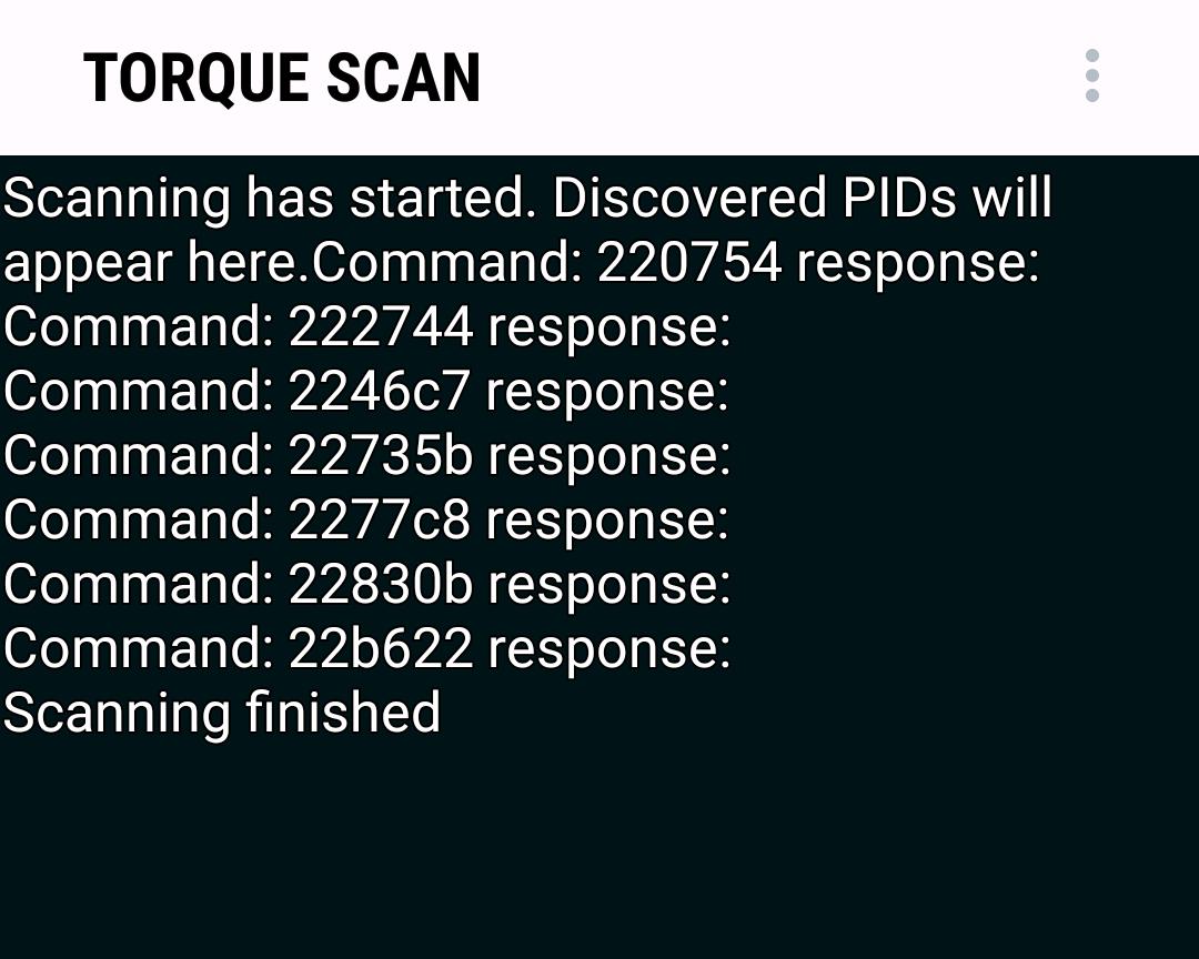

So while driving today I let the torque scan run in the Torque Pro app and here is the results... no idea what any of this means just yet...

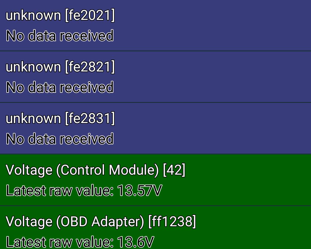

Also these show up in blue and say unknown...
Also the Transmission Temp shows up blue as well and doesn't work...
Did you download all the GM specific ones?
Click the gear
Click settings
Click manage extra PID/sensor
Click the menu top right
Click predefined set
Select Pontiac GM Opal
Click the gear
Click settings
Yes... I did that to start off with but some of them don't work... which is why I have been trying to figure out what's going on with it.
I don't know if it has something to do with the year of my truck or what.
I posted all the PIDs the scan found and haven't really dug in to research what those are.
I am also not sure what it means when it shows the "unknown" PIDs in blue...
More research for me.... Hooray!!!
Click the gear
Click settings
Thanks...that allows a few more pids lol.
Oil pressure/temp, Trans temp, knock counts a few others.
