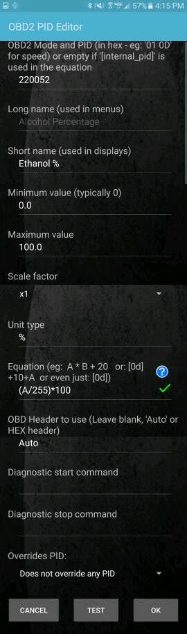

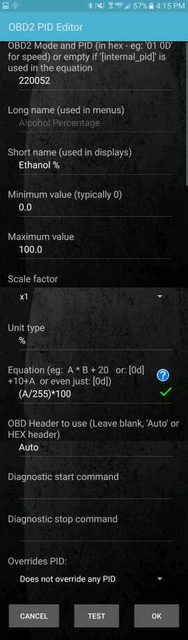

Ok so I finally figured out the proper PID parameters to show the ethanol content on my 2008.. it was as follows...
@LanceD
Since you appear to have the Oil Pressure and Oil Temperature gauges working would you mind posting up those PID parameters that you are using for your truck?
Also if you have the Transmission Temperature working that would be great also.

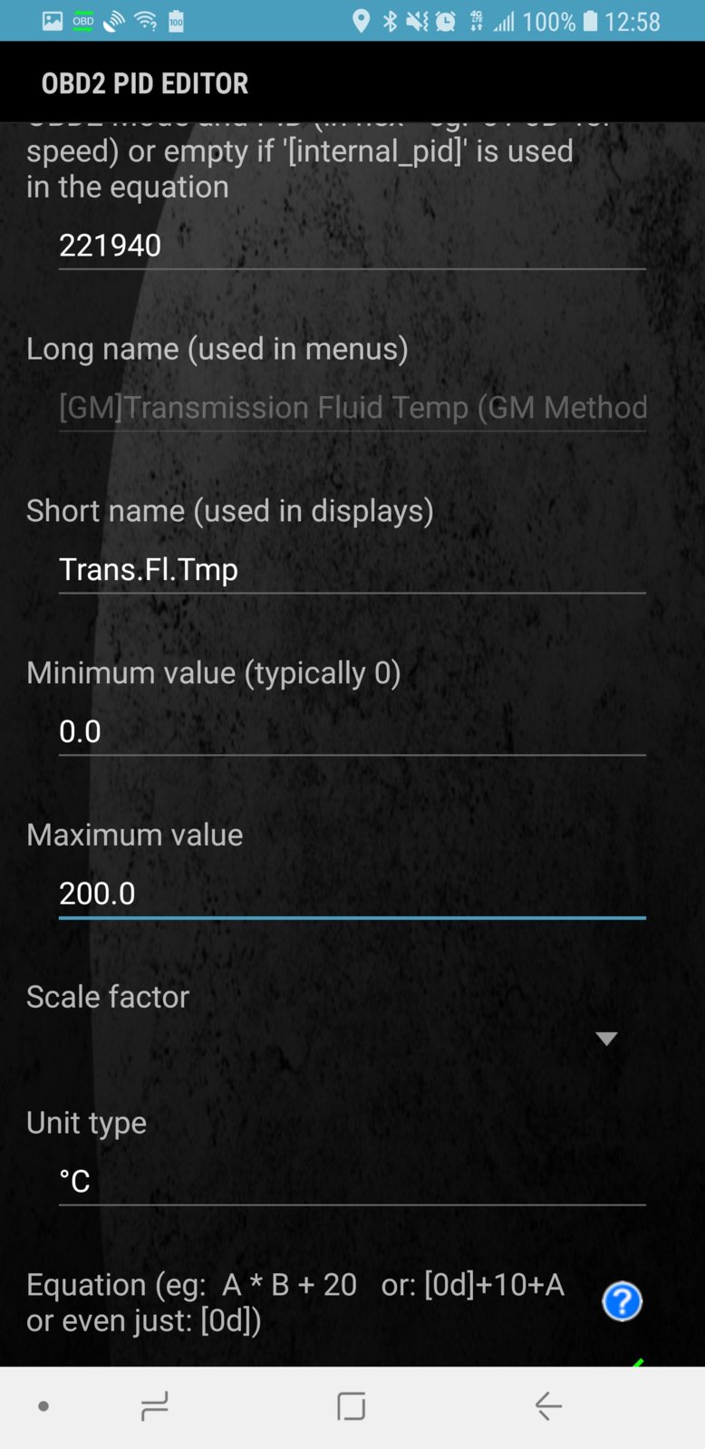

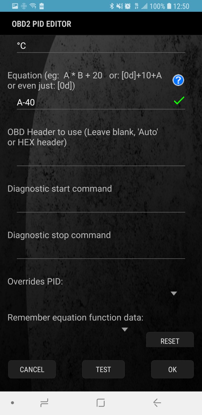

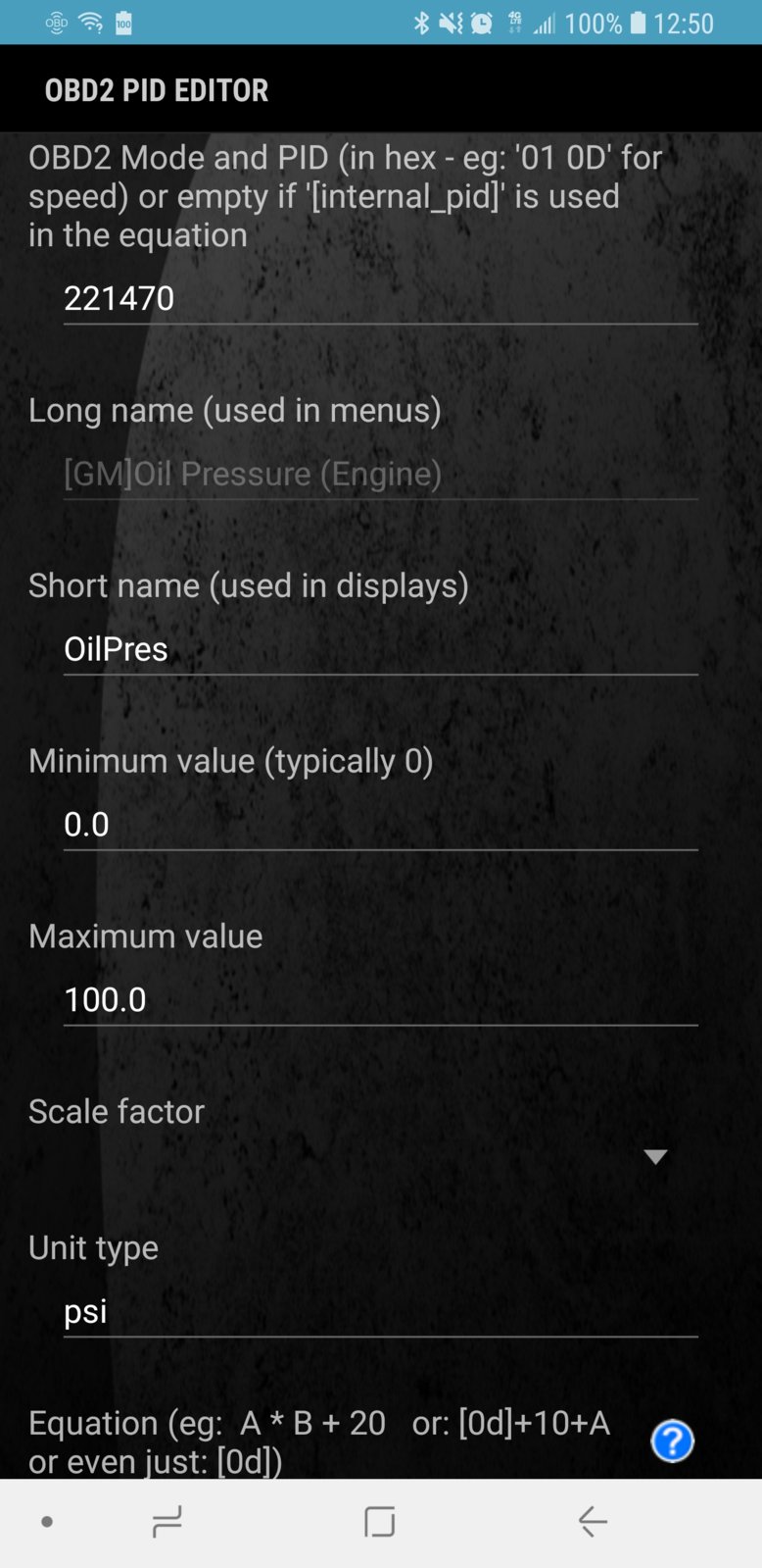

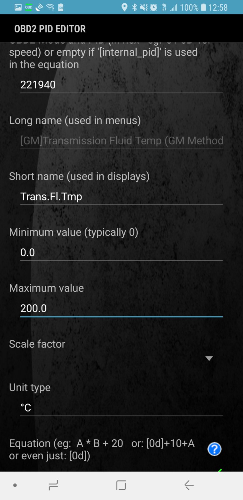

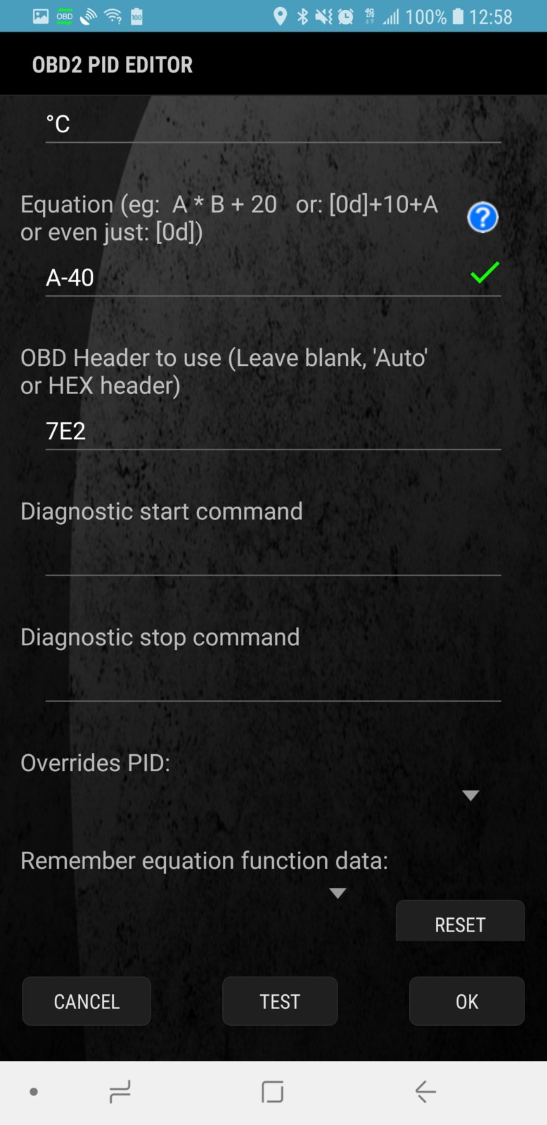

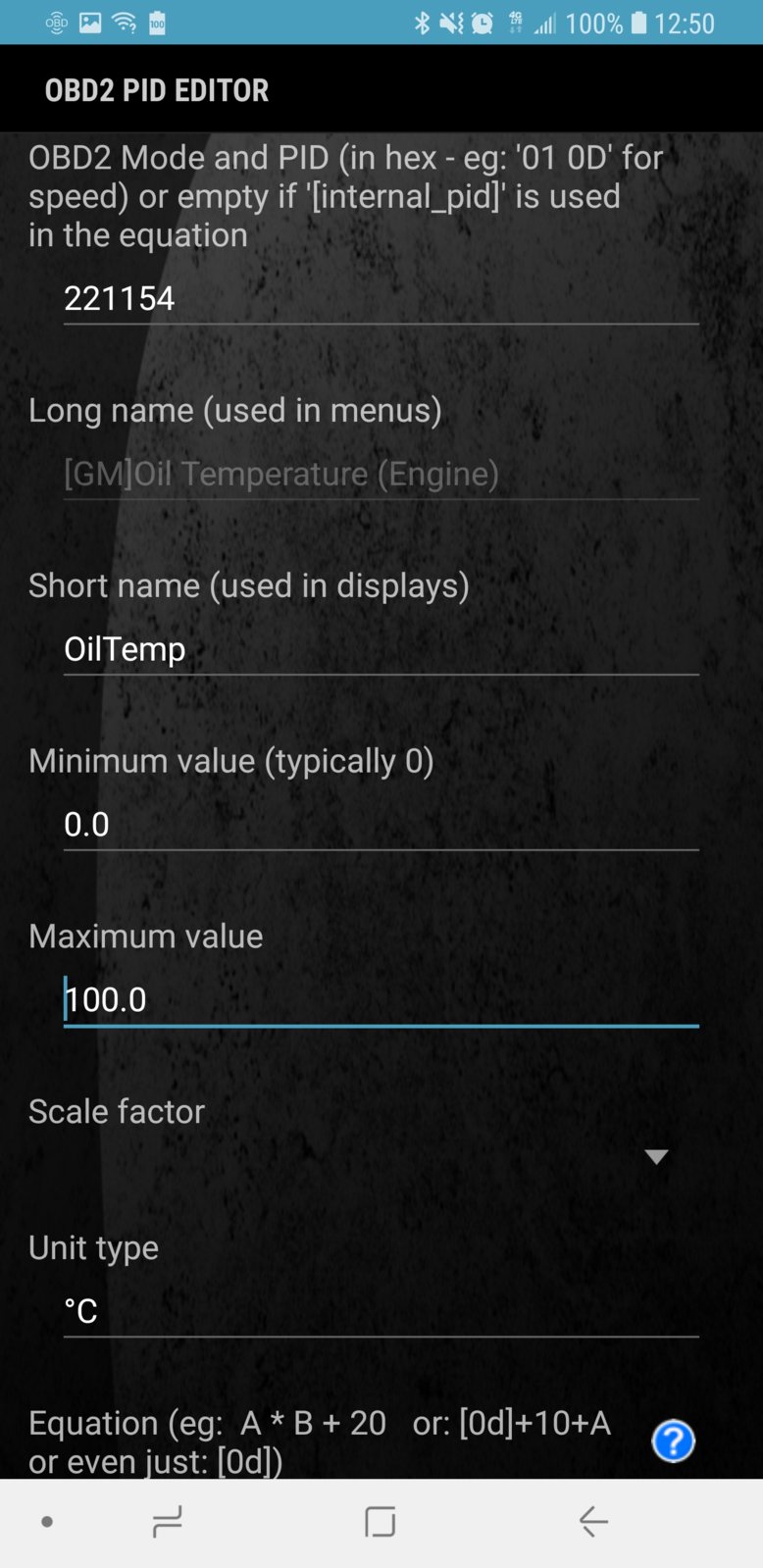

LanceD
LanceD
Jan 16, 2018
360
339
AZ
@LanceD

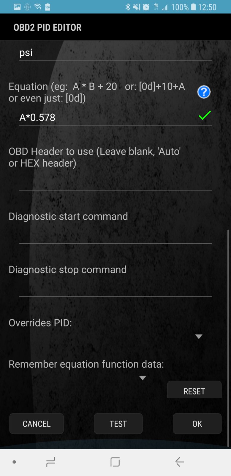

Oil temp pid is 221154 and oil pressure is 221470. Do you need all the data or just pid numbers?
kbuskill
Mar 11, 2017
5,861
9,932
NE. FL.
If it's not to much trouble to get the data/parameters that would be great.
I have tried those PIDs without success so I'm thinking it has something to do with the parameters.
My oil pressure gauge, on TP, reads data it just isn't accurate. It was originally showing I had 110 psi.
LanceD
LanceD
Jan 16, 2018
360
339
AZ
I don't know why it says C instead of F there but it seems to work
kbuskill
Mar 11, 2017
5,861
9,932
NE. FL.
No dice..... still no oil temp or transmission temp... my oil pressure is back to showing 110psi... lol
I don't know... at least I got the ethanol percentage working.

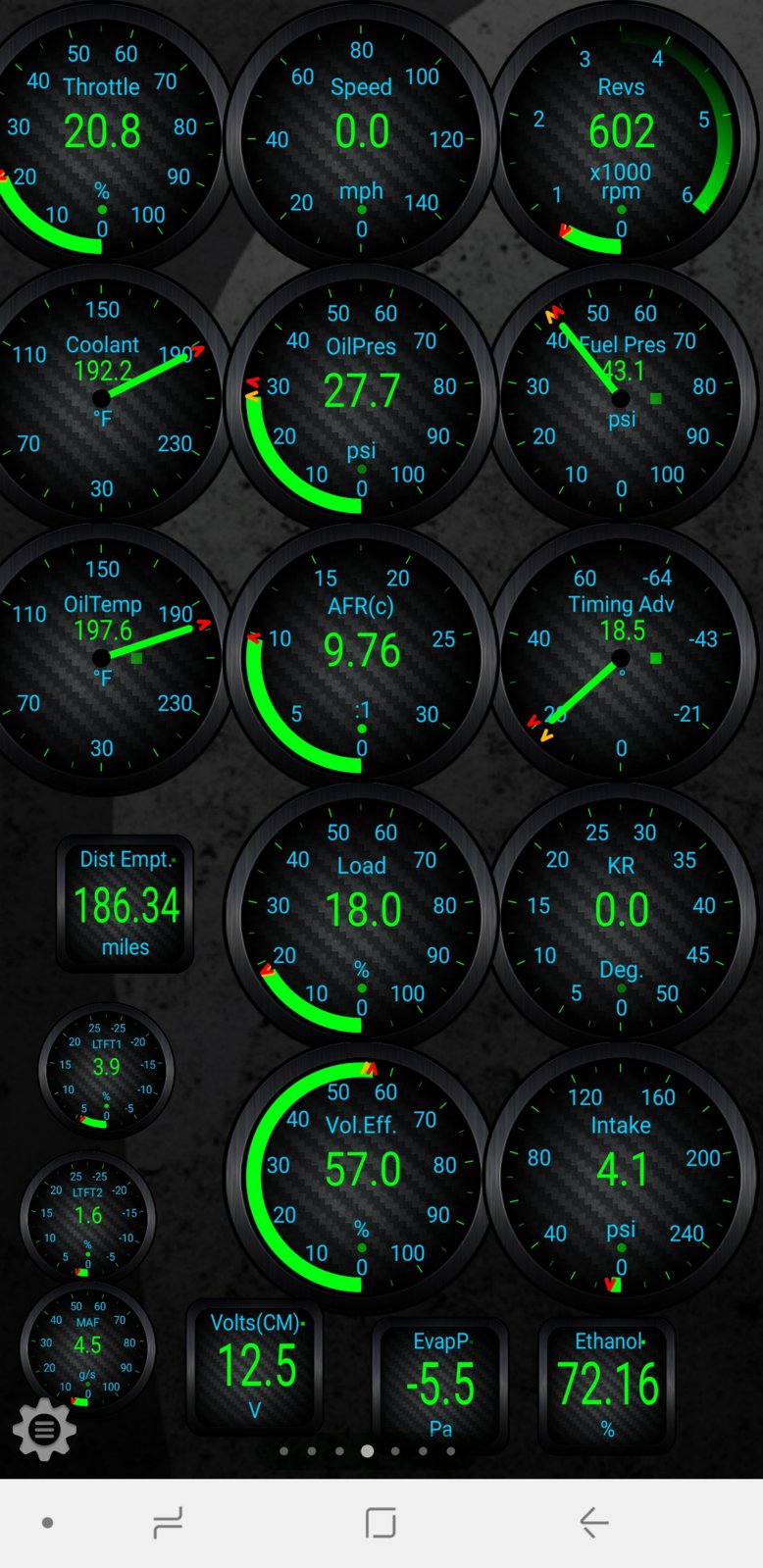

21,322
30,319
I noticed while idling that my AFR commanded was like 9.76 : 1 I guess that is do to the E85 and that 89 octane wouldn't be so rich... but that is just a guess on my part.
The AFR showed 1:1 and didn't move. That's not right now that I think about it.
A little reading comprehension tonight! I looked at it again, it actually says on my Tech2: Cmmd A/F Equivalence Ratio. Never seen it not displaying 1.0:1. This means the ratio is perfect, not too rich nor too lean. It does not show AFR like yours.
kbuskill
Mar 11, 2017
5,861
9,932
NE. FL.
Well I am about ready to throw my OBD2 scanner and Torque Pro app out the window.
I filled up last night with Mobil 89 octane so that I could get some data on MPG with the 89 octane.
I drove home watching the ethanol content and it never changed from 74.9%.
I came inside and found a post by James @swathdiver that said it takes 7 miles to reset the ethanol content... I had only driven about 5 so I get up this morning and head out... 7 miles comes around and it still didn't change. I thought, well maybe it needs 7 miles without shutting the engine off, so I continued monitoring it... I now have 22 miles on this tank and it is still showing 74.9% Ethanol.
I don't know what the deal is. Maybe it's my Chinese knock off ELM327... whatever it is, I am getting frustrated with it.
Also AFR (c) still shows 9.76:1
:banghead:
