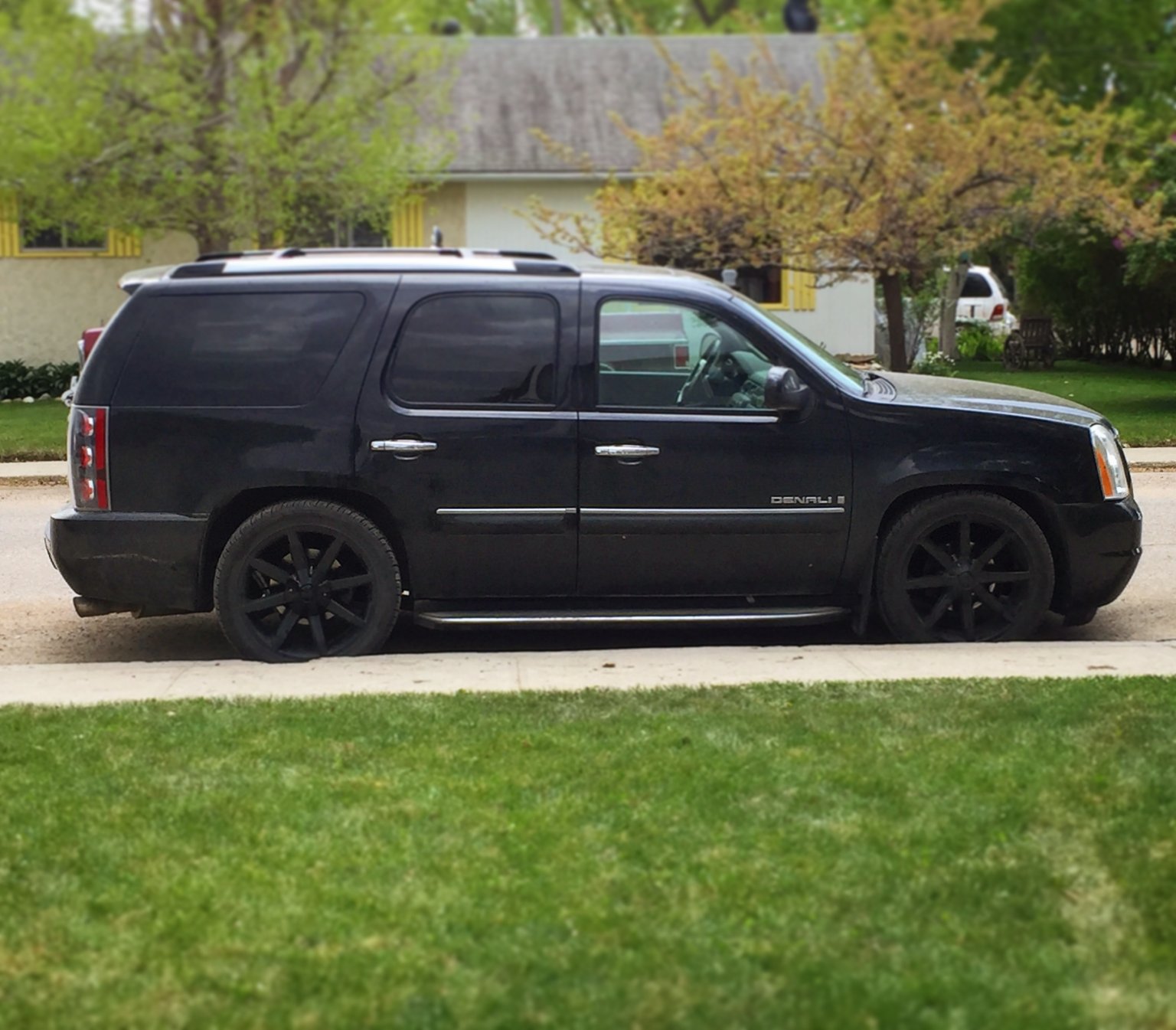

i dropped my wife's 08 Denali. Installed Belltech struts, spindles, rear coils and shocks. Total about 4/4".
It had autoride and the rear shocks and compressor went out.
Had no alarms until I put the new shocks in. I've installed the 3.9 25 watt resistors like mentioned in the sticky, but the message won't go away.
I removed the resistors, checked the resistance and they were all good still.
Wired them back in, disconnected the battery and tried again but same thing.
I get service stabilitrac and service traction control.
Anyone else have problems with this?
ive tried height sensors unplugged, compressor fuse pulled, but same thing.
When I pulled the resistor I checked and had 8 volts at the shock/resistor wire.
Any ideas where to go from here?
Thanks.
