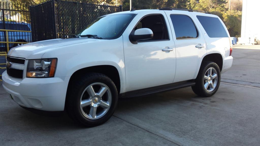

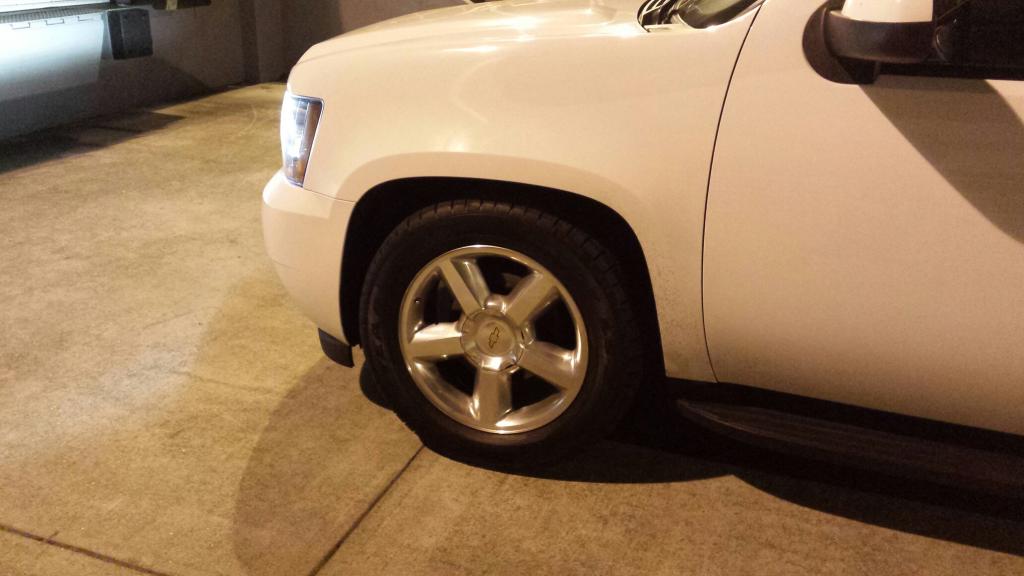

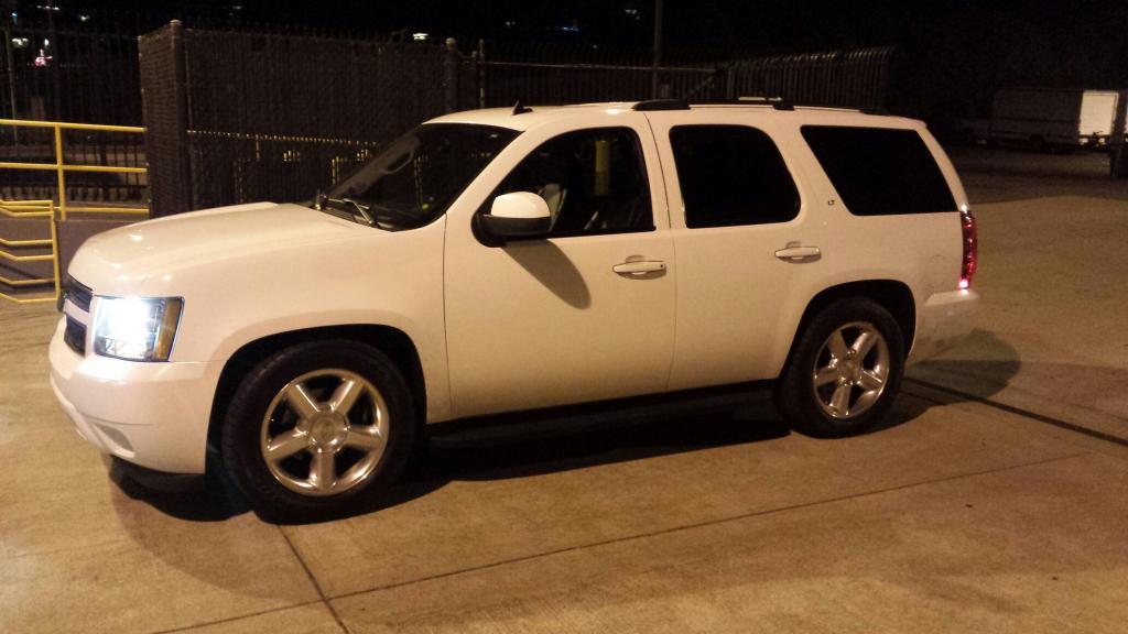

Did 2 trucks today here is one. Ill get better pics tomm once owner sends me more. I told him to drive 500 miles and then bring it back if he wants to pull the spacer for 1 more inch in rear.
275 55 20 tires
BEFORE
Front was 35 7/8 ground to fenderlip
Rear was 38.25 ground to fenderlip
After drop
33 3/8 front and rear 34 7/8 WITH 1 inch spacer in.

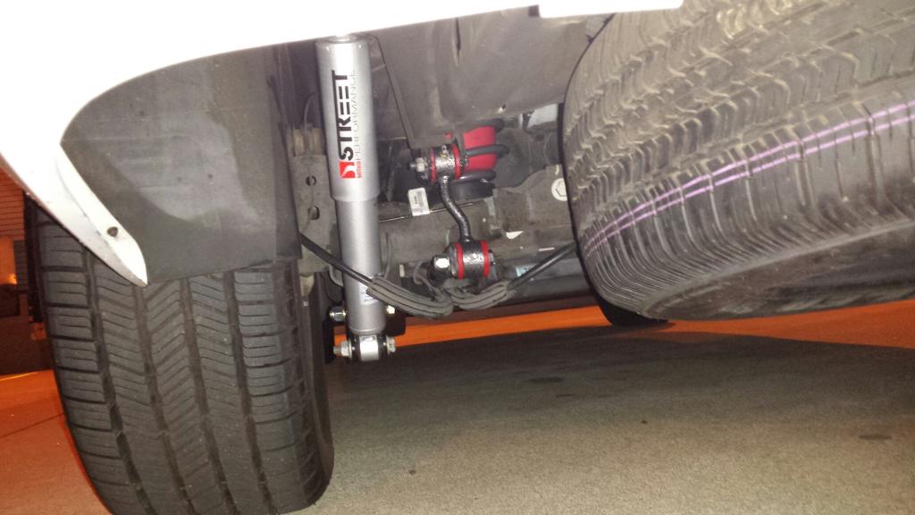

I used this kit and added the rear belltech sp shocks (125 extra)
http://www.tbssowners.com/store/index.php?act=viewProd&productId=106
also used the rear djm endlink kit and relocated the swaybar over
http://www.tbssowners.com/store/index.php?act=viewProd&productId=201
and bumpstops for free travel mod
http://www.tbssowners.com/store/index.php?act=viewProd&productId=212
I also used the airlift helper bags for when he loads it up.
