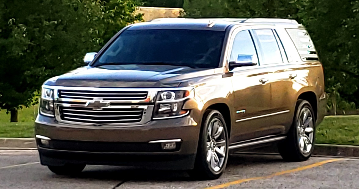

Tony's kit is the BEST way to go. This is at 2.5/3.5.....I'll go another 1" lower in the back soon. 2016 LTZ.
