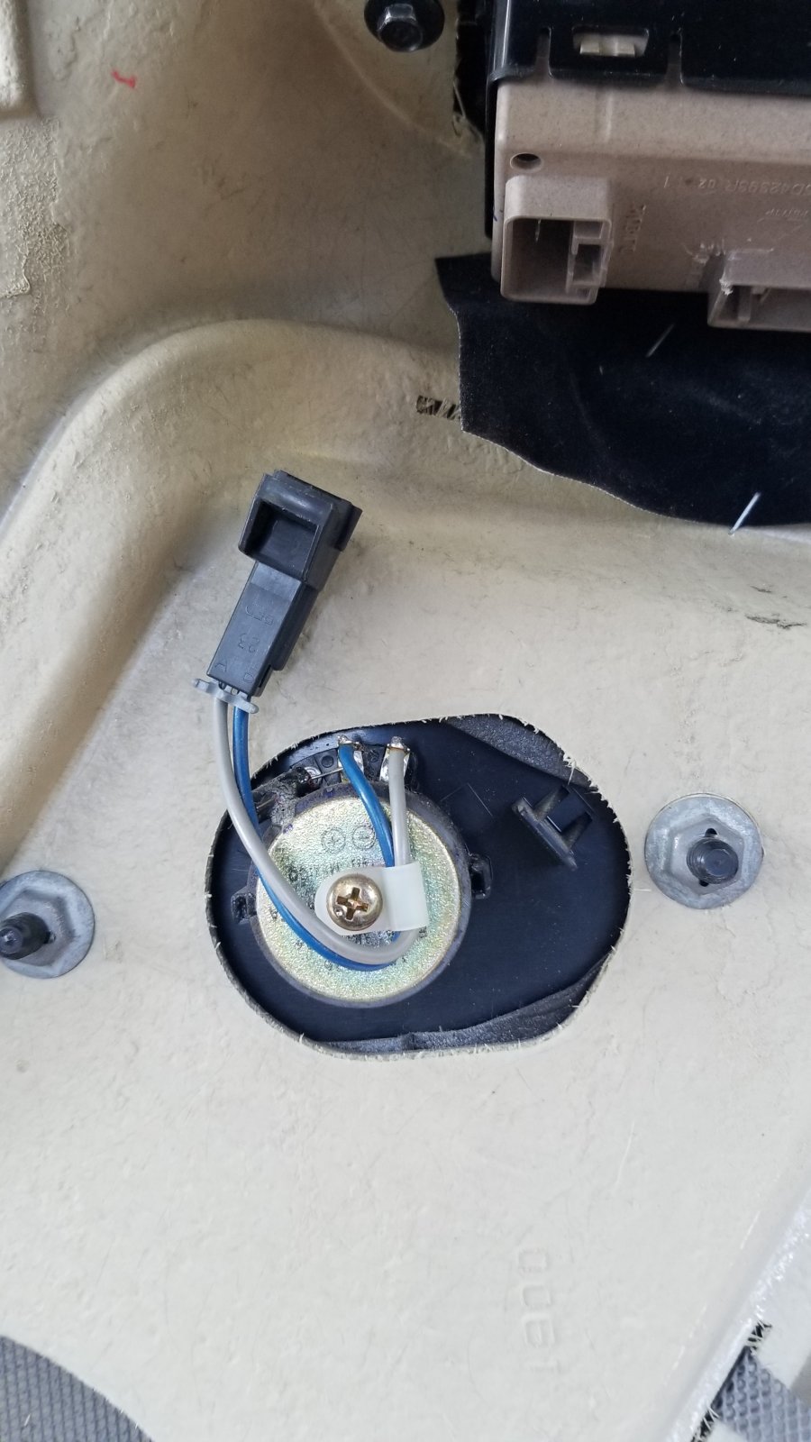

So, yes it has a tweeter. Does the tweeter need to connected in order for the big speaker to work?

With you having the base radio, I am not sure there is the built in cross over for the A-Pilar tweeter. So the question is, why is the speaker there, when you dont have the uplevel audio?? Maybe the assembly line installed the wrong part? Didnt have the correct A-Pilar trim, and they used what they had? Who knows!
You could wire in the tweeter, but you will change the power draw, and ohm of the line for the radio, and since the crossover isnt there, the tweeter would also be trying to play all the tones that its not designed for.
Leave it out would be my suggestion.
Dont forget, you can also replace the speaker MUCH cheaper thru eBay, Craigslist, Facebook Marketplace, or a local salvage yard.

Thanks! Its not in the pillar, it's just right above the bigger speaker in the door. I thought it odd it's not connected though and was just considering wiring it in too. But, you bring up a good point, may be too much draw. I didn't miss it before. Just ordered two speakers from RA. The other one was starting to come apart. I thought about just getting a couple aftermarket speakers and mounting them but the wifey wants to keep it stock since it sounded good before. Here's a shot of the unit.
