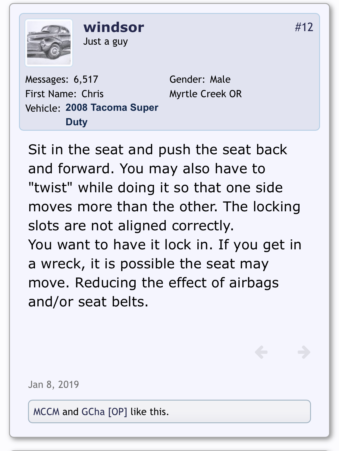

I just did a quick online search and a bunch of folks from various manufacturers have the same issue, so you’re definitely not alone.
One solution that came up was to adjust the seat back and forth fully multiple times.
Here’s another solution:
