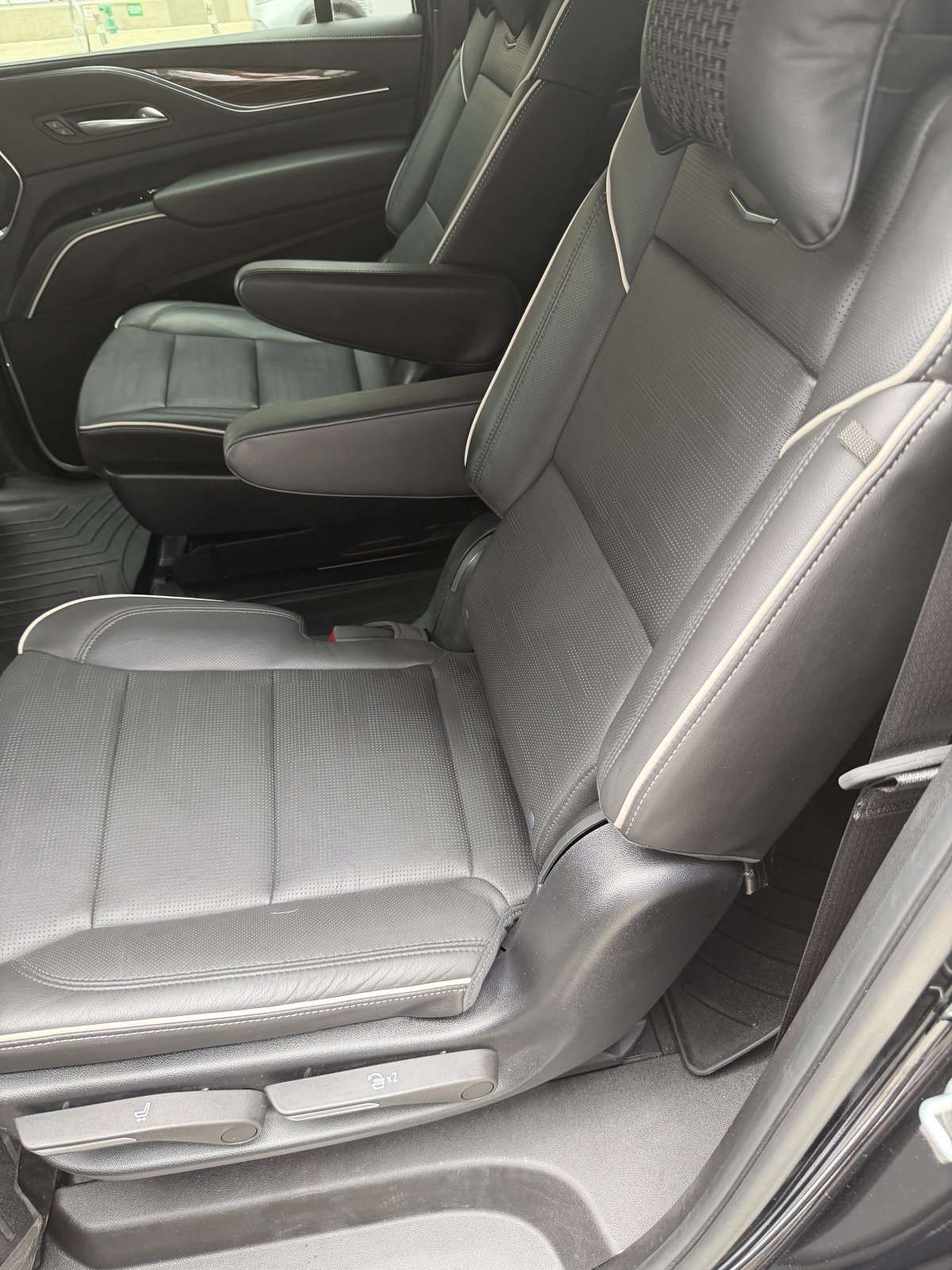

Good afternoon everyone. So I have a 2024 Escalade Esv I bought brand new in October 24. And ever since I bought it, the second row seats would rattle over bumps and rough roads. The dealer changed both seat frames, but the one on the driver's side continues to rattle. Has anyone on here ever had this issue? Please I need help. This rattling is just driving me up the wall. I paid too much money for this truck to be dealing with this nonsense. The first photo is when it rattles. No rattles with the next two photos. I hope I make sense lol. Thanks guys and all the best.

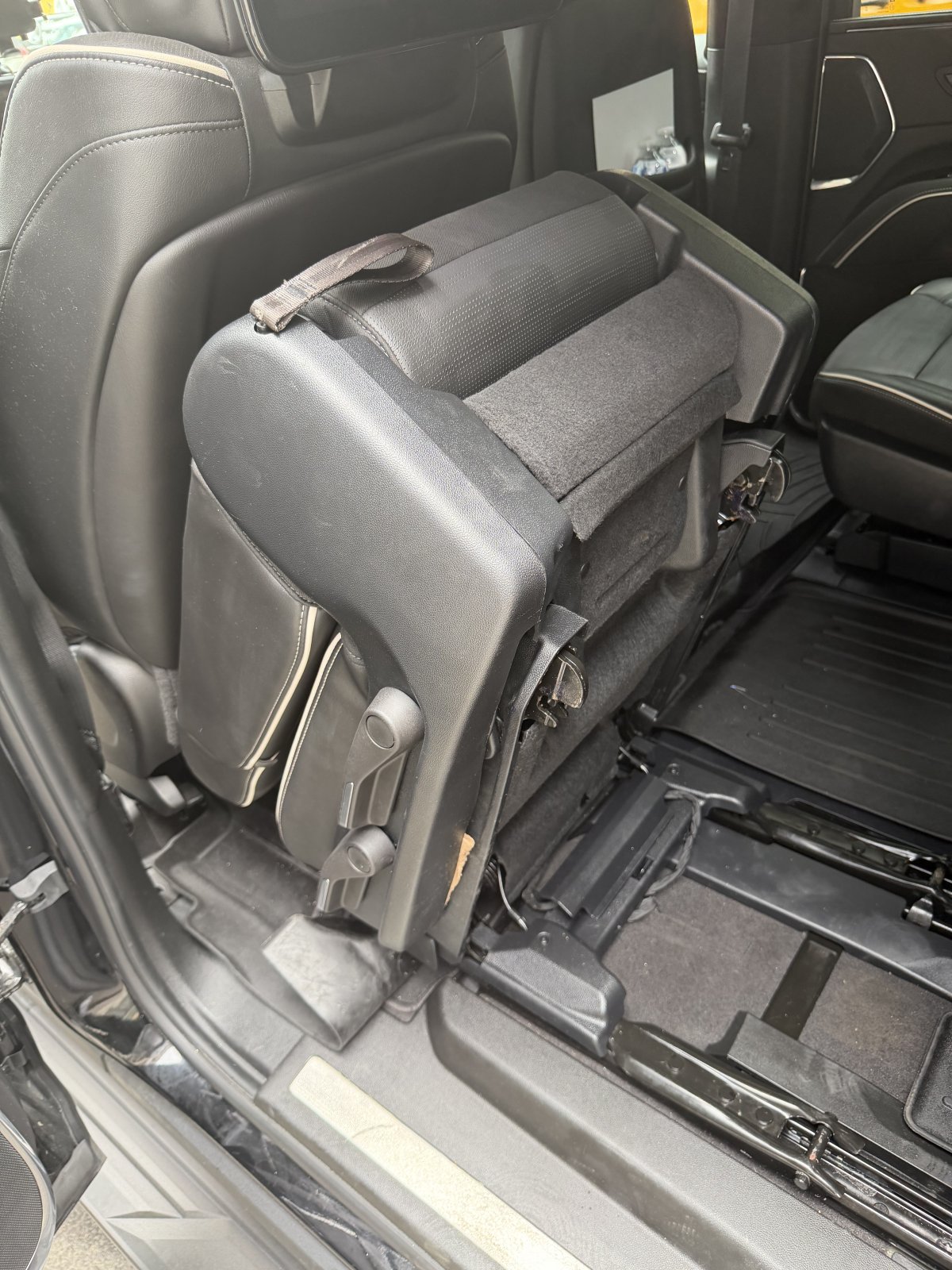

My drivers side second row seat issue is a clanking sound over bumps vs a rattle. If you take two hands and shake the top of the seat you can replicate it. And if sit sideways on it and do that you can see the back part is loose in the tracks. It is significantly worse when someone is in the seat vs not. The issue on the other side was a rattle that I couldn’t pinpoint inside which ended up being the heat shield. I’m just glad I’ve figured out the causes and now just need them to fix vs needing them to be able to replicate.

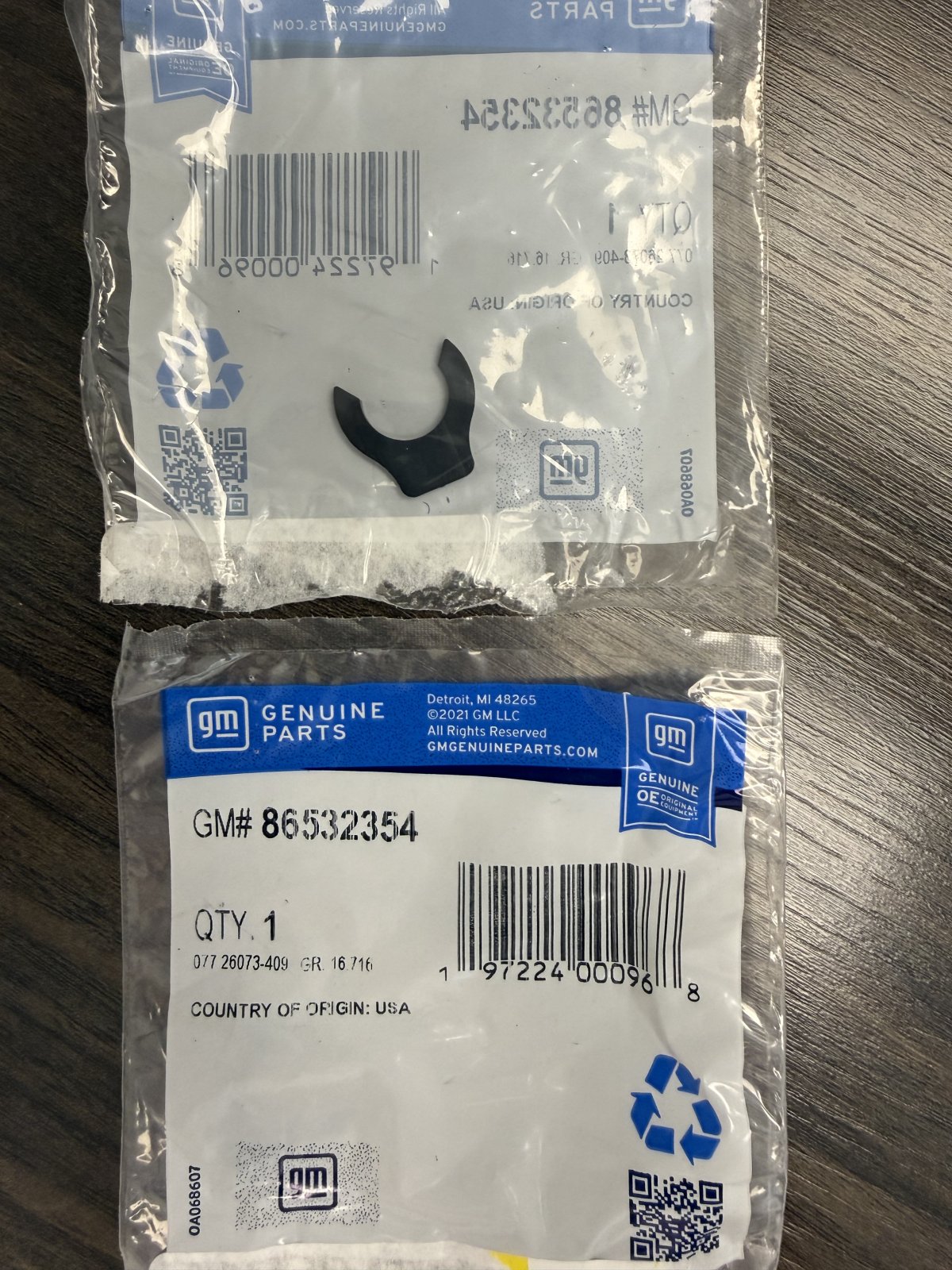

@cmatt
Thanks for posting the pictures of the shims. I originally thought this may be my problem, but when I looked at my seats, some of these shims were installed during the seat frame assembly and what I found was there did not seem to be play in the hinge area, so I skipped this as a possible problem.
I will try to slide under the truck to look at the heat shield because it is probably easiest thing to check and rule in or out, then I will move on to the frame to body/cross mount which takes a bit more effort to inspect.

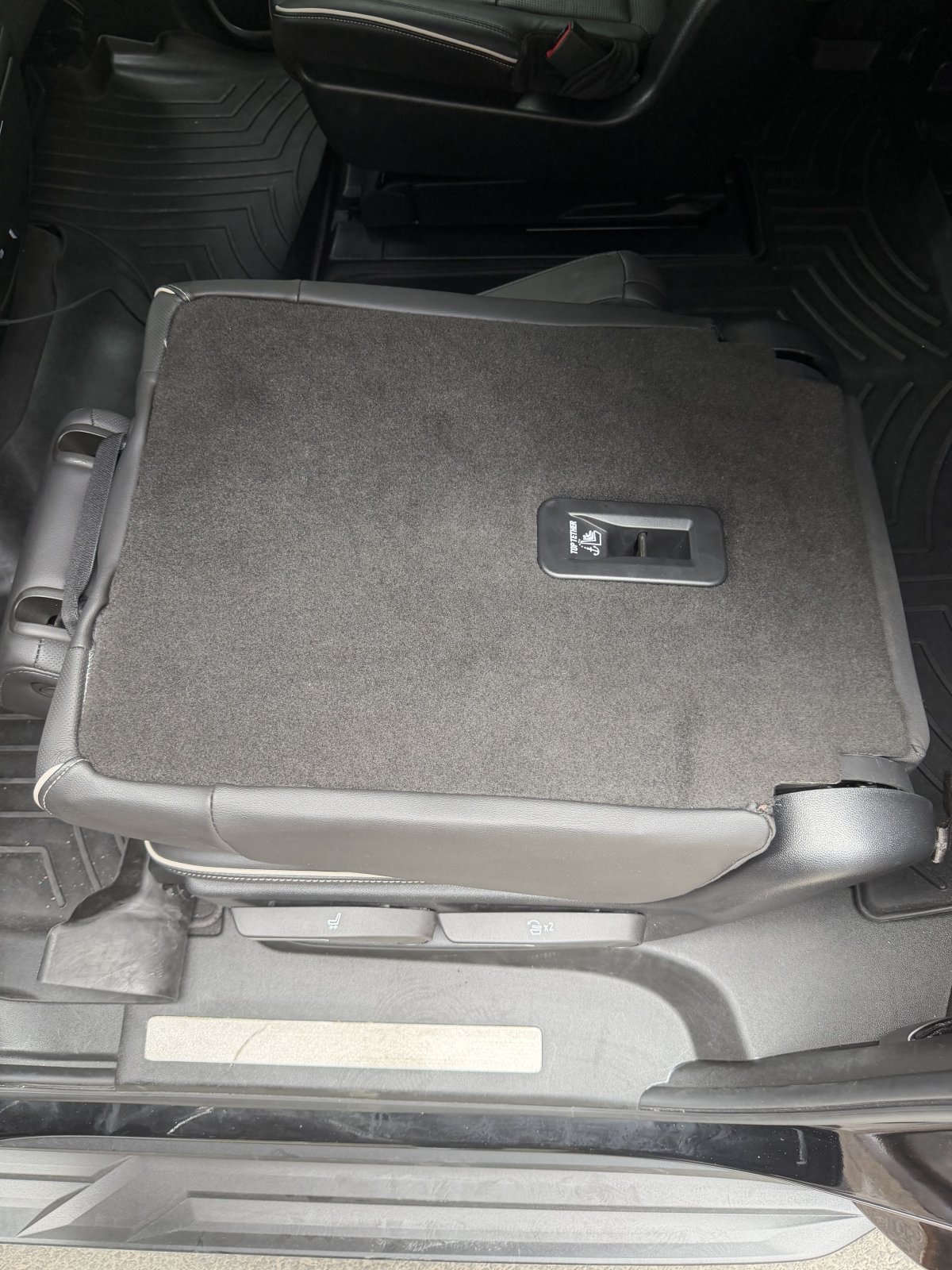

Seems that these 2nd row seat noise problems are probably fairly common. I have lived with mine making noise since day 1, almost 18 months, but a solution is if nobody is sitting in the seat it to just fold it flat. Just annoying and I need to get around to solving the problem. Not going to the dealer for this issue.
