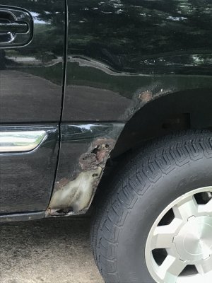

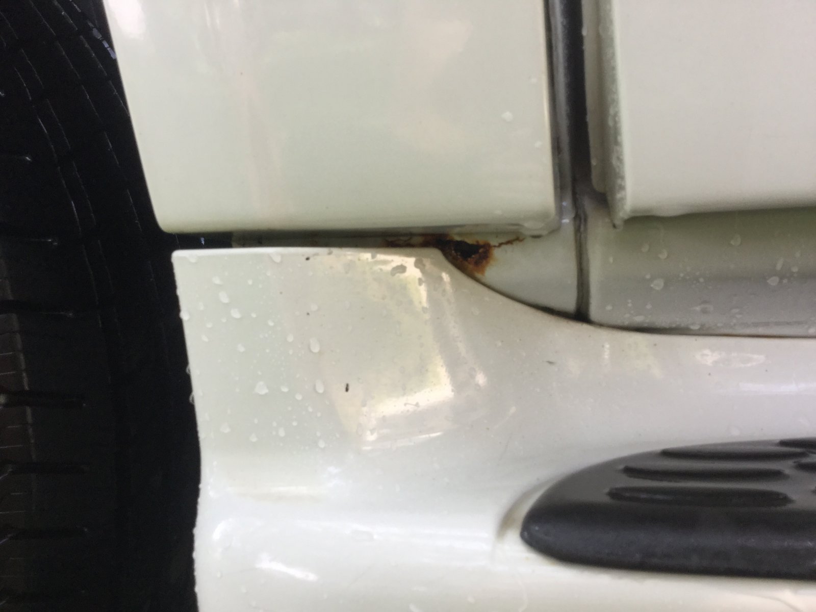

I was washing the White 2004 Denali today and noticed rust behind the back passenger side step
Is there a way to remove the plastic and do a diy repair?

Fender flares are held on by a mix of push clips in the fender and molding tape
Thanks what about the side step? What is the best way to repair the rusted metal under the flare and step. I just want to slow the rusting process

Rust is called cancer for a reason. Even if u cut it out and weld a new piece in and paint in acouple years the rust will be back. That’s why no one will ever warranty rust work.

Thanks guys. I don’t understand he cancer thing. How can it come back if it is completely cut out? If that’s the case is it even worth it to try to fix it?
If I cut the damage out and weld or bondo will it at least slow the progression? Is there any paint rust converter or process that slows it down?
Is there a difference between surface rust, rust and cancer rust?
Is here a web site that explains the science behind this? I would love to understand.
I want to fix it but slowing it down will help.

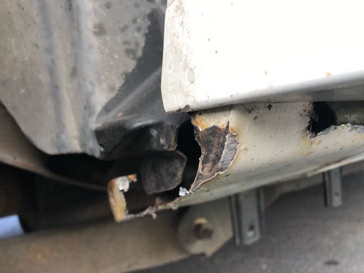

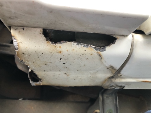

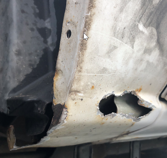

Started grinding and so far it’s better than I expected.
Two views and the crap that was in there

Remove the quarter trim , get a pack panel , cut it the for the area you need. Cut off the rusty shit off , if the inner metal is good treat with some kind of rust inhibitor , weld new piece in , bodywork , paint.

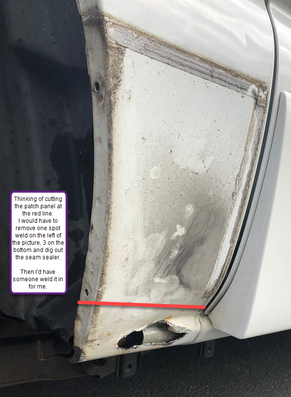

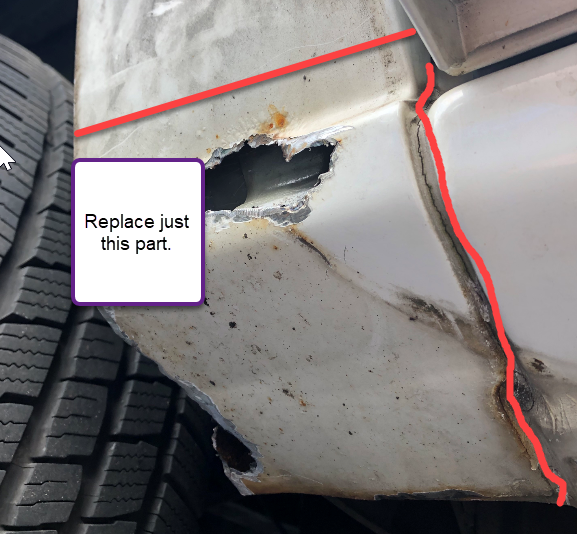

I thinking of buying a patch panel and cutting it at the area indicated in the picture below.
I don't weld so I'm hoping to pay a friend. Would this be a tough weld job?
I will take out one pinch weld in in the back (left on the picture) 3 underneath and I remove the seam sealer. Cut and remove the highlighted part. Cut the replacement part. Remove, Neutralize all rust. Prime with weldable primer.

Dealing with rust is like dealing with an iceberg. You can only see 10% of it.
I would buy as big of a patch panel that you can and assume you will use it all and then hope that you can cut back to clean metal sooner rather then later.
Another thought was to use rivets and panel bond since it is under the trim panel?
Thoughts?
If you go this route, I think you will be coming back in a year or two and have a bigger area to deal with since moisture will get behind your riveted joint no matter how well you seal it and wreck havoc.

The patch panel is ordered and a friend said they will weld. I’ll post updates as I go along. I’m a bit slow so it will be a couple weeks. Thanks for the help.
If I can get through a couple years I’d be happy. Rockers looked really good. Just a bit starting at the edge of the pinch weld. I’ll keep them fluid filmed
