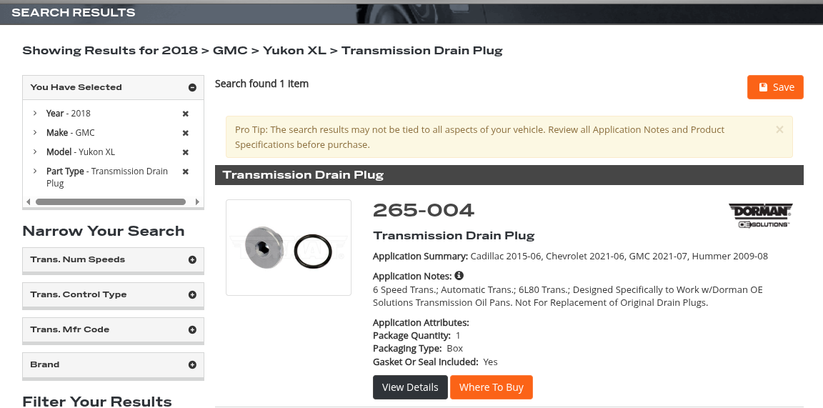

Here's the drain plug and gasket, specific to that pan. Not sure if it's even available, or if just the gasket would be available separately. I'd size the gasket (seems to be an o-ring) before installing and find a match at, say, NAPA, for a spare. And keep the number for the spare.

OR VietVet
GMT800 2005 Tahoe Z71
Navy Supporting Member
Oct 8, 2014
23,903
44,594
Willamette Valley
My point exactly. Thanks for doing the legwork.
