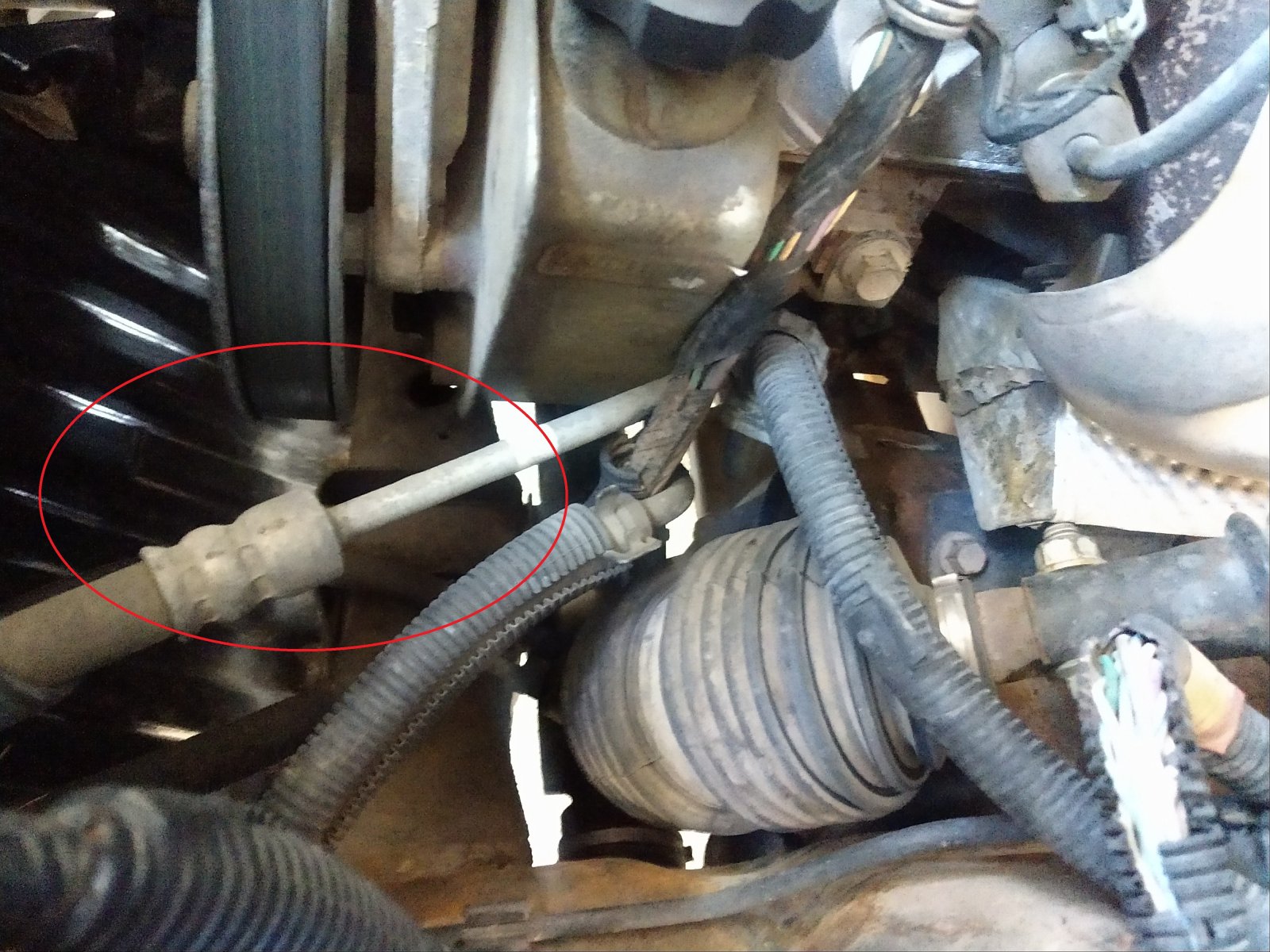

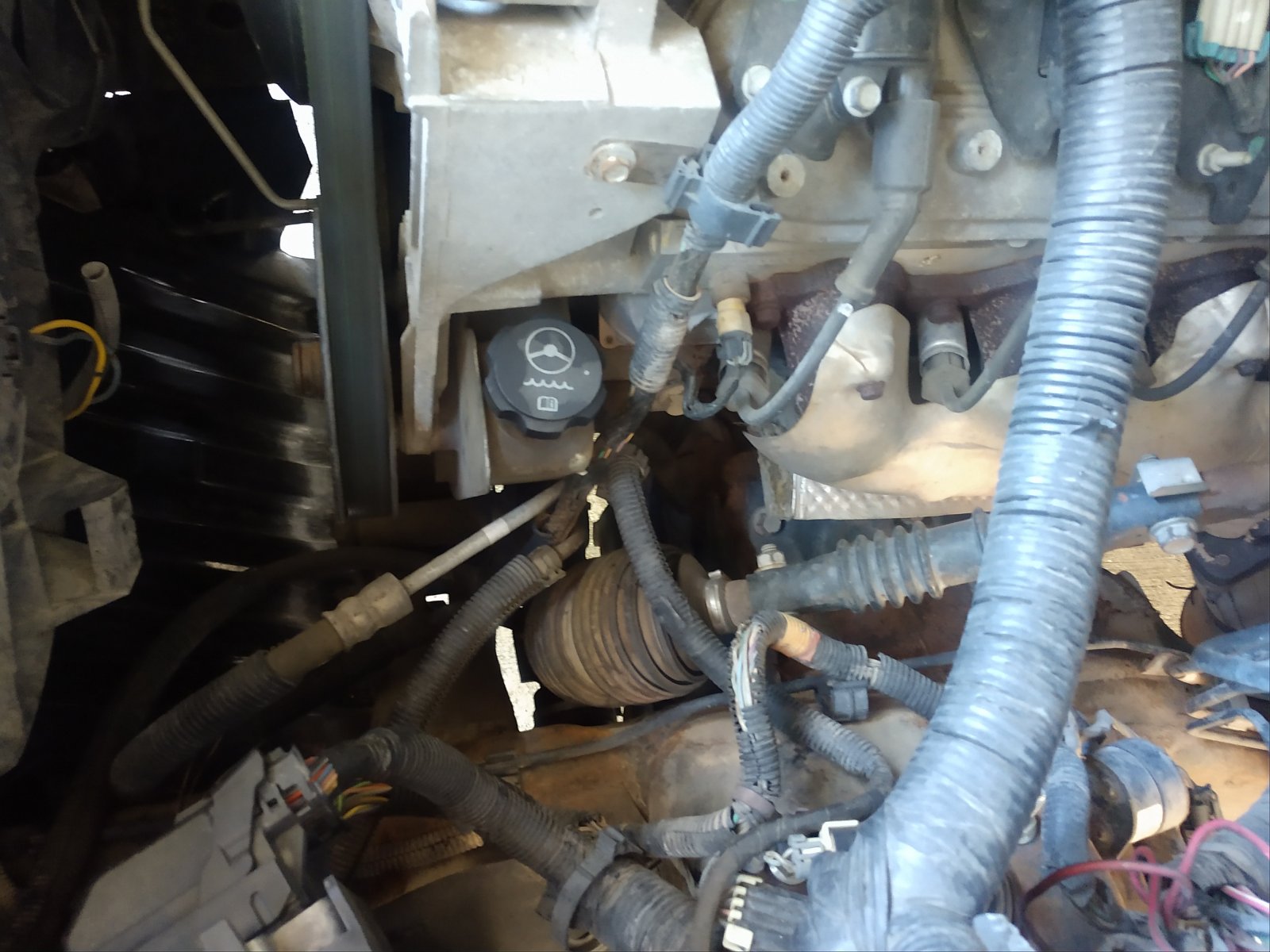

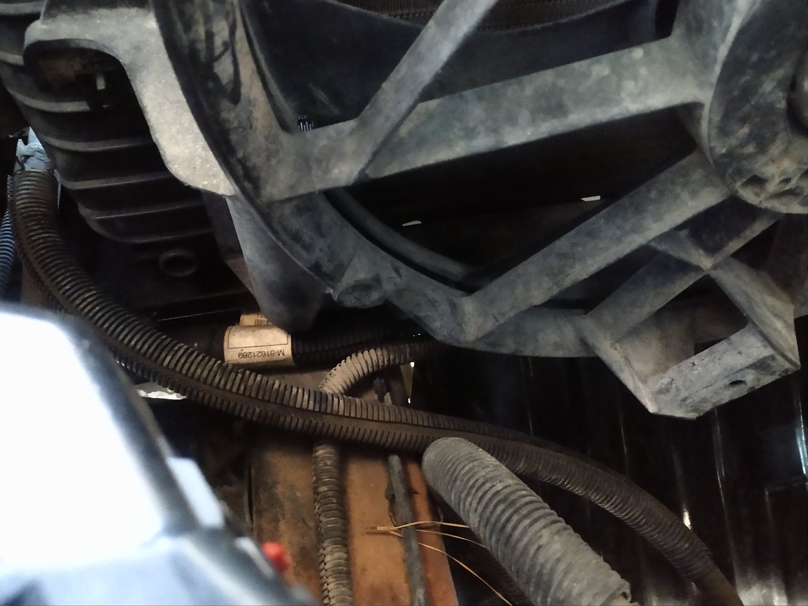

I need a new radiator and want to confirm if my radiator has the oil cooler option before I order the wrong part. I opened my hood and took some photos of the driver side.
I circled a line that I think may be an oil cooler line.

those lines are for the power steering cooler which is a separate piece, not part of the radiator, it does look like it might have the option for it on the radiator end cap but the fittings are not there and if there is no plug in it then it's likely contaminated anyway. you can add a oil cooler if so desired with a adapter plate, 2 lines and a radiator
*also if the radiator does have a oil cooler it doesn't matter, that part just isn't used if you do not have the lines for it.

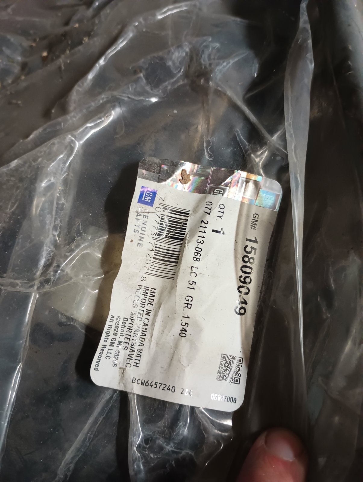

I rebuilt the LQ4 engine on my 06 Suburban 2500 a few months ago. The engine oil cooler lines had started to seep. When I reinstalled the engine I had a block-off plate and temporarily installed that just to get the truck running again. Well, I've been driving the truck for 7 months like that, lol. I bought new GM Genuine bought cooler lines, just haven't had time to install them.
@Doubeleive the adapter plate is part of the oil cooler lines assembly, no?

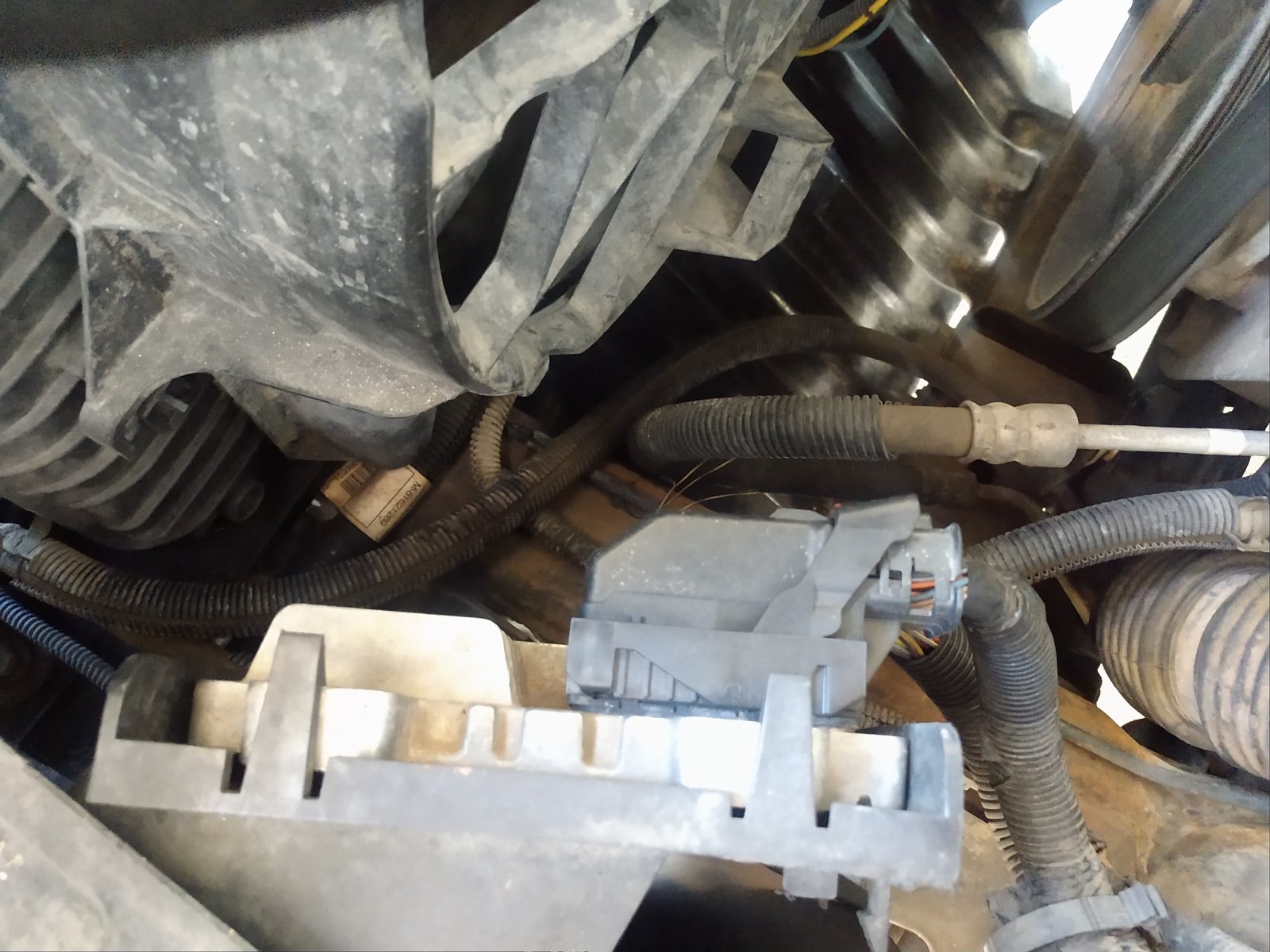

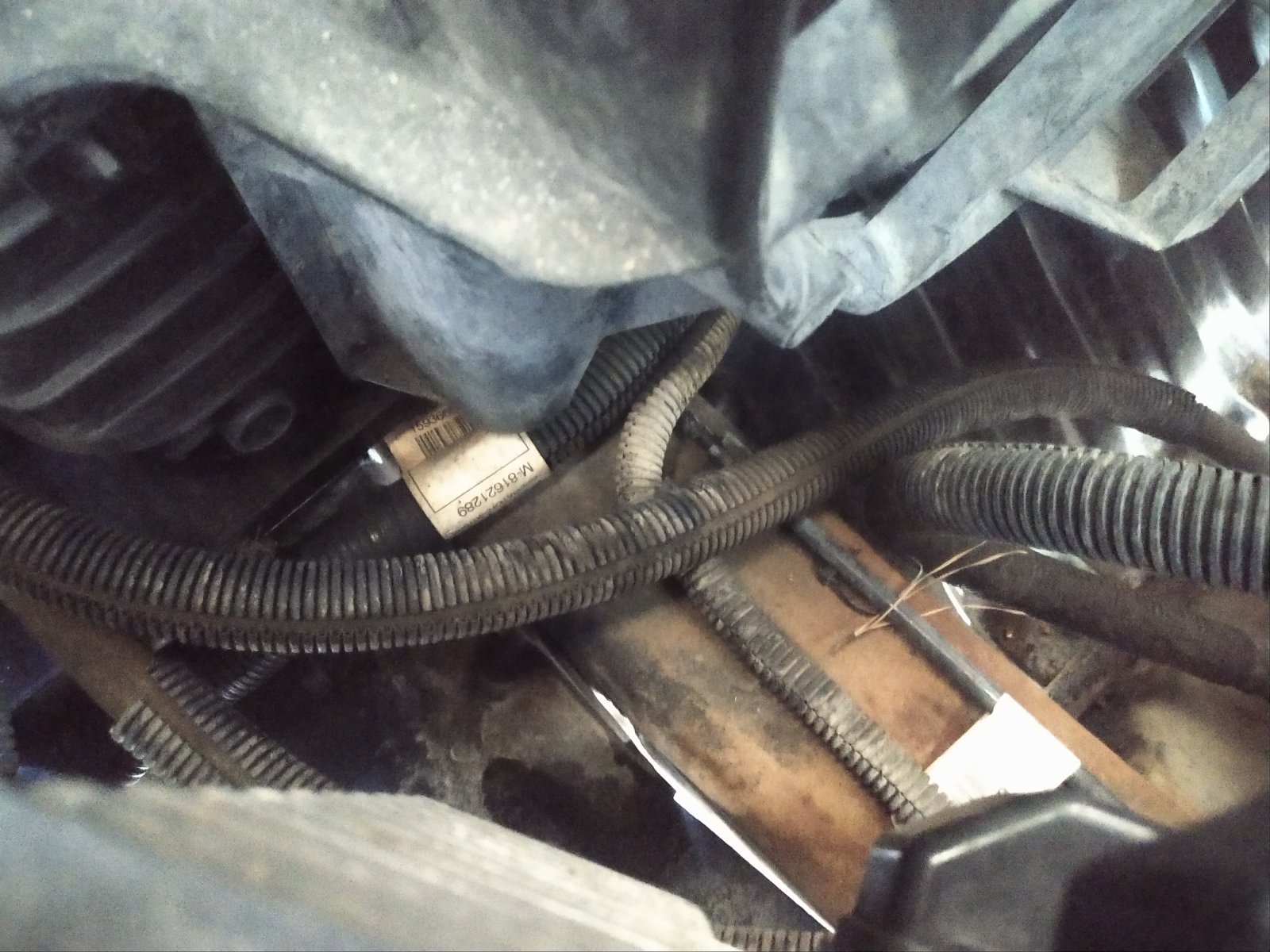

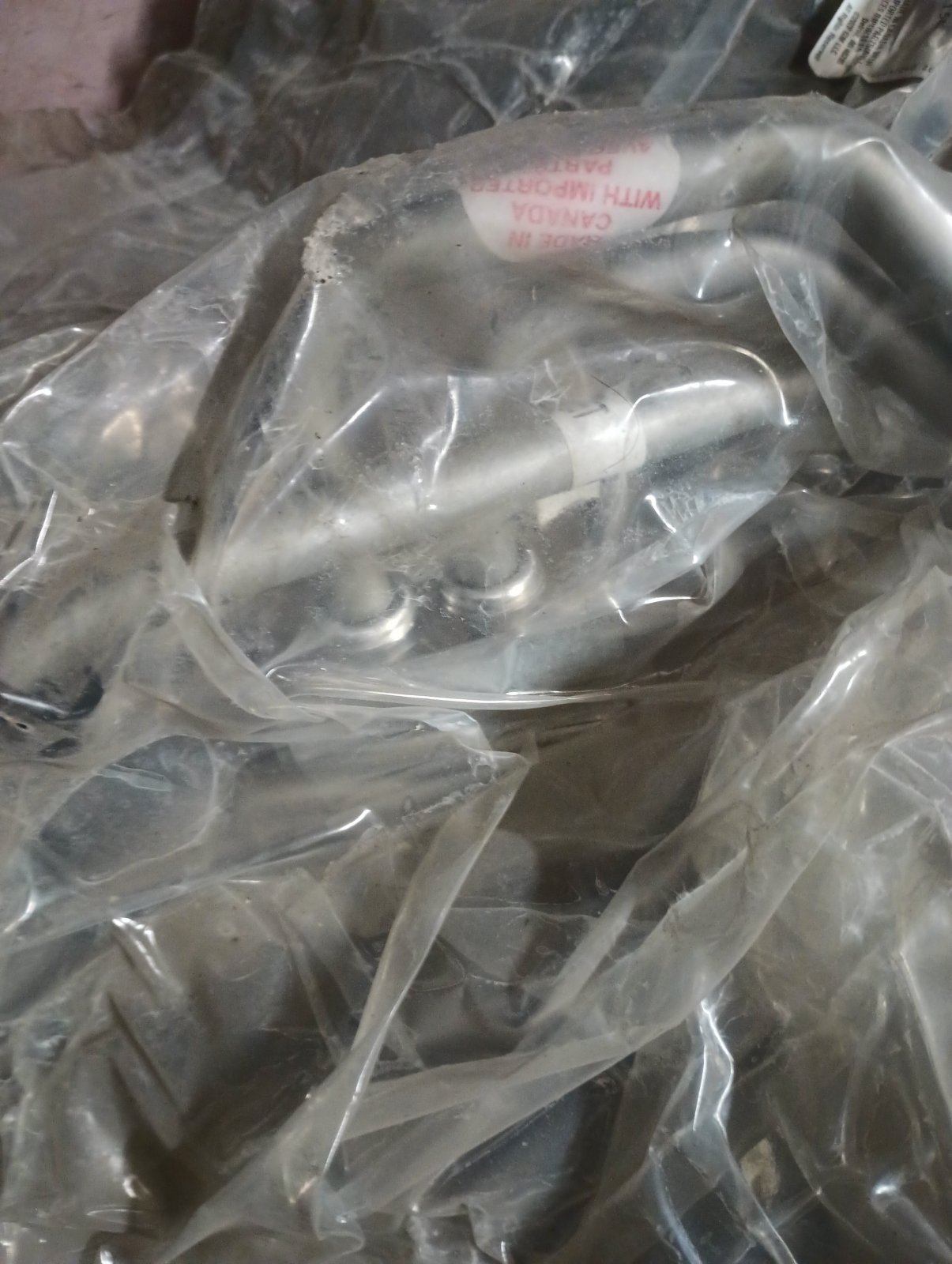

I ordered one before. The plate/block is part of the lines. The gasket and a bolt? are included too..
Yeah. I'm looking at the cooler lines (or whatever they are called?) and I see the same thing: gasket and even bolts are included.
I really should get these installed just to get them out of my garage TBH.
