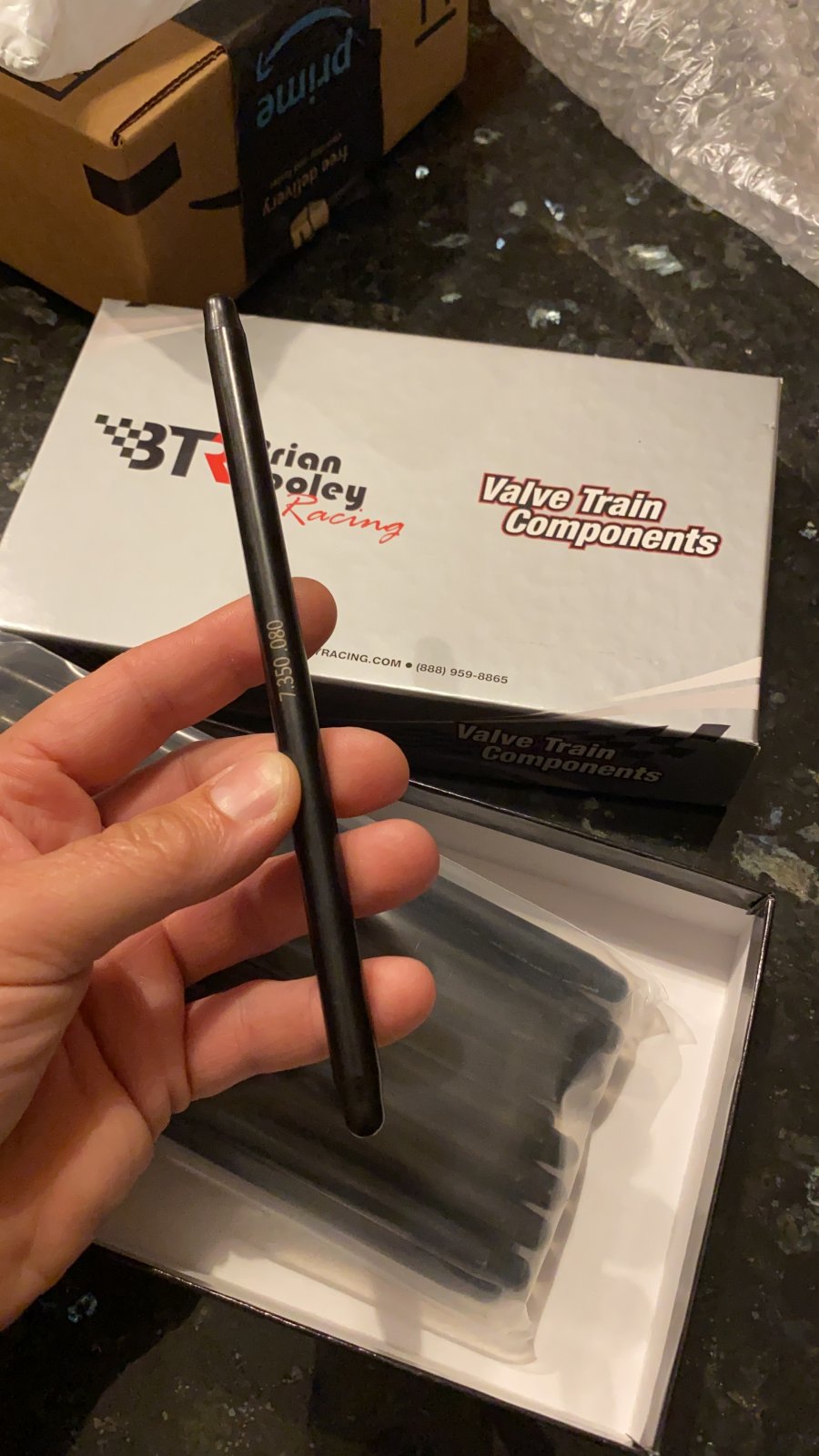

Can the push rods be replaced with stronger aftermarket ones? Mine's an archaic 4th gen, but I got some .080" wall push rods in the largest diameter that'd fit (3/8") for mine when I needed some custom-length ones for my build. I did this just because the stock ones in the 3rd- and 4th-gen engines are a known weak link, even in a stock engine.

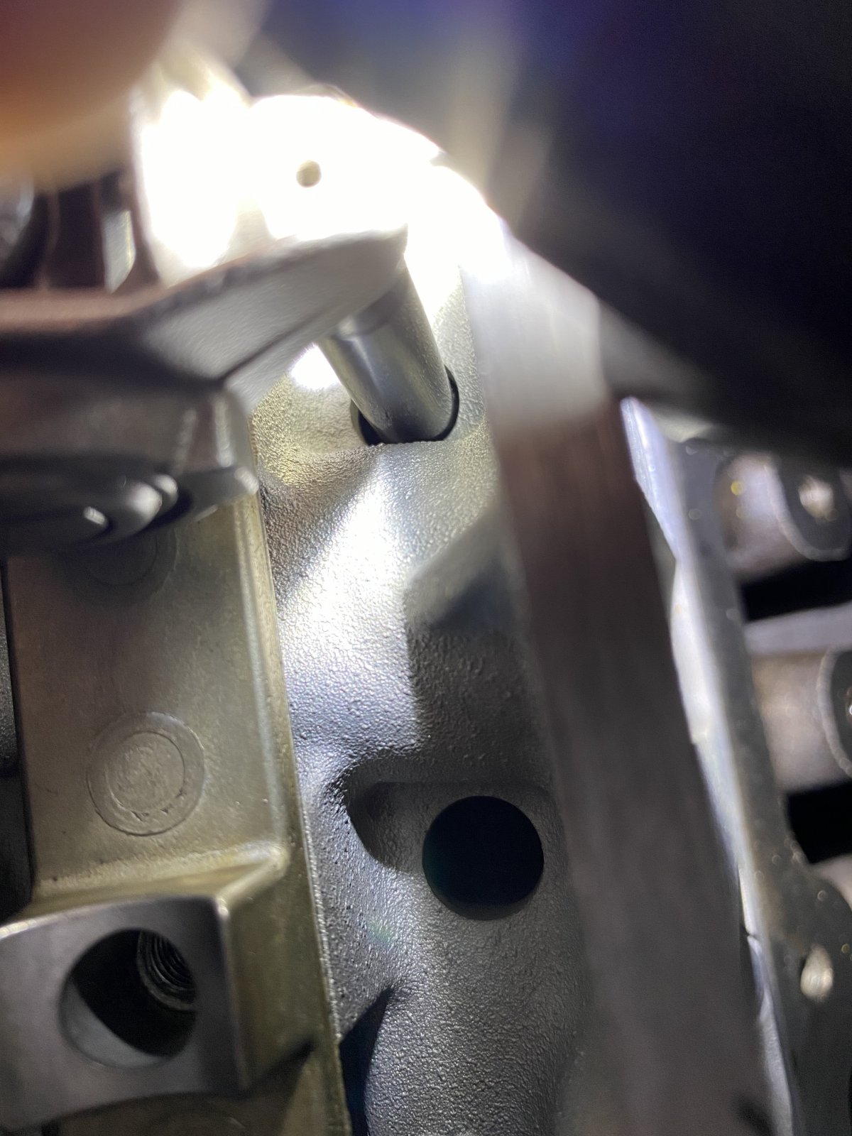

That is not much clearance on that pushrod——
It's not. But, it shouldn't flex. Not with .080" chromoly wall and my mild cam.
I still need/want to upgrade the trunnion bearings. When I have the rocker covers off, I'll inspect the push rods to see it they've been contacting. I might pop a cover off at the next oil change.
45,016
There is no pushrod that doesn't flex some. If you had high speed cameras you would be amazed the amount of deflection at 6,000 rpm.
I meant flex enough to contact. Regardless, you're right and it's still something I should check sooner than later. It sees 6000 RPM almost every time I drive it.

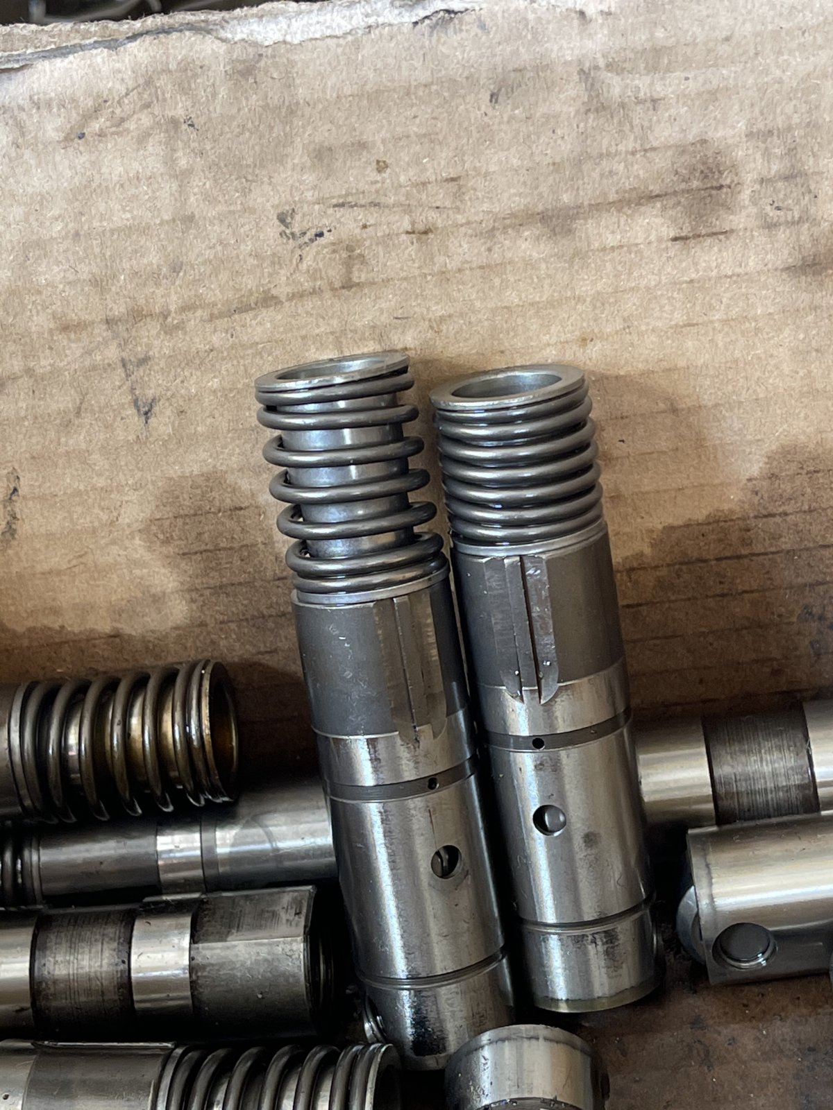

Here is what my lifter did … it Stuck in DOD…. Dead on Demand…. A Texas speed Dod removal kit… Cam and lifters and plugs for the Dod. AND a Dyno Tune Emm reprogram !!! See 24 mpg at 67 now.
