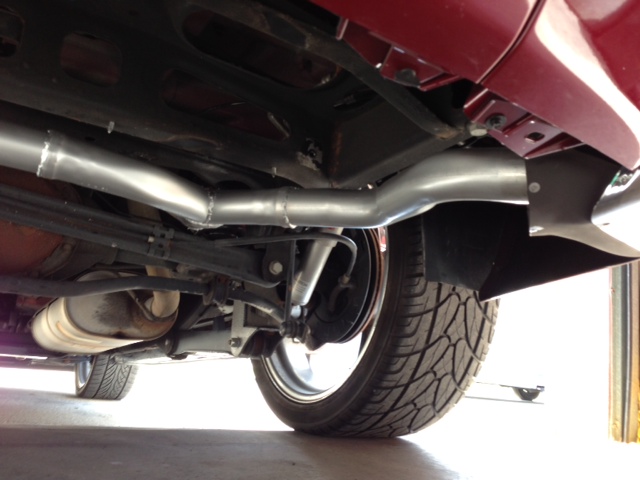

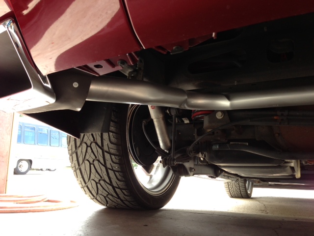

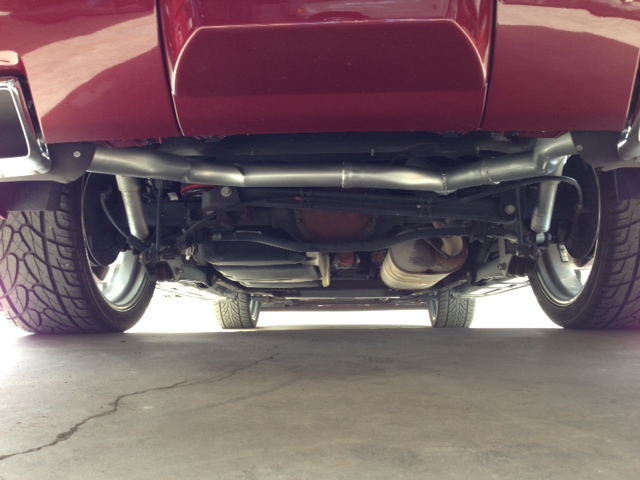

Has anyone here used Belltech shock extenders along with DJM rear hardware kit i.e. the trailing arm bracket? Can I sandwich the shock extender between the trailing arm bracket or modify the shock extender by cutting it shorter and drilling a new center hole? Any help would be appreciated!
45,012
This is on a NNBS, but I think it's similar enough for you to get an idea. If you can't tell from the pics, maybe PM @NathanJax for a better pic?
33-jpg.136569
44-jpg.136570
55-jpg.136571
no you cannot do this. You need the djm shock extenders which i sell with my kits. pm me i have 32 shock extenders in stock
