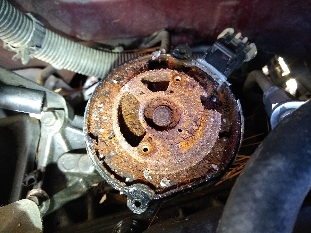

Hey everyone. I've got a 99' Tahoe with the 5.7 vortec. The truck has 127,000 miles and is lucky to see 1,000 miles a year these days. Overall, it is in good mechanical shape, but obviously does suffer some from the lack of use. Years ago, when the truck was maybe 3 years old, we had a major hail storm and I had the hood replaced as it was covered by insurance. I had a steel cowl hood put on. I have put maybe 40k miles on the truck since the hood was installed overall, and I have replaced at least 3 distributor caps/rotors because it will start to miss. The inside of the actual distributor looks rusty, and I just don't think this is right. I am starting to think that maybe it is due to the open cowl on this hood and am starting to wonder if I should just go back to a stock hood to help keep the rain water to a minimum. Have any of you had issues with cowl hoods and moisture issues with your distributors? I like the look of the hood, but I'm more concerned(I'm getting older) about dependability and longevity. Does anyone have any words to share about cowl hood problems? I have also learned that I have poor luck with distributor caps other than AC Delco and crossfiring issues. Can anyone else attest to this?
