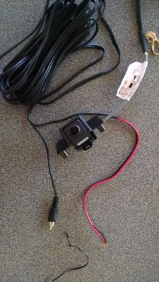

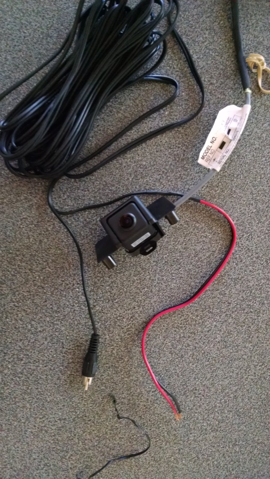

Actually I don't know the GM part number, I would have to look it up. I bought my camera from MVI, it came with the wiring harness and the built in voltage adapter. (The car is 12V, the camera operates on 5V). The wiring harness is one cable, with an RCA plug and a power and ground lead.
I actually paid $249 for it, BUT as I said, it came with the built in voltage converter AND the 'harness'. Might be you can find less expensive ones, BUT, this was plug and play and the guy that sold it to me is very good at supporting it. (the first one I hadd was a DOA, was replaced, no questions asked.)
Besides that, GM OEM is expensive anyway.
I'll attach a pic of what I have, the number is on the label. BTW, I don't think the one that can be directly plugged into the car's harness will work. Someone here tried that (haven't seen/heard from him, I don't think he had any luck making it work). In the dash board,, the harness in an SSV/PPV is way different and doesn't have the wiring for the camera because of the basic radio. To hook up a camera you'd have to provide the (keyed) power and run the RCA cable to the front.

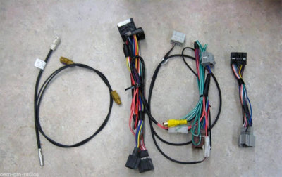

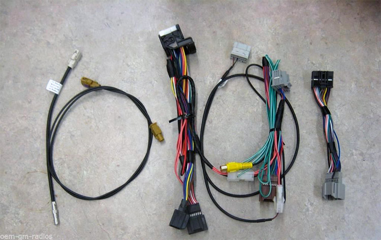

There is a conversion harness, the address I sent you for Matt from "OEM GM Radios", they sell it on their website, I forgot what the item# is but could look it up.
I'll attach a picture of it. If you ever decide to go with the "plug and play amp" that I bought too, the plugs of the conversion harness will connect to the amp harness and the other end of the amp harness will plug in to your NAV head unit. The attached picture is of the conversion harness that I bought, goes in between radio and "dash harness"
