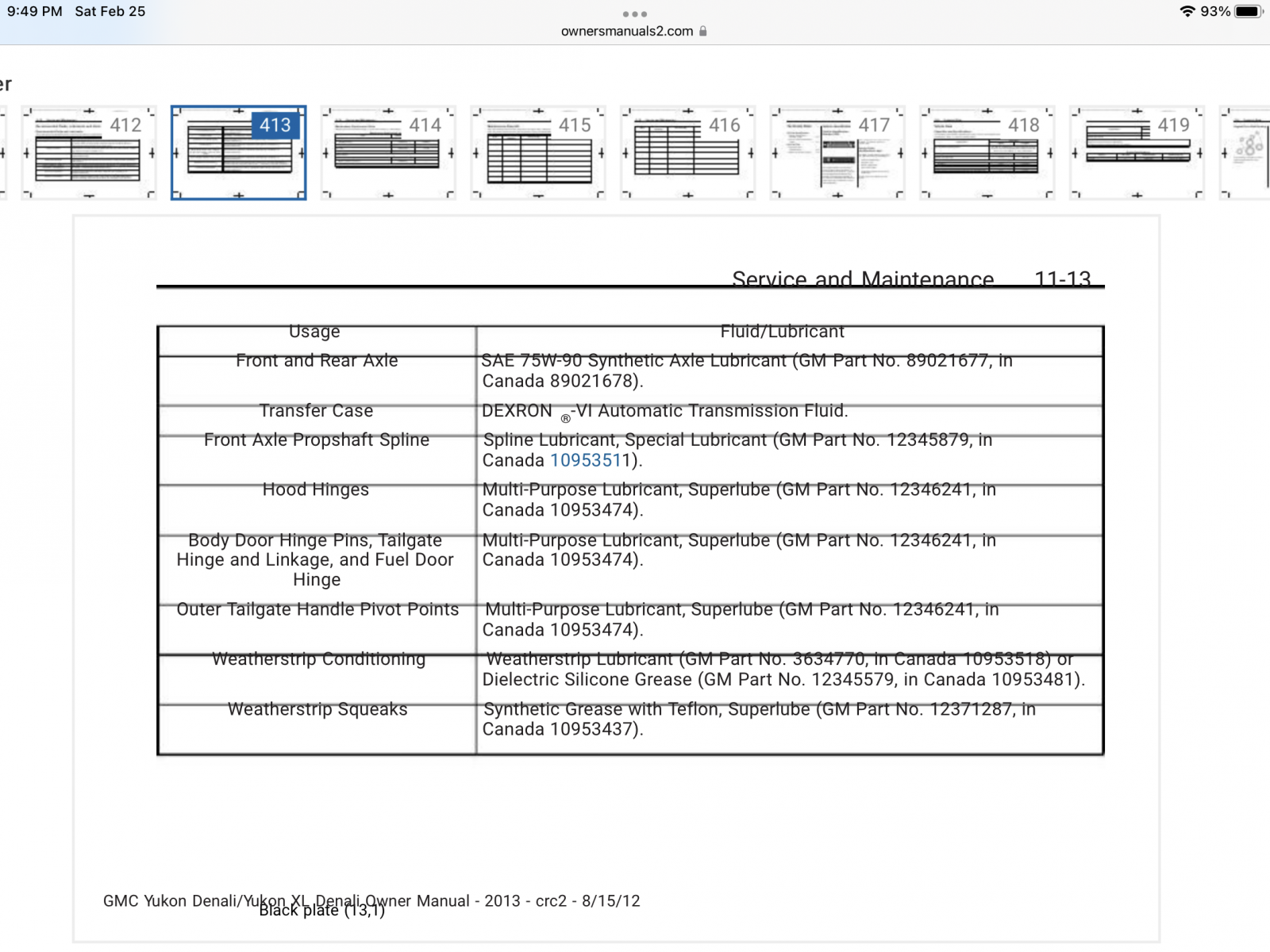

Im going to change the oil in my front and rear diff on my '13 denali AWD. I think im going to use 75/90 synthetic...do i need a limited slip addative?

Welcome to the forum and you have the correct answers. Were you going to use the same fluid for both before @George B set you straight?

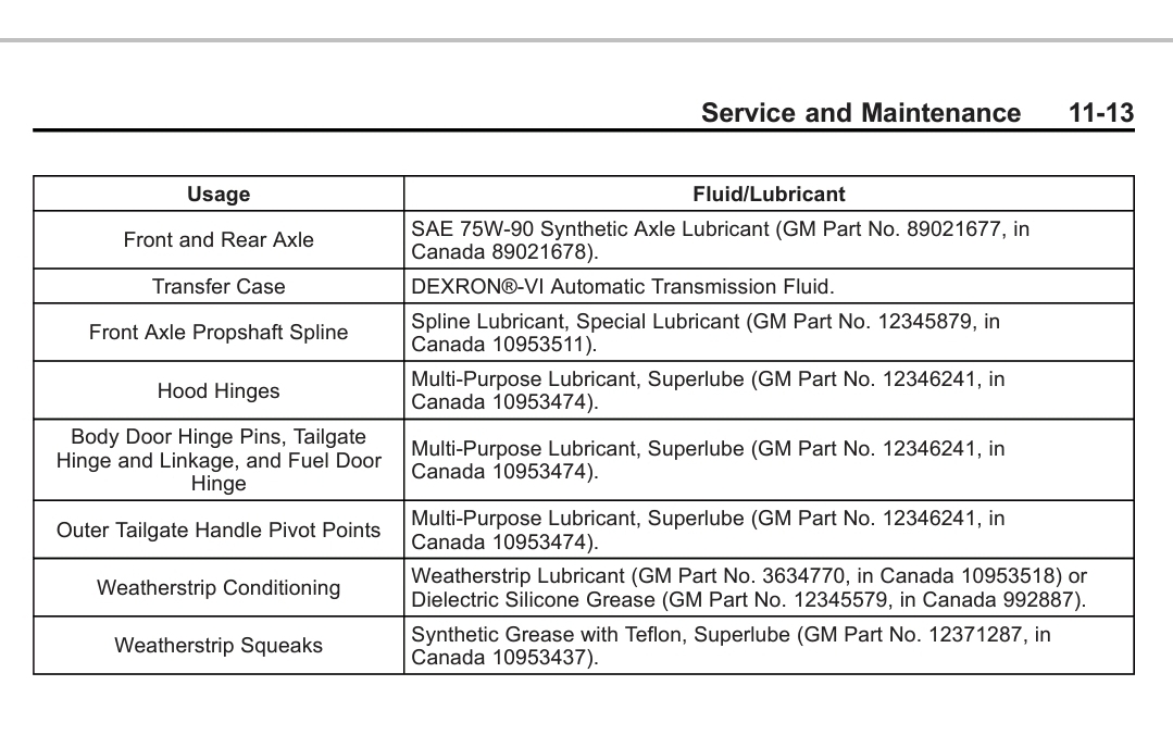

I run Amsoil 75w90 in mine, front and back. It won’t make a bit of difference. Make it easy on yourself. Owners manual confirms for my Denali

Correct, GM has changed the recommendation for the front differential from conventional 80W90 to full synthetic 75W90. This applies to our older trucks as well. Never understood the reasoning for two different fluids, maybe the older spec was quieter?
Limited slip lube in a stock truck G80 causes chattering.

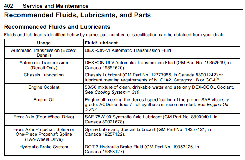

Would you be able to point to written documentation of said change of recommendation?

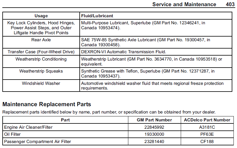

My 2019 Yukon's owners manual calls for 75W-90 in the front and 75W-85 in the rear. Can you use either of these weights in both the front and the rear? Probably!
