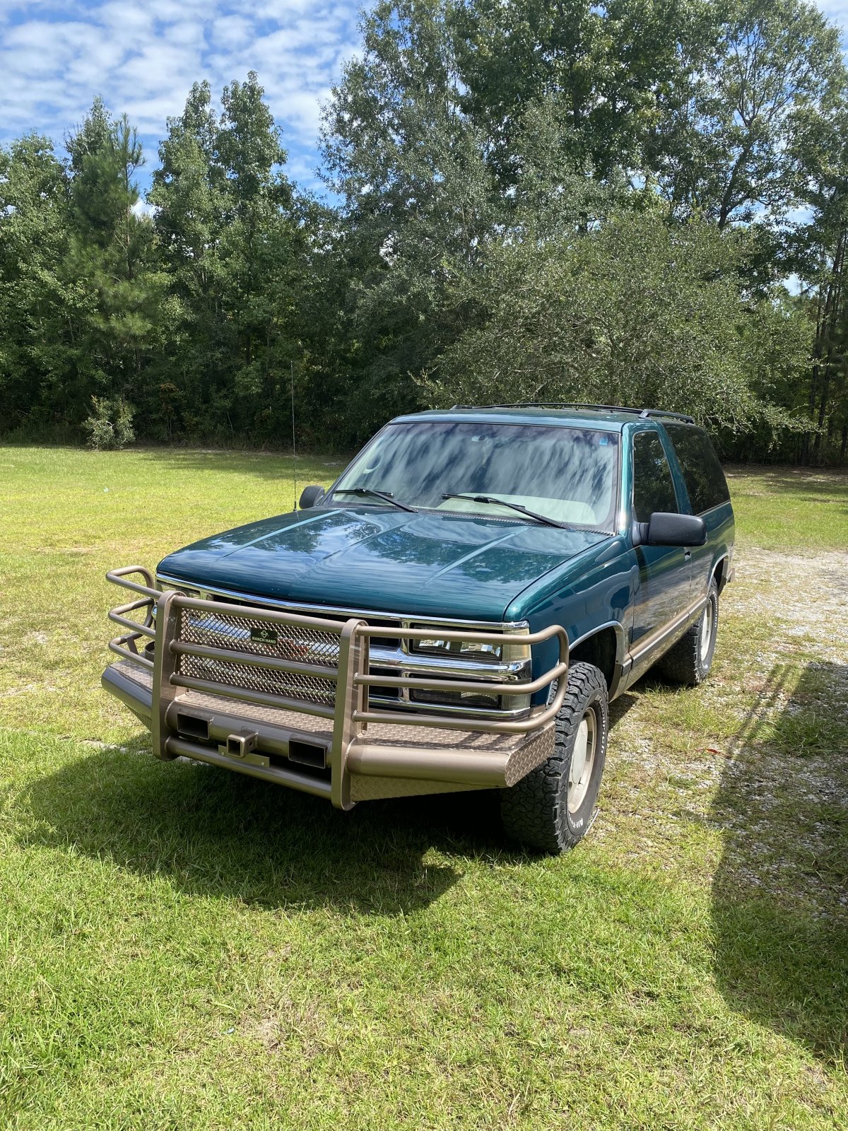

I have a 96 2 door diesel with the 6.5
I have been having issues with it after warm up, it’ll run great for about an hour or so, and when on the throttle, but when I am sitting at a light or just idling, it’ll start hesitating like the fuel is being restricted. I’ve since replaced the lift pump, pmd 3 times, injectors, fuel filter, fuel solenoid, I’m not sure what else to look for to remedy this. Thoughts?
