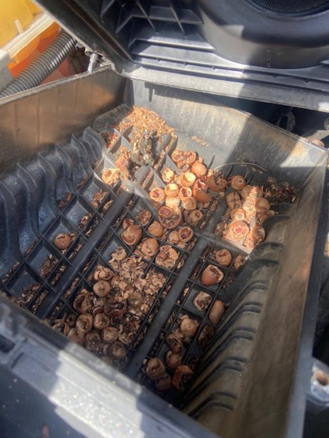

Per the suggestion of Fless to clean the MAF and to confirm the cleanliness of the air filter; I i discovered an IMPRESSIVE size mouse/chipmunk nest in the airbox under the relatively new(less than 10 month) air filter.
I cleaned out the airbox, popped in a new air filter and spray-cleaned the MAF. I just got back from a 90+ MPH rip down the highway. I'm happy to report back that no CEL was tripped during the test ride.
Thank you to all who helped me figure out this annoying issue.
Tbruz
interesting, time for some critter traps around the parking area

I had the same thing with a tractor. Put a piece of 1/4" hardware cloth over the intake. Lets air in, not critters.
But 80+ on a public highway is just not safe.
