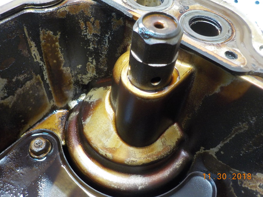

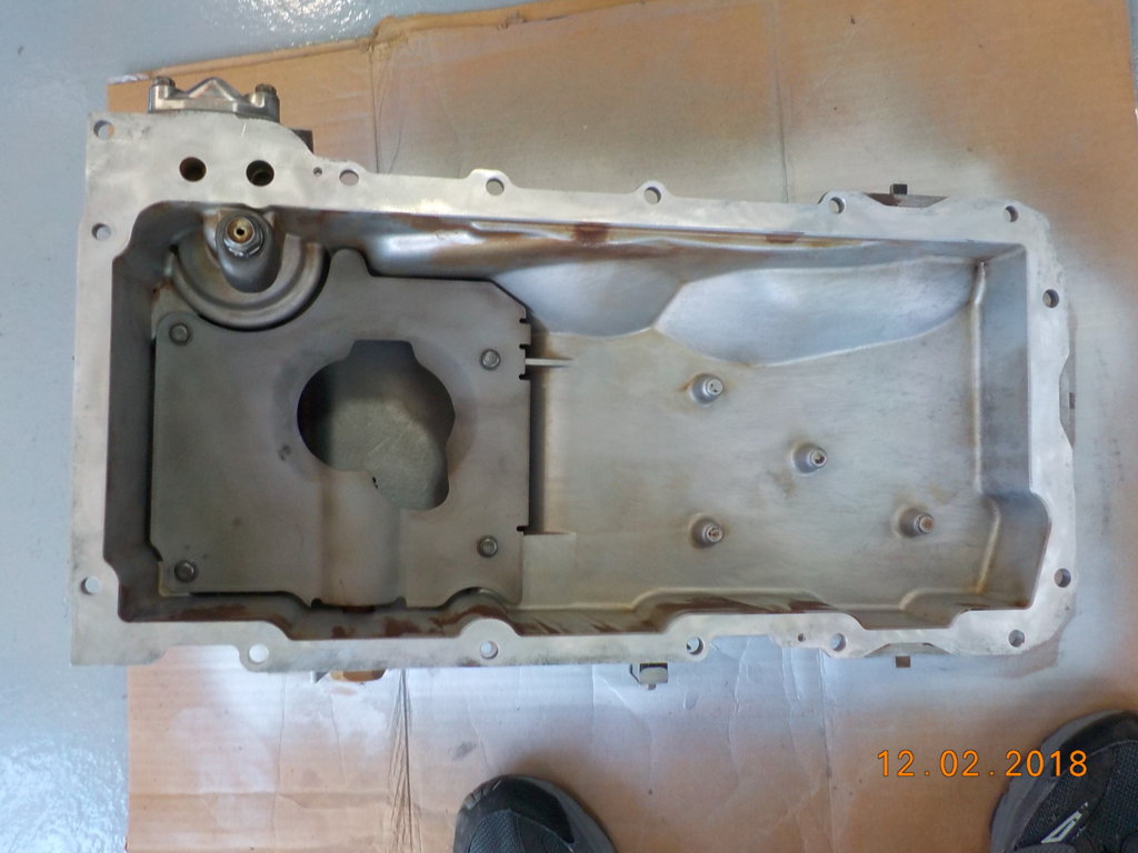

There's an AFM oil pressure relief valve in/on the oil pan:

It makes sense to me that the oil pressure relief valve in the pan is a likely culprit here. It's a pop-off style valve that would cause this behavior if it's intermittently sticking closed. It's not common, but also no unheard of for these to fail in this way.
Does it only operate along with AFM or does it work on it's own? I had AFM tuned out a couple years ago so while all the components are still there, they aren't activating.
Dustin Jackson
Aug 9, 2018
1,788
2,065
I don't know how it works specifically but it is designed to help maintain a specification of oil pressure independent of the AFM system but if it is malfunctioning it could be restricting oil or allowing too much oil to pass and depending on where in the oil pressure system this valve is could cause the gauge to show a non-normal number.
I understand the one in the oil pan is a second oil pressure relief valve and the first one is built into the oil pump, things to keep in mind.
