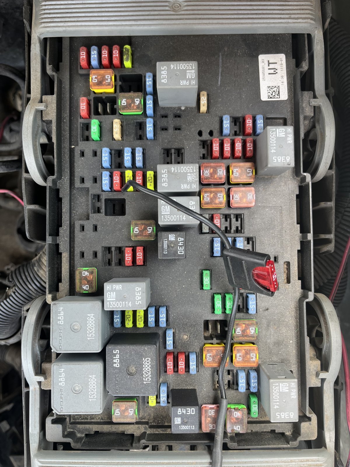

Hey! I have a Derale Hyper-Cool Remote Fluid Coolers with Fan Kits 13960 installed on my 2009 Yukon Xl, 5.3.
I have a question about the trans temperature. When should the fan kick on? I’ve seen 191 on my dash but haven’t seen the fan kick on.
I asked my mechanic to install the trans cooler plumbed in series after the fluid-to-fluid cooler in the radiator and wired into the fuse block using an add-a-fuse adapter.
I asked for it to be wired into the under-hood fuse block, fuse #34 (S/Roof - Roof Beacon Relay (TRW), Sun-roof Module (CF5)) which is an 'always on' circuit typically used by police vehicles for the light bar. Using the fuse-tap to add an additional fuse for the fan.
Any ideas for what I can do to discover why I haven’t seen the fan kick on?
Thanks for your help, so many of you are more knowledgeable than me!

He’s talking about the fan on the Derale cooler itself.

The fluid temperature on the dash is the temperature in the pan, not the fluid entering the cooler.
Have you tried connecting the fan’s leads directly to a 12v power source without the thermostatic control in the loop?
I have the Derale 13960 as well and find mine kicks on when the fluid in the pan is right around 190°F.

Hey Mike, I was simply looking at the trans temp as listed on my electronic display on the dash board. The Derale has an electric fan that’s activated via an in-line thermostat.

That’s really helpful to know, Dave. Thanks.
I suspect that when I’m seeing 191 on my dash, that’s probably a tad hotter fluid than what’s entering the cooler…so maybe I haven’t gotten it hot enough to kick-on the electric fan?
Summer is coming and I live in California’s central valley…so I’m sure I’ll test those hotter temperatures soon!
That’s a good idea about connecting the fan’s leads directly to a power source to check to see if everything is good - I’ll try that.
….also, it was your posts about the Derale 13960 that really helped me make a decision about installing it. Thank you!
Whoops, missed that!
I think Jhwhite is right in that the cooler has not warmed up that much yet. Tthought I read factory trans thermostat was around 190deg? That's one of the things I want to upgrade to the updated 160deg thermo.

Happy to help. Let us know how it goes.
