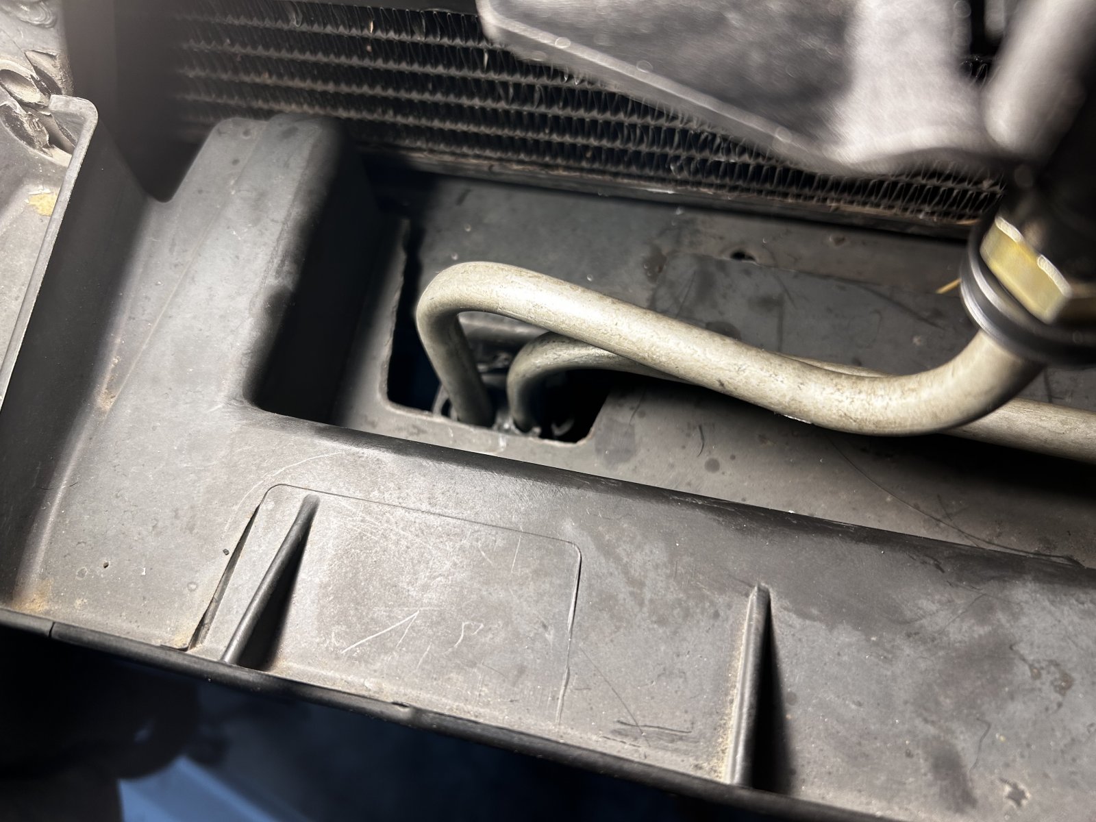

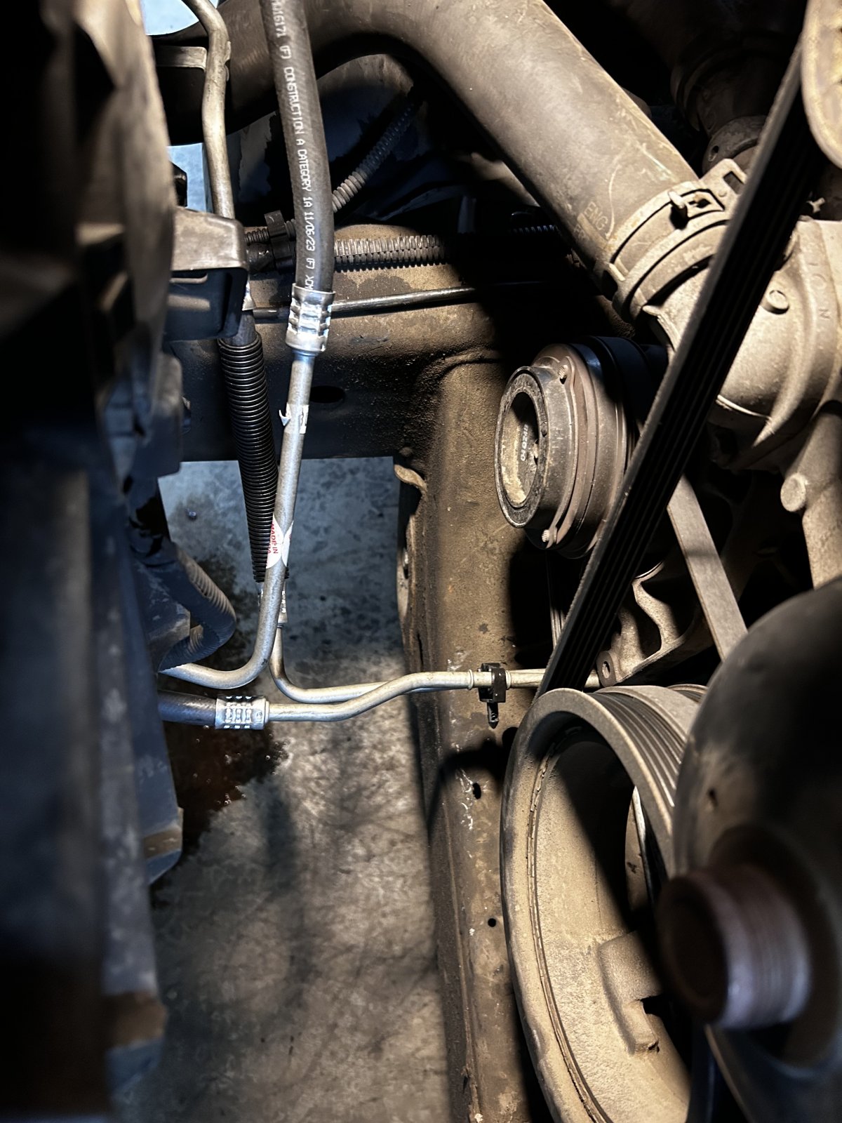

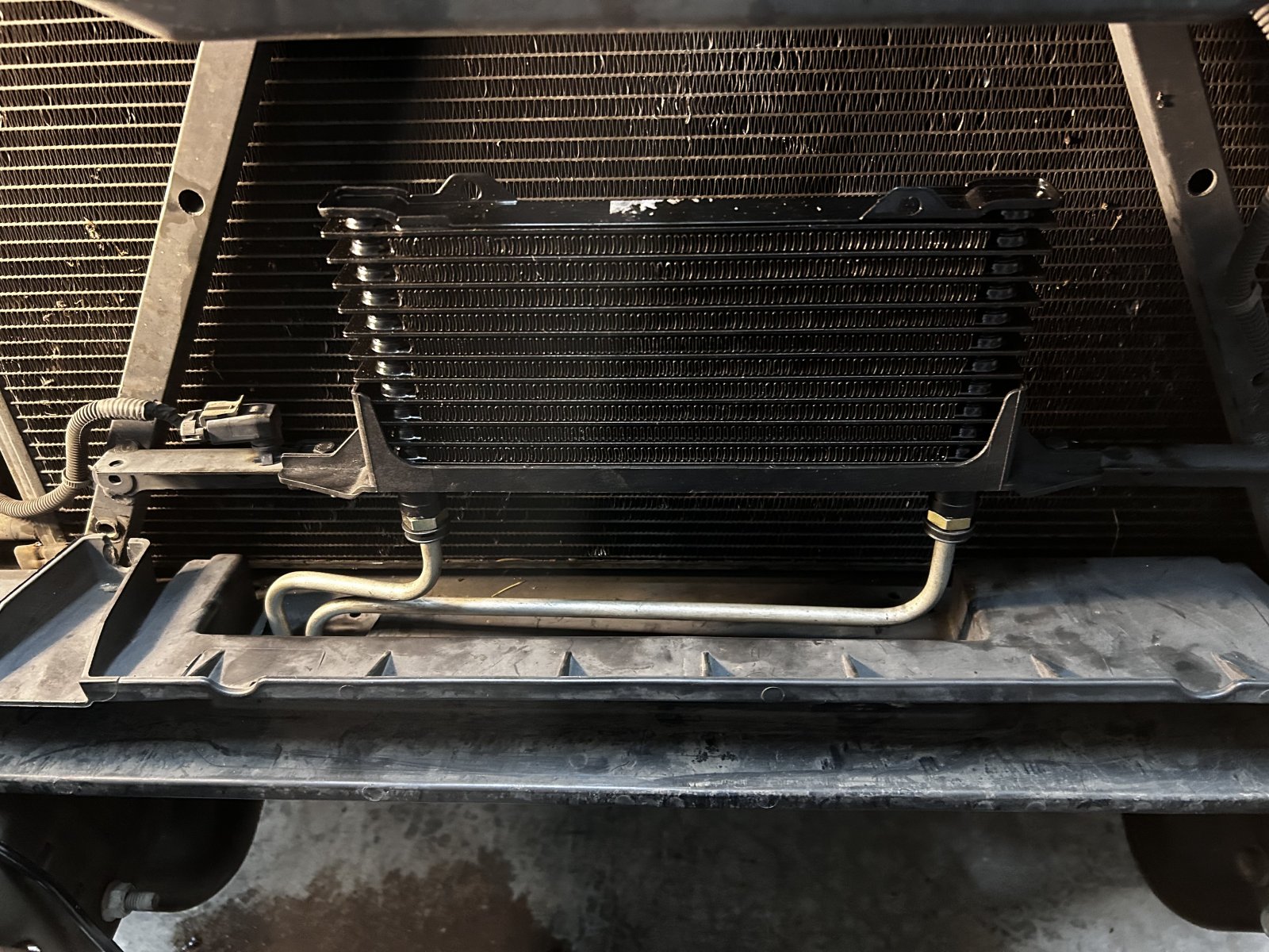

Factory style cooler installed and working! Tips: pay close attention to original line routing before removing. You obviously have to take front fascia/grill off, but also take the splash pan off beneath the radiator. It’s just four bolts and it makes things much easier. It’s tricky fishing the new lines through because they have so many bends, but it’s doable if you take your time.
