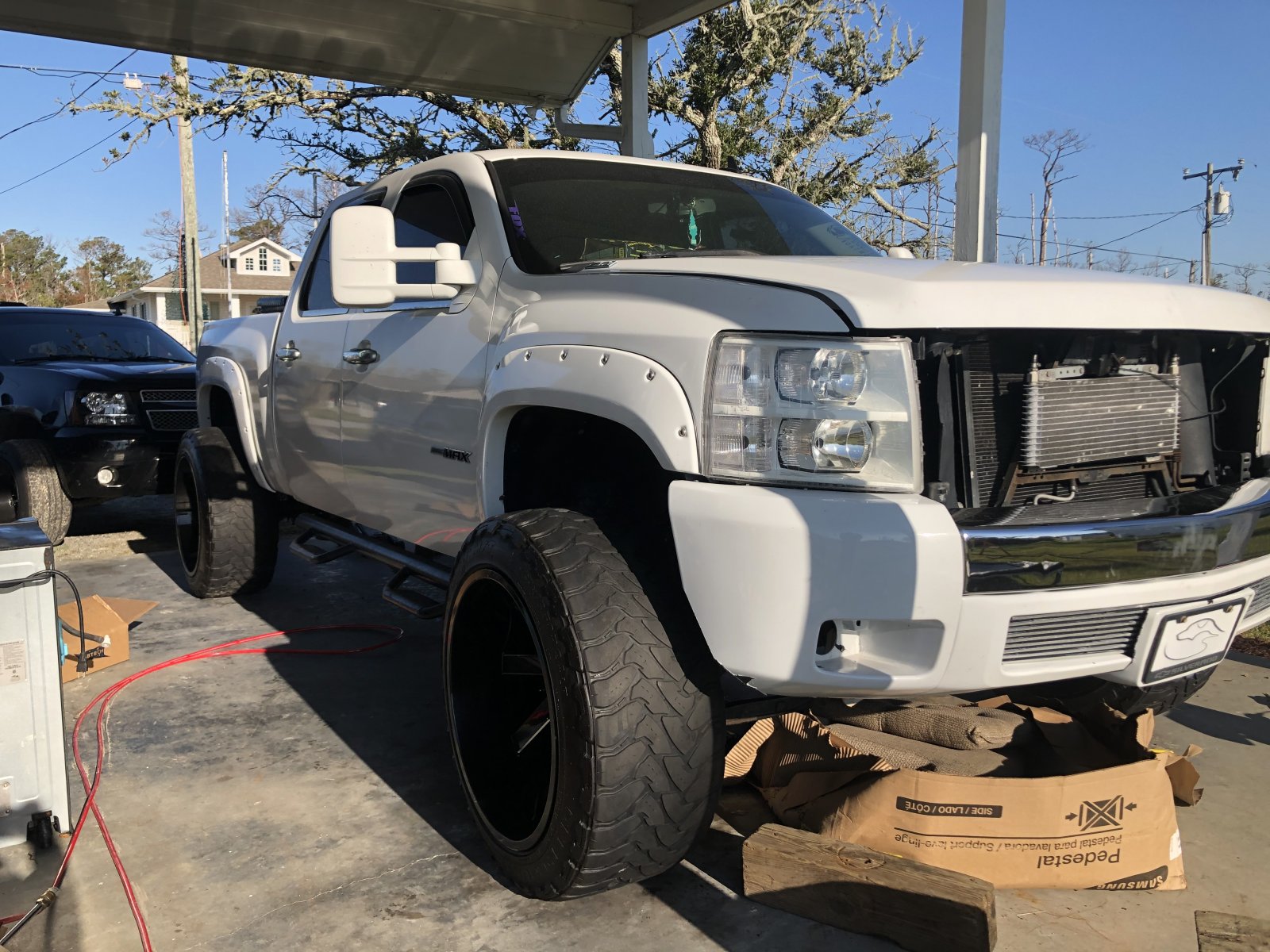

I’ve had good luck running tru cool 40k trans coolers their cheap make a considerable difference in temperature over a stock one
And mounts in the stock coolers location behind the grill
I couldn’t find the pic of the one I put on the Tahoe but here’s a pic of the one in my old Silverado
In that truck it took my temps from 210 give or take all the way down to 165-175 and that’s without a fan on it I’m sure if you put a cooling fan on there it would be even lower

View attachment 426729I couldn’t find the pic of the one I put on the Tahoe but here’s a pic of the one in my old Silverado
