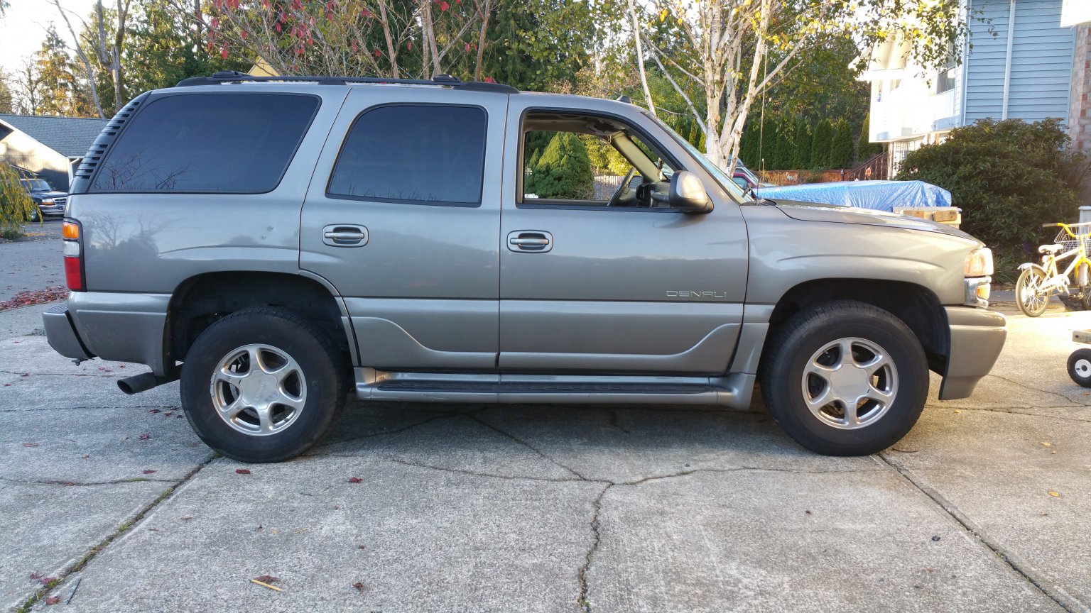

Got the springs and Bilstien 5100s on today. The rear came up 2" and the front came up an inch. Thanks for the help help guys. Here's a before and after...
