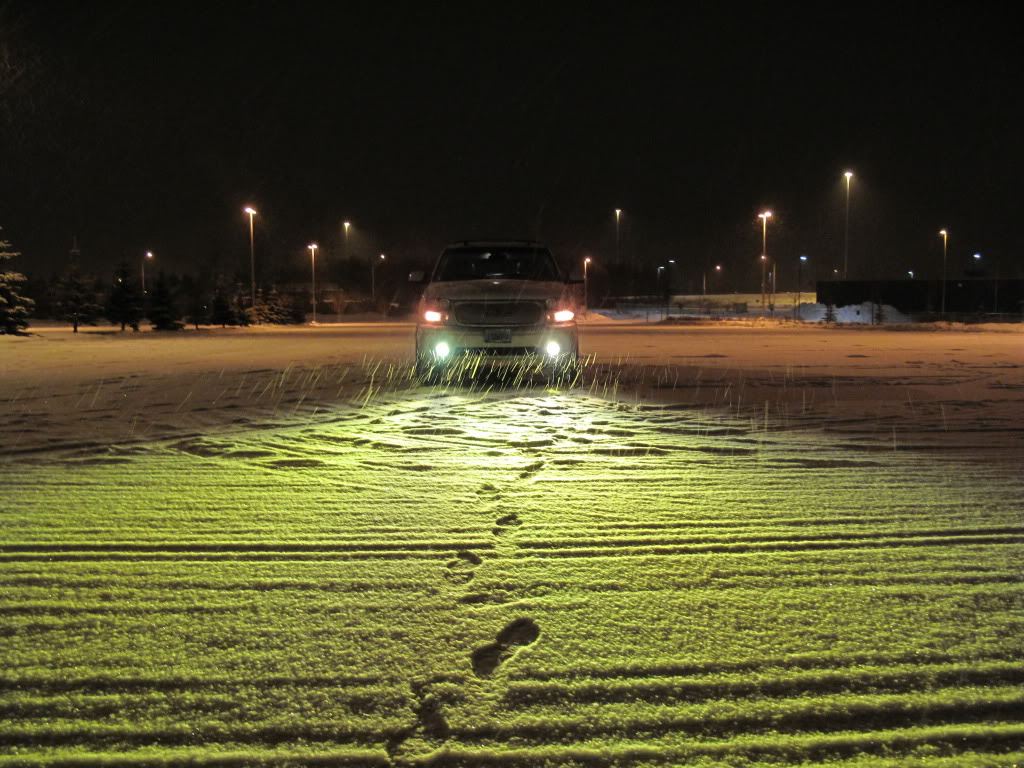

Well I guess I will see if, Kman, DenaliAK and oakrdrs187 is right on this whole 6k vs 10k deal. I got the new bulbs today and put the heads and fogs in my Saturn Vue(DD). I have a 1/2 hour commute to work in the middle of nowhere. If you all are right....I guess I'll owe you a beer!:Handshake:

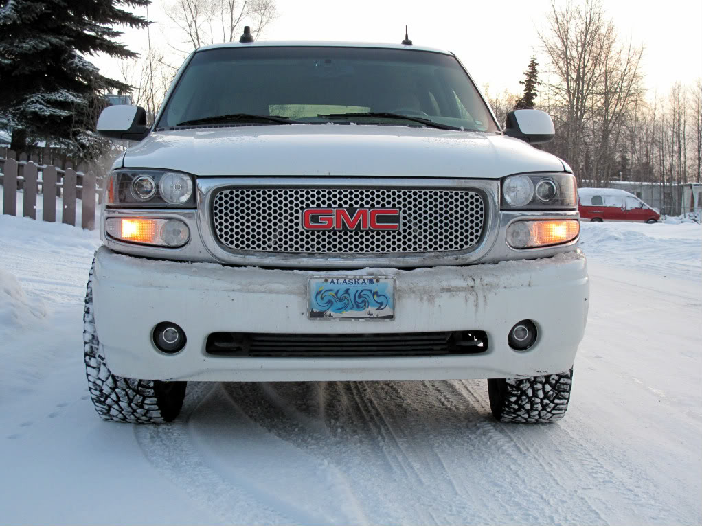

Hey DanaliAK, we were on the projector talk the other day and how I dont like the headlights. A memeber sent me a picture of these projectors that bolt right up in the factory foglight Yukon location. I know you have a Denali,but these almost made me throw up my lucky charms:doublepuke:http://www.realtruck.com/ipcw-halo-...ations&utm_source=Froogle2&utm_medium=Website
Here's my front end with both low and fog projector retros. It looks a little funky, but the light at night is pretty impressive. I'm going to redo the fogs at some point with better projectors, though. I got some pretty cheapo ebay ones for this project.
The video I posted on page 1 of this thread does not lie. I'm running 4500k bulbs with 55w ballasts. ;)
I like the spread on them fogs!
Your vid Kman is what really pursuaded me...... Id be a lil bit leary if I had no visual ref.

Where do I ship the beer:cheers:? 6k are hell of a lot better and softer on the eyes and seamed to reflect a lot better! The color is like a soft peach.....Thumbs up. I'll get all me new bulbs comin for all the toys in about an hour.
*******I ******WAS******WRONG******
