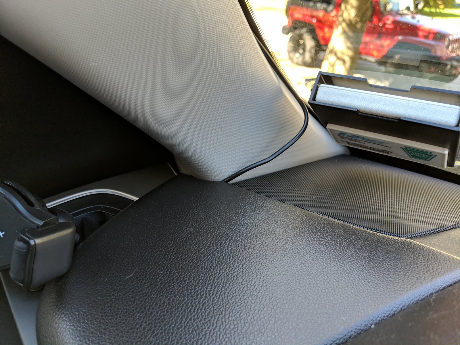

My dash cam runs along the headliner, pops back out for the motion sensor, then back up into the headliner, down the a pillar, behinds the fuse box, and has an obd connector, so I don’t have to tap or splice any factory wiring. Just plug into your obd2 port, zip tie excess wires to random bracing etc.

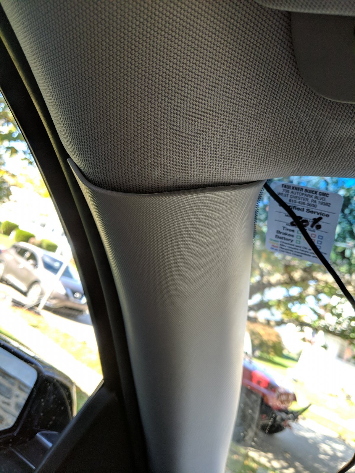

I was running my power cable behind the A pillar cover, I detached the top and ran the wire down the windshield side so that it wouldn't cross over the airbag. Now the cover won't sit tight like the clips are loose now. The gap doesn't look like much in the Pic but it's enough to bug me till it gets fixed.
