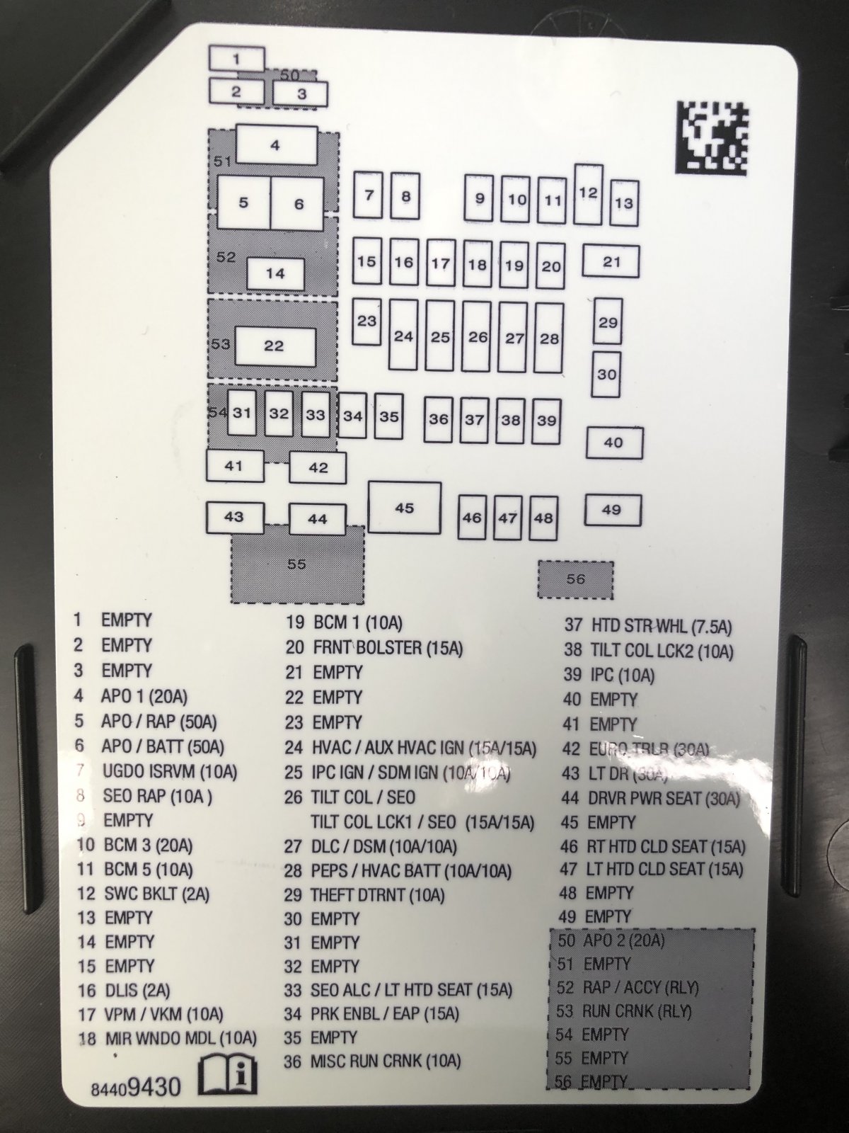

Where can I/should I connect the power wire for a dash cam? I want it powered only when the ignition is on and not powered with retained accessory power (RAP) or when the ignition is off. I have a hardwire 12v-5v accessory cable, an add-a-circuit mini-fuse tap, a usb cable and a cigarette lighter adapter. I could not tell which fuse I should tap and have no idea what some of the fuse abbreviations meant. See attached driver’s side fuse panel diagram. There were even fewer fuses on the passenger side panel.
The USB and cigarette lighter receptacle have RAP and are thus not an option.
Where is the easiest/best place to tap power?

I tapped mine in to the radio fuse
I believe the radio receives RAP (plays for 10 minutes after the ignition is turned off).
Question. Doesn’t the RAP cut off when the door is opened? If so, then that might work. Do you know which fuse in the above diagram is for the radio?

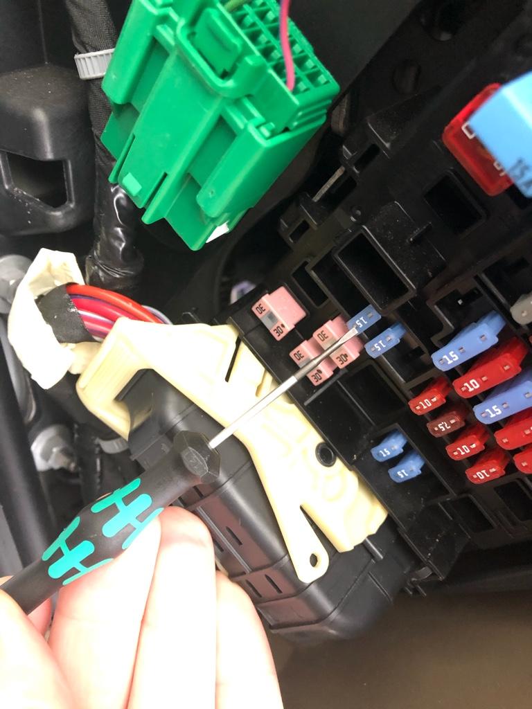

This 15 amp fuse is switched ignition power. It’s fuse 33.

For constant power, safe bet is tap into the power seat fuse.
For switched power, others mentiond good options. Cooled seats or heated steering wheel also might work too.
You can test the above fuses first using a volt meter with ignition on/off to verify volts/amps prior to install.
If you tap into another fuse currently in use, low profile micro mini fuse taps are a nice choice. Make sure to load the correct amp fuse in the correct order in the tap for added safety. 2 fuses per tap, one being the fuse you removed.
