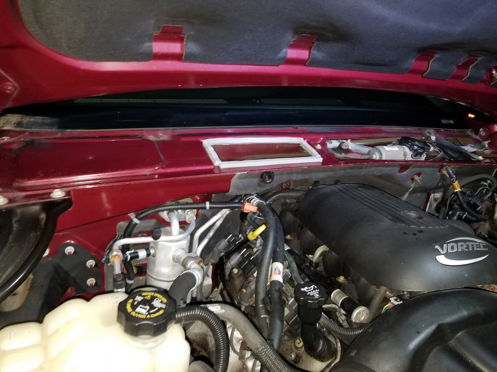

Here is a picture that I took with my cowl off a few days ago.

That white bordered seal looks good but double check the condition after the cowl was removed and replaced. Sealer around it to help fortify the existing seal cannot hurt. The other painted red cover there, above the a/c accumulator is also another place where it leaks and seems to be a degradation at the windshield side of it that seems to be the problem area. I think that lifts off and if is easy to do so that is a sign of the seal breakdown. Also look in there where the wiper motor is at. I would not do any of this till you place the paper towels and wait and see where the wet spots are actually at. Then you can tear in to it. While it could be the windshield and the seal I would not do that till you pinpoint the problem area and then if it is the cowl, you can still do the w/s after that. Your call of course. If you have help shine a bright flashlight from inside and outside of the edge area of the w/s seal and look for light. Someone shine and the other look. Best in a dark area, like a garage with no lights on. Can also do that at the sunroof drain and at the door seals and the little antenna area at the top of the rig, if you have one, but that would really have to be leaking for both floors to be wet. Remember, the passenger side floor could still show signs from when the heater core leaked and the drivers side may be the only one effected instead of both sides, like may be going on now.

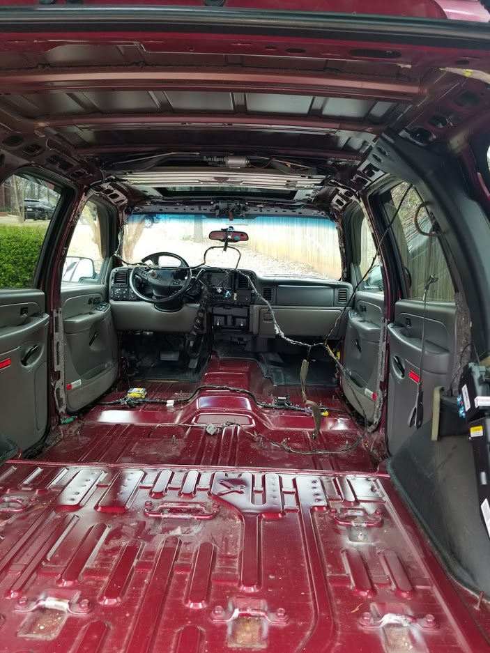

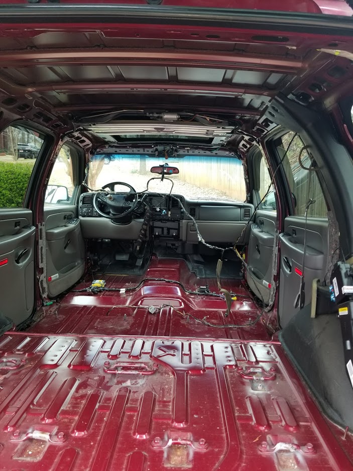

On Friday, I pulled off the kick panel and door molding on both sides and pulled the carpet and padding back. Both were wet but not soaked. The plastic under the pedals on the floor has foam under it and that was soaked on both sides so I propped them up. I moved the fan around all weekend to make sure it was all dry as a bone. It did not rain last night but this morning I checked and padding was kind of wet from condensation the collected on the metal floor and the foam under past under the pedals was wet again! I'm baffled... It didn't rain and it's not coolant.
My last-ditch effort is that I have now pulled the seats, carpet, and padding out. We're supposed to get a big rainstorm tomorrow and I'm just going to let it see and see what happens.

Well, it rained last night and when I checked it today was completely dry. Things I hadn't posted here were installing new door rubber, removing/resealing the plastic cap under the cowl (over the AC intake), and adding some clear chalking in areas under the rubber that runs over all the doors. Maybe one of those fixed it. These are all things I found on the Internet of people having a water issue in this model. I couldn't find which it was so I'm just doing it all. I'm also having the windshield replaced tomorrow. After that, I'm going to put a seat back in and drive it around in the rain and see what happens.
And since I have all the molding and seats out, I'm going to use this opportunity to replace the carpets. It's got some faded stains I couldn't get out so what the hell. Is it worth the extra $100 for the Mass Backing instead of just the regular Cutpile?
By the time I'm done I'm going to have a 5k car that I paid 7k for. lol Oh well, it's all for the fun of it.

Holy crapola!!!!! Bare bones and all red. Look for the wet spot.
