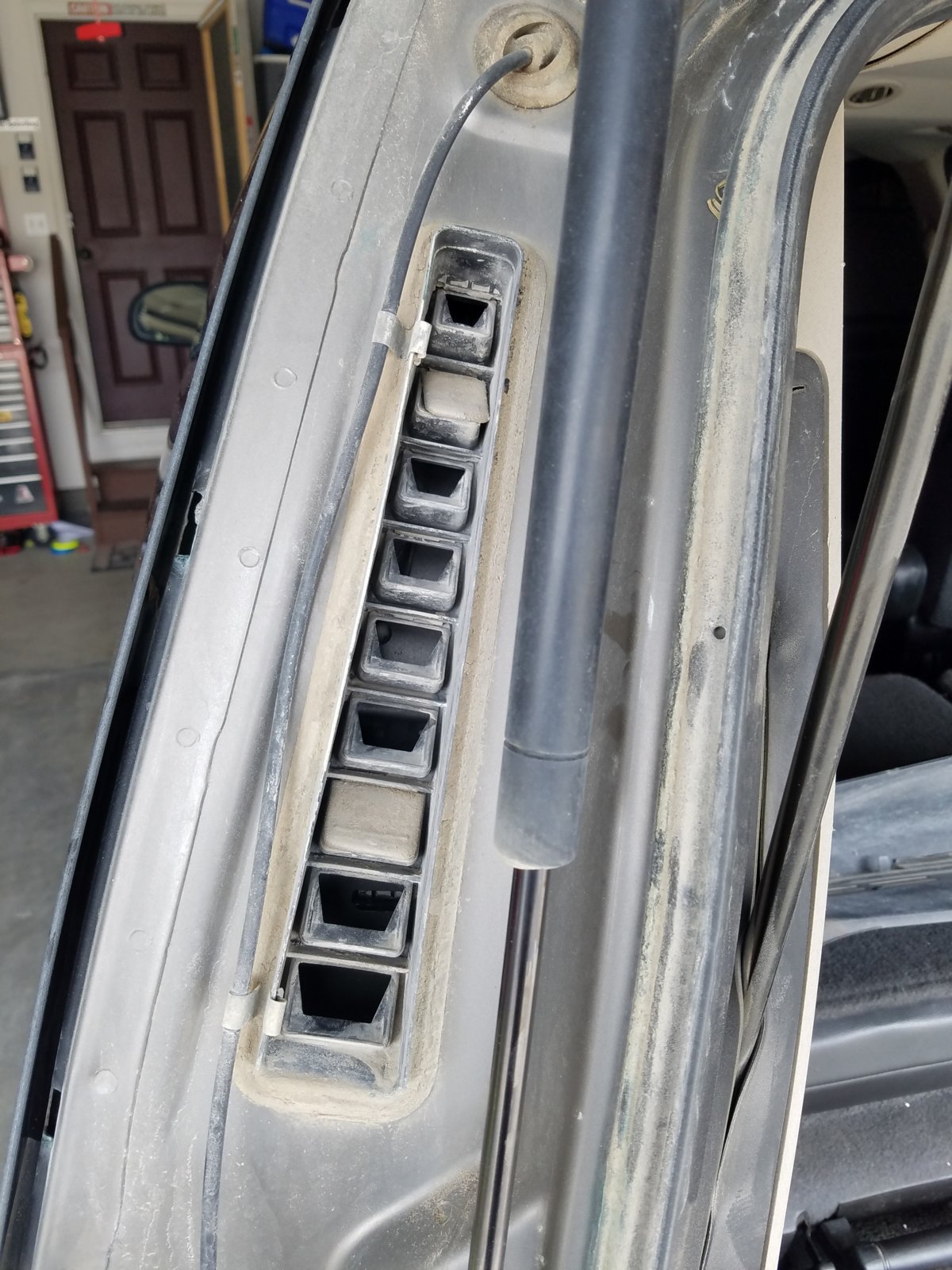

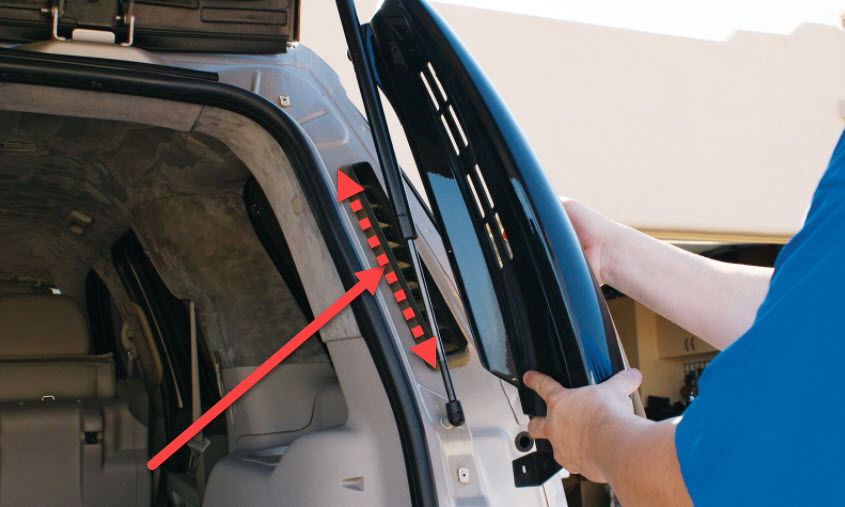

Can't find the correct name for these anywhere. I'm not looking for the exterior cover, I'm looking for the piece that goes under them.
Black plastic thing with little rubber flaps to release cabin pressure or something. Mine are missing several of the flaps and I occasionally have to travel on gravel. The entire truck fills up with dust because these stupid things obviously don't seal correctly with missing parts/rubber flaps. Anyone know a part number or the correct name for them?
Thanks!!

curious as to how it came to be missing pieces? but you could just tape off that one side if you really need to, it just releases the pressure when you shut the doors, one side open should be fine, you might feel a little more air pressure inside when shutting the doors, if you have a dealer nearby you could go in the parts department with your vin number and see if they can look it up on the computer, otherwise a premium junk yard.

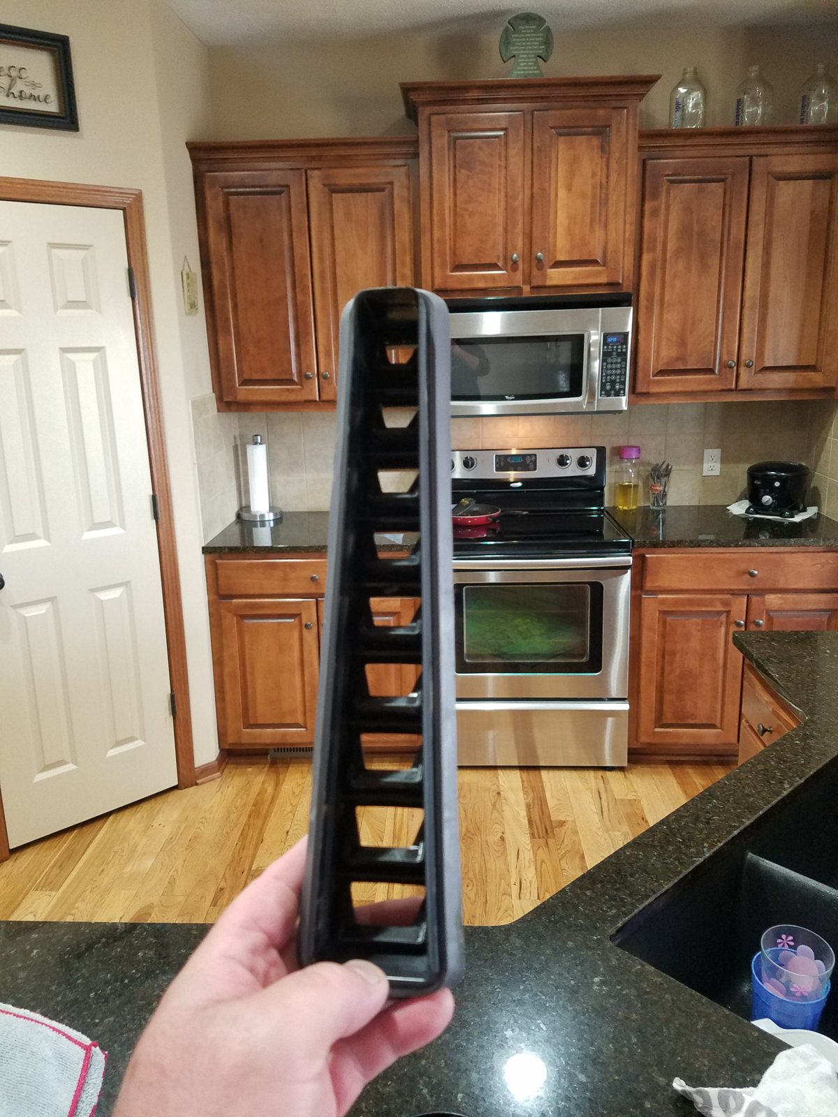

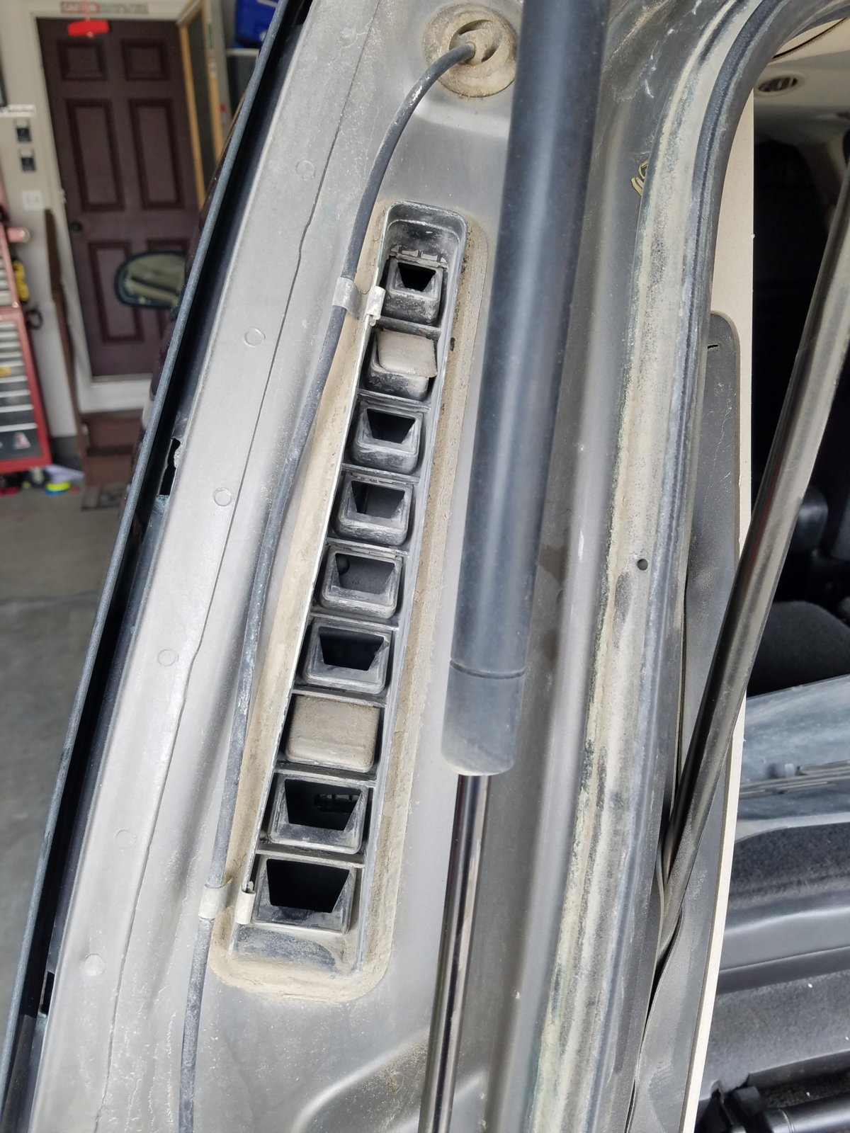

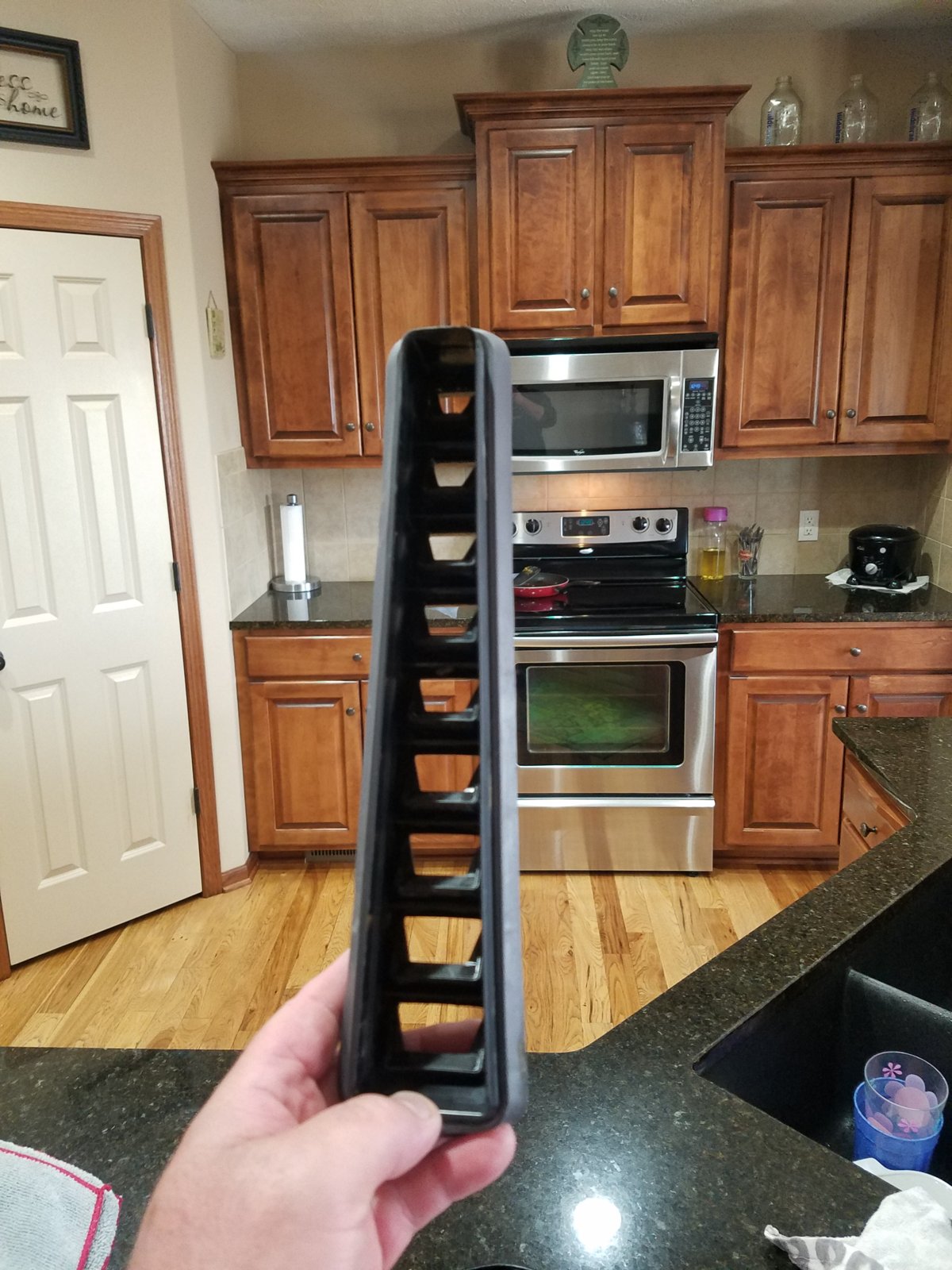

Just like I thought... out of 9 holes/ports whatever, TWO of them were covered and both of those fell off as soon as I touched it. Of course there's no part number to be found anywhere on it either... ugh :(

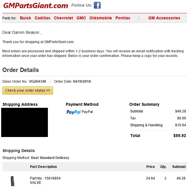

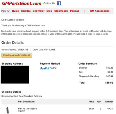

Thanks Mark! I need both sides, my fear is used ones will do exactly the same thing in a very short period of time. I ended up getting 2 new ones from gmpartsgiant.com. Even with shipping it was almost 30 bucks less than the dealer (who would have also had to order them).

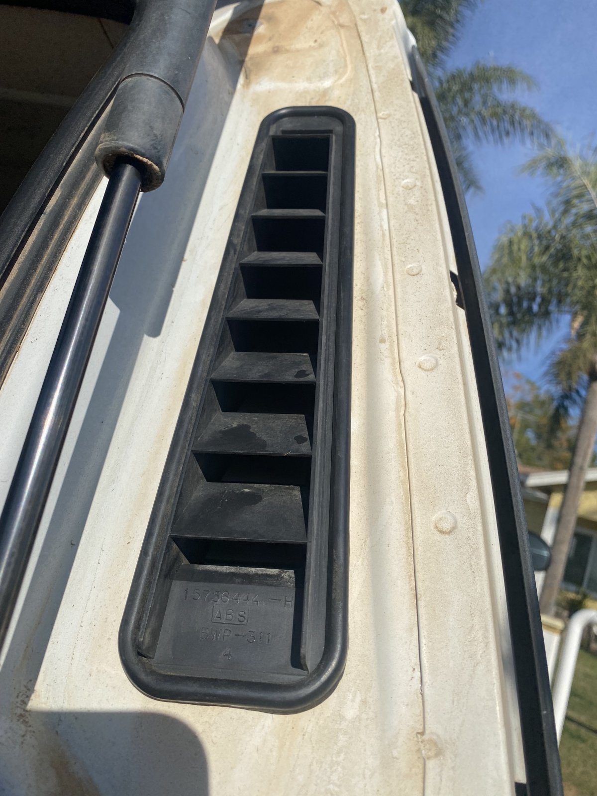

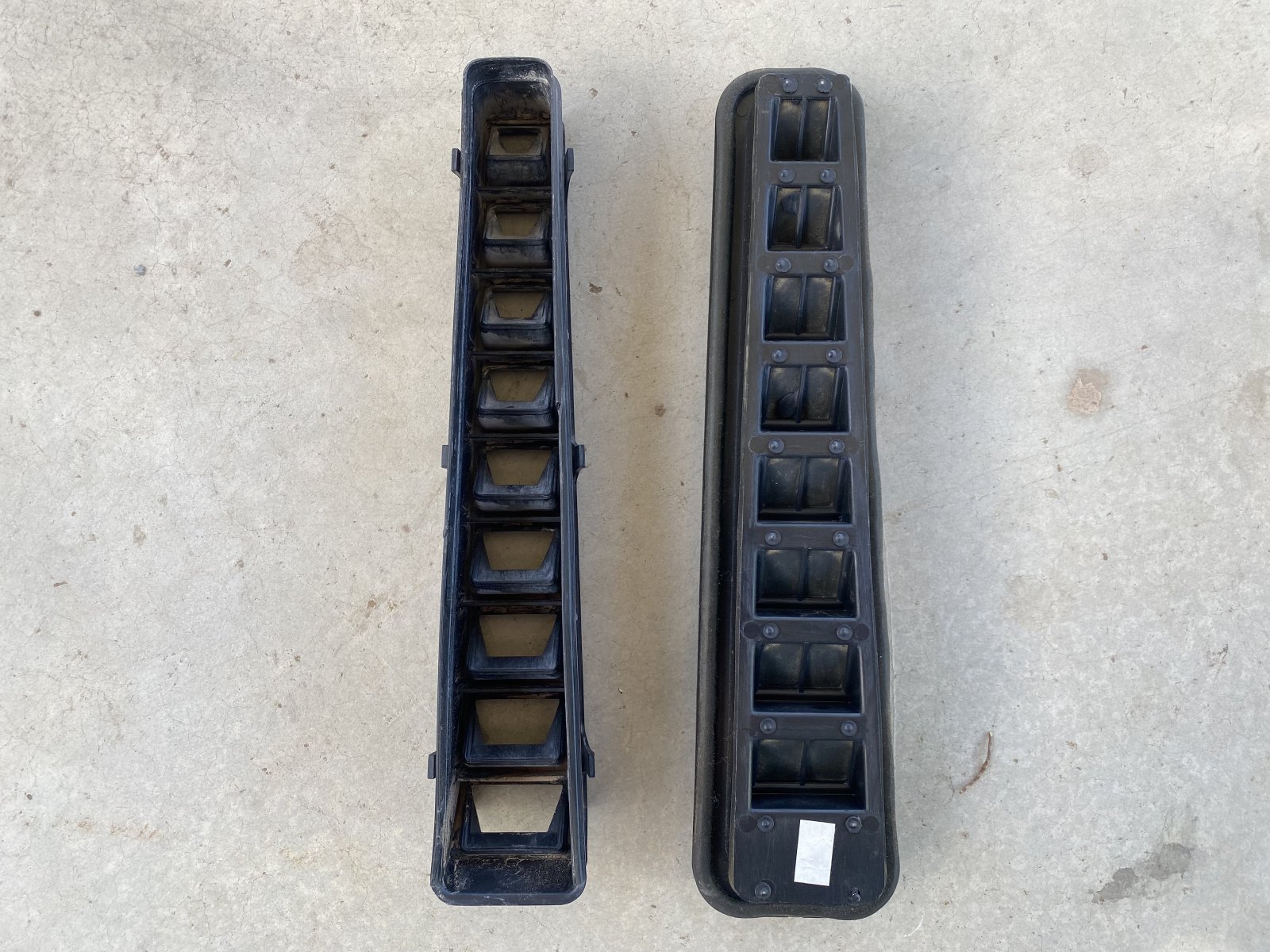

I need to replace the drivers side also and ordered two used OEM ones from eBay for $ 14.00 but they are called "Pressure Relief Valves"
New Part # GM 15816854
Old Part # GM 15756444

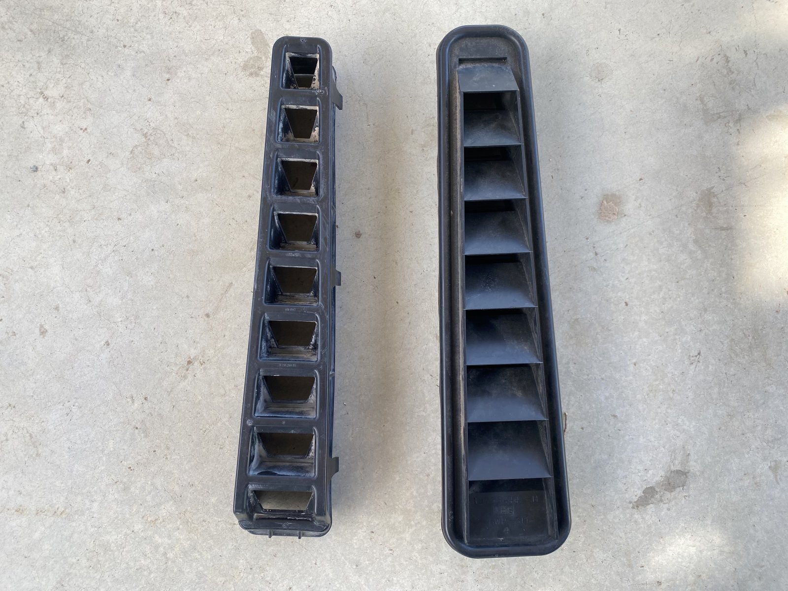

Good morning, all, so I received my two "body Pressure relief" valves from a seller on eBay yesterday (GM 15756444) and went to replace the old ones and noticed that the ones that were presently installed in my 2011 be very different (see picture old on the left and new on the right) The old ones have NO rubber valve flaps installed while the new ones did. Just kind of weird and this would explain my dust intrusion into the rear of the truck.
