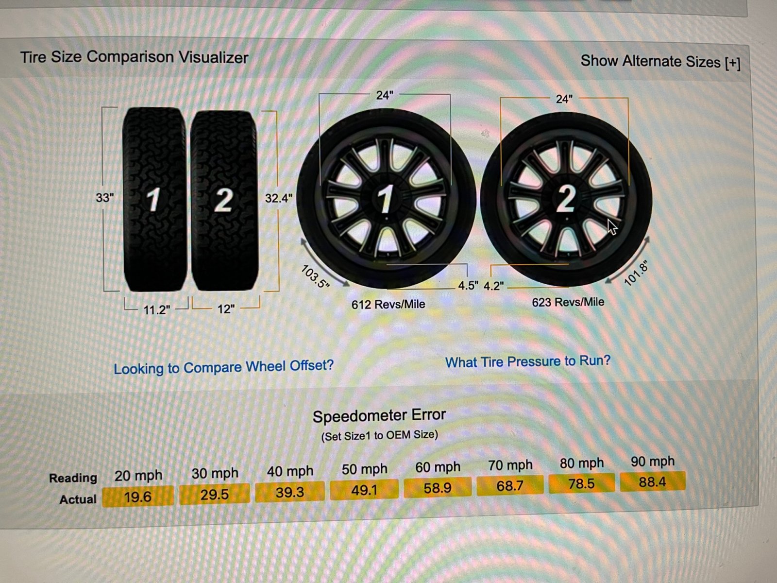

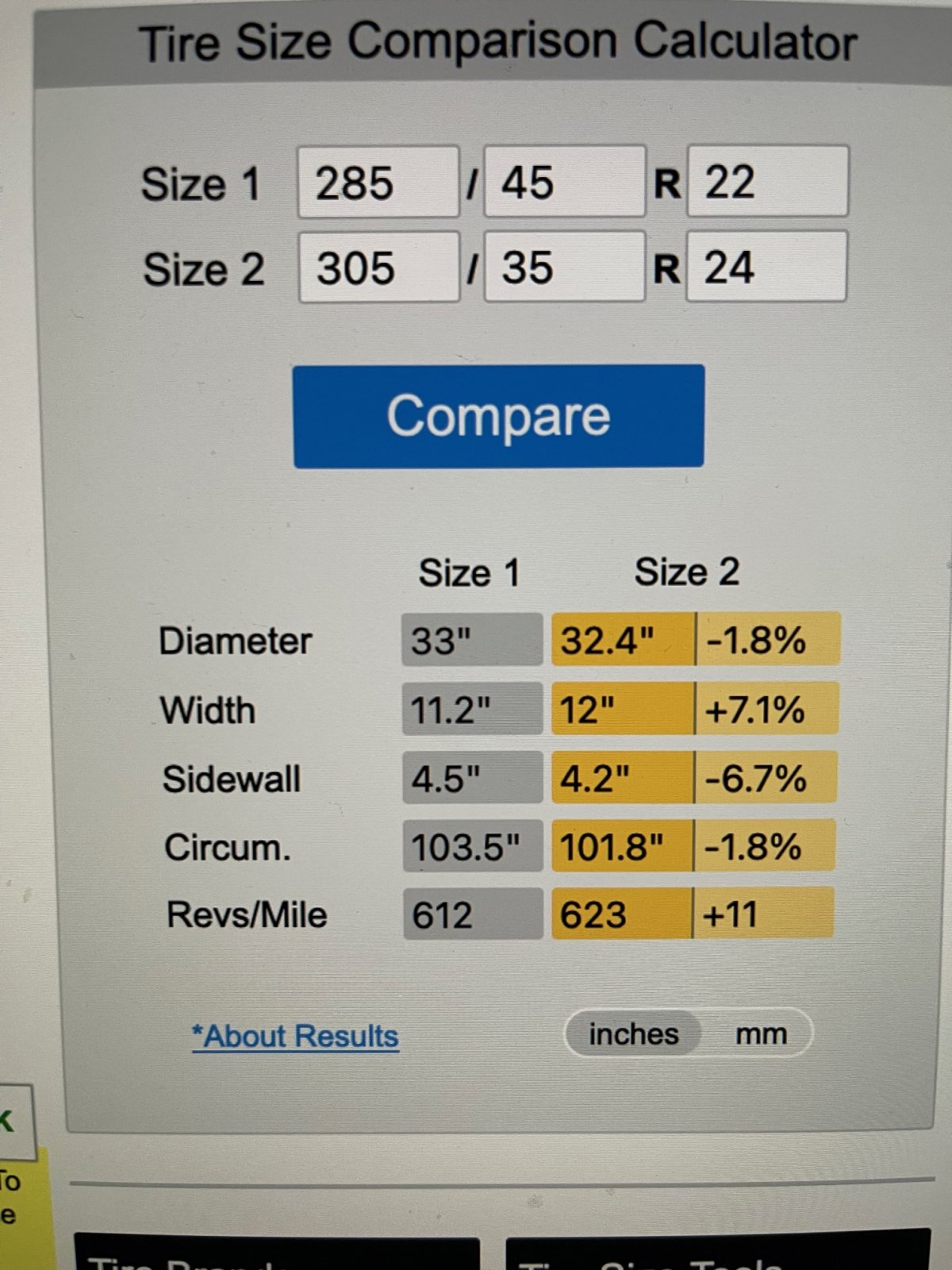

Just took delivery on my 2022 Denali. My first diesel so I was reviewing the operational manual, not typically something I get hung up on. I noted in it is said do not to change the tire size or this may affect the motor operation. WHAT?
I have ordered a set of 24 wheels with 305 35 24. So this will decrease the overall height by about .5 of an inch. Can the speedometer be calibrated? how will this actually affect the motor as per the manual??
View attachment 361803View attachment 361804
Why do you have 285/45/22’s in there…that isnt what the new rigs come with. They come with 275/50/22’s.
