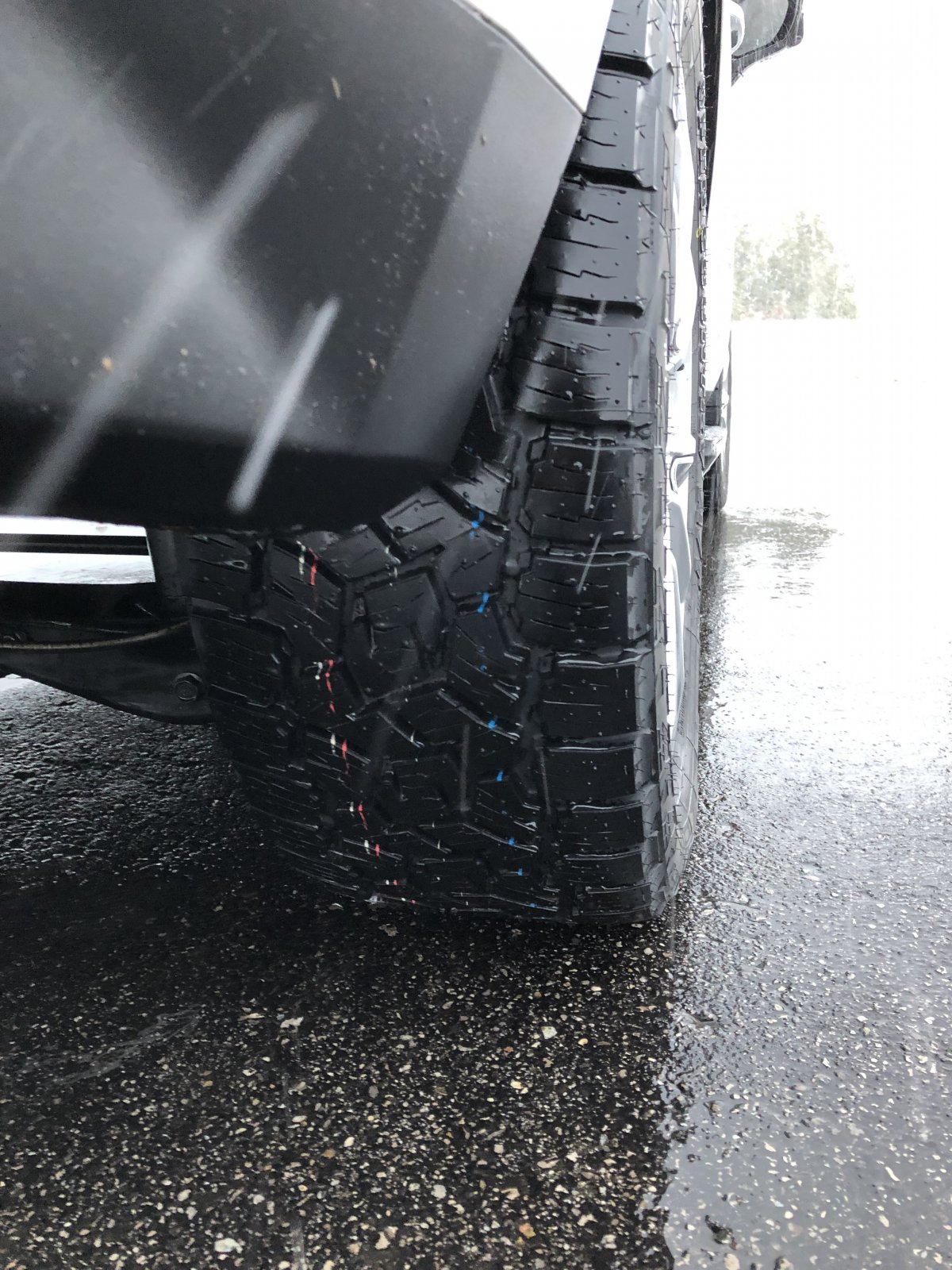

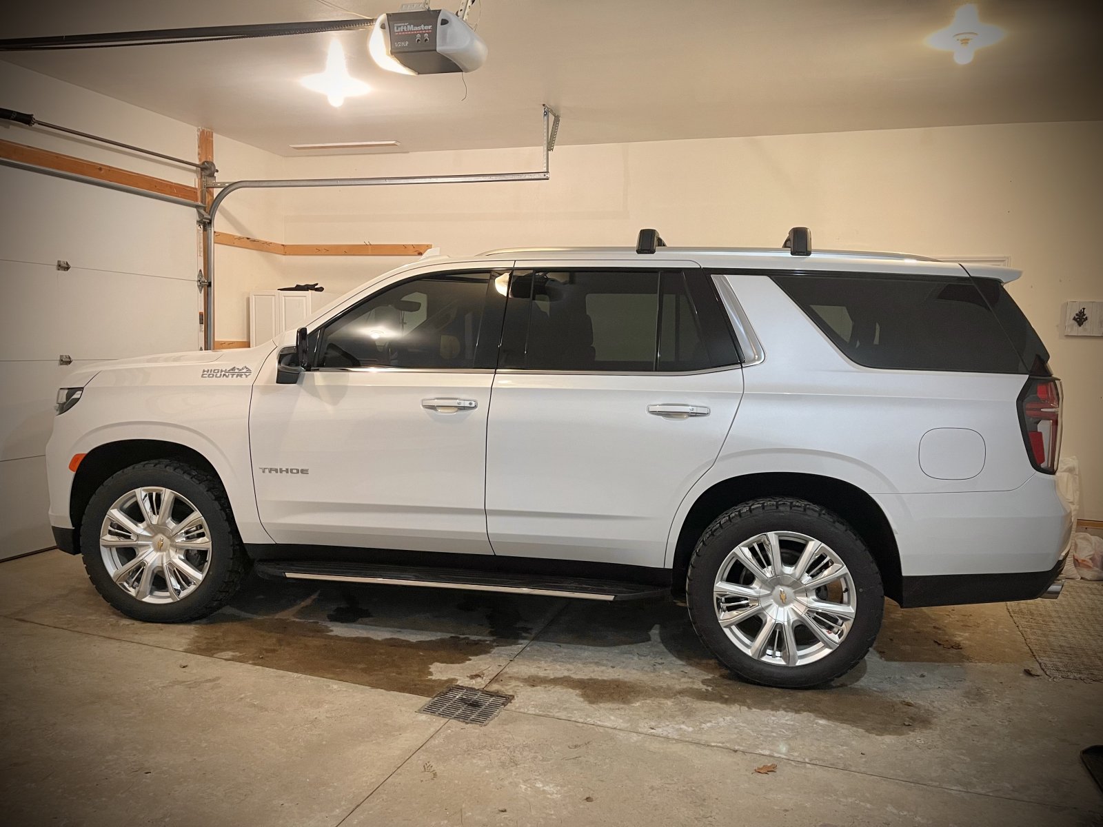

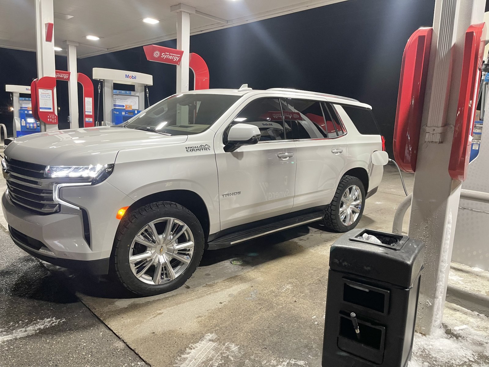

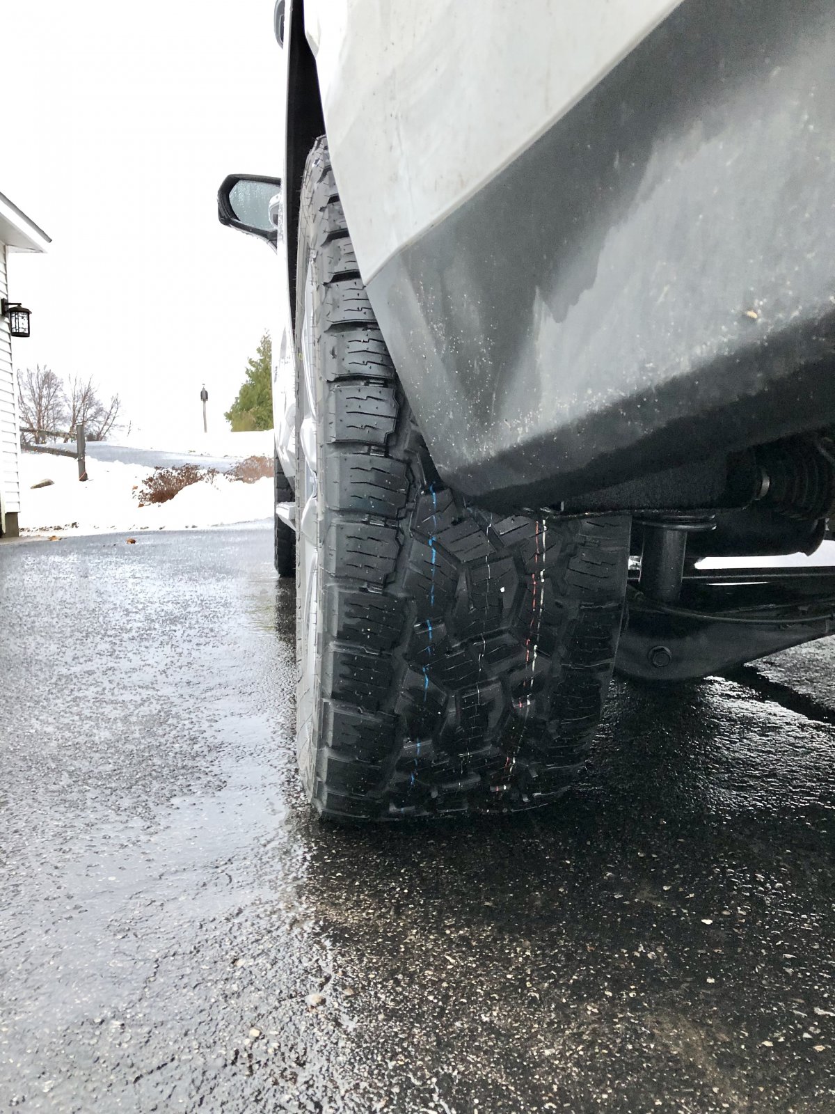

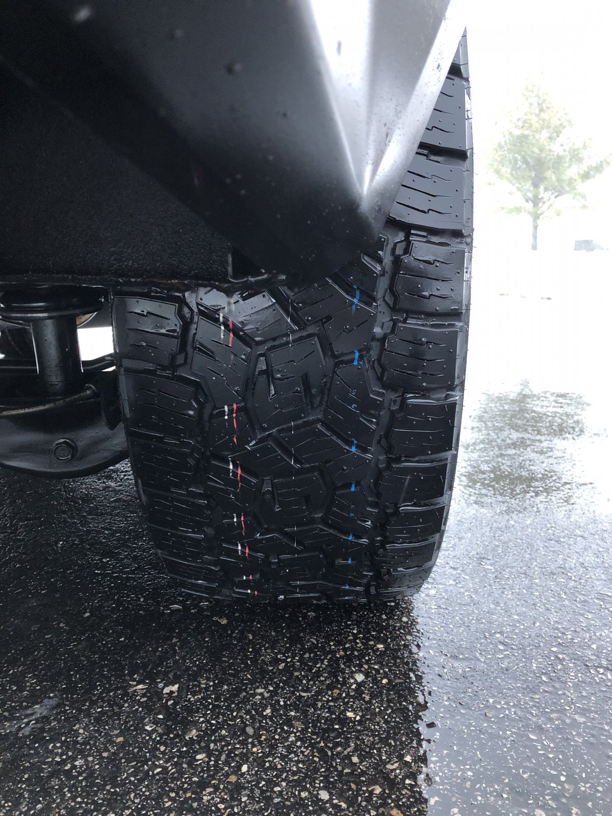

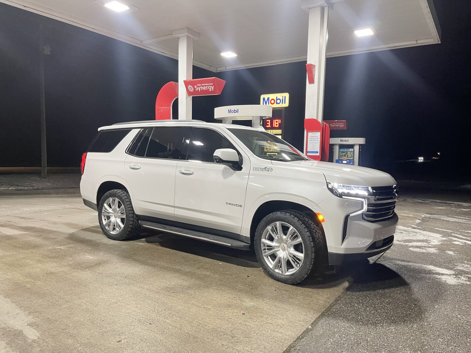

These are two pics she sent me after leaving the tire shop.

I just put on 33x12.5 with no level or lift. Had to do a little bit of trimming to pull the liner back. It rubs a little still but not a big deal. Wheels are -12 offset.

They definitely do not look too wide for the wheels or out of place. Looks legit like it could be an oem size to me.
