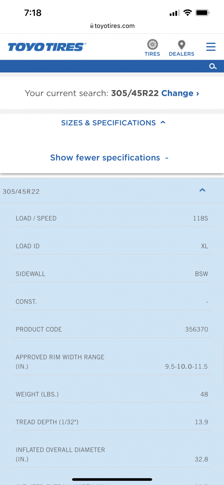

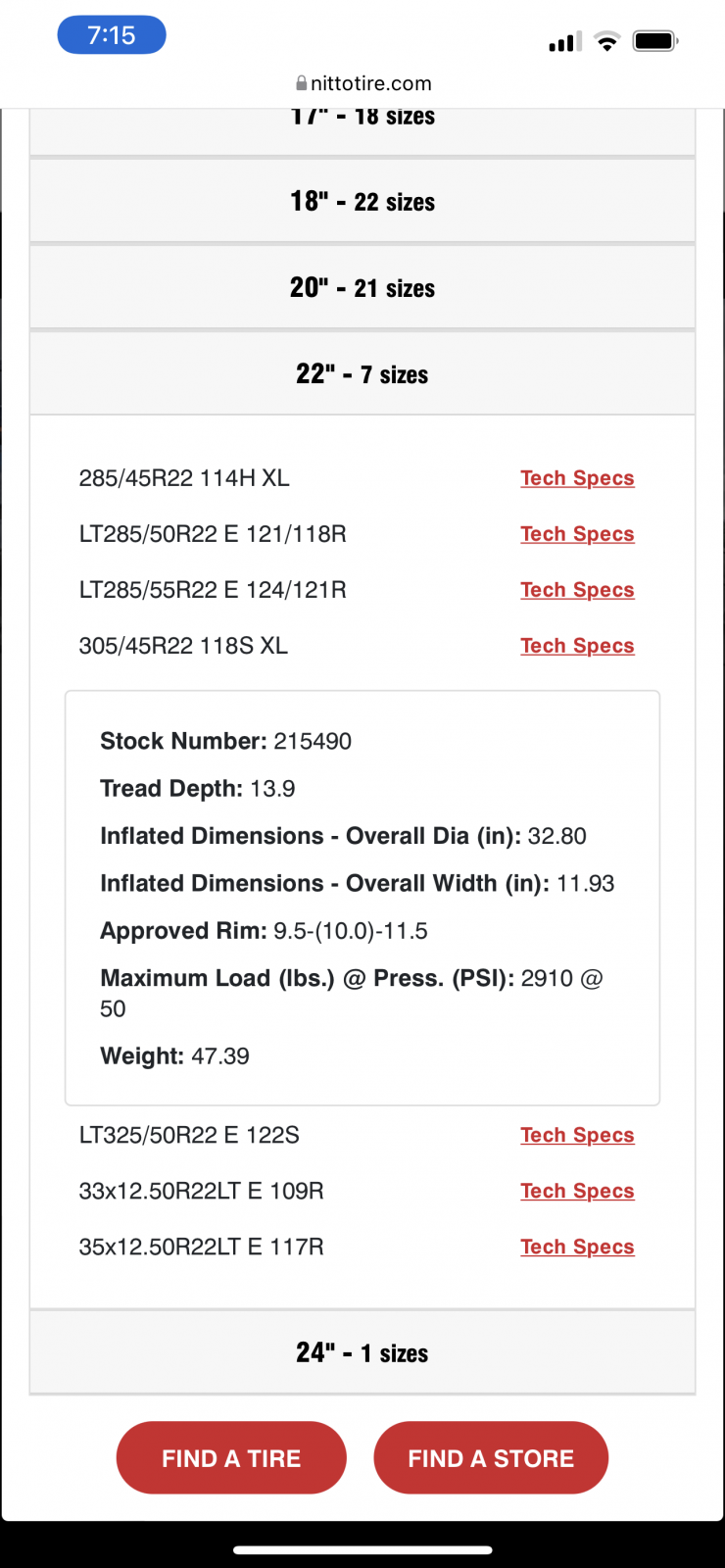

Not trying to poke holes or be an Ahole but I see both the Toyo AT3 and the Nitto TG specing at 9.5” min rim width, just checking what I might be missing as I was looking for taller/wider as well.

Understood on the spacers, they can be a pain if you have to trim studs, etc.
View attachment 355667View attachment 355668
Well shoot. Guess i dont know why i thought it showed a minimum of 9”…it sure as heck is 9.5”…i must have been looking at a different size tire when i saw the 9” ugh. Well, i will see what discount says when they go to mount them up, because i just ordered them.

I find it odd that the toyo 33/12.5/22 tire is spec’d at a 12.5” wide inflated width and specs a minimum rim width of 8.5”, yet the 305/45/22 is spec’d at 11.8” wide but a 9.5” minimum rim width. Wtf.
Im not worried as far as functionality and wear goes. I have run many tires on skinnier rims than spec’d and never had a single issue with wear. The problem will be if discount tire catches it and wont mount them…i will have to go down the road. Been there and done that i guess.
