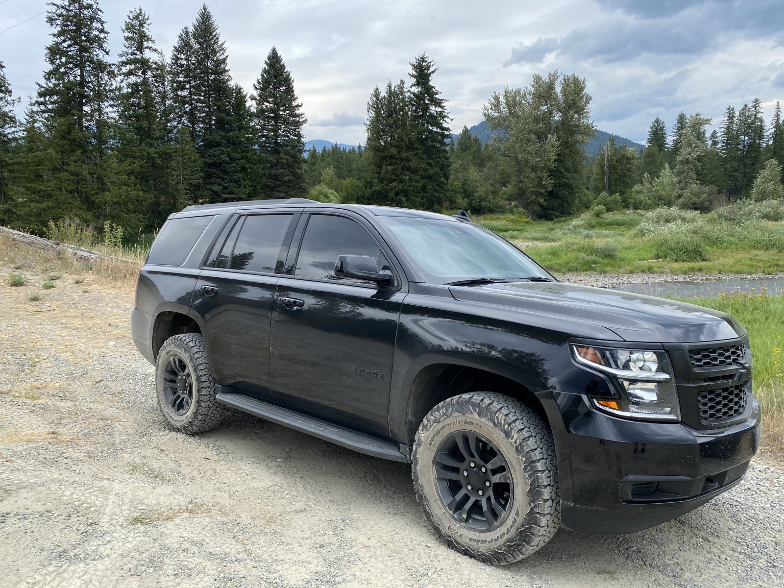

275/70/18 BFG K02’s
Fit perfectly on the stock 18" wheels, no rub.
1.75" front level with Bilstein 5100's.
