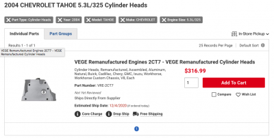

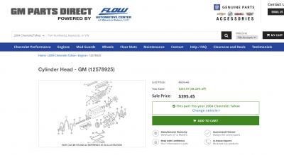

PNWYukon
May 13, 2015
321
250
Olympia, WA
Reman.
