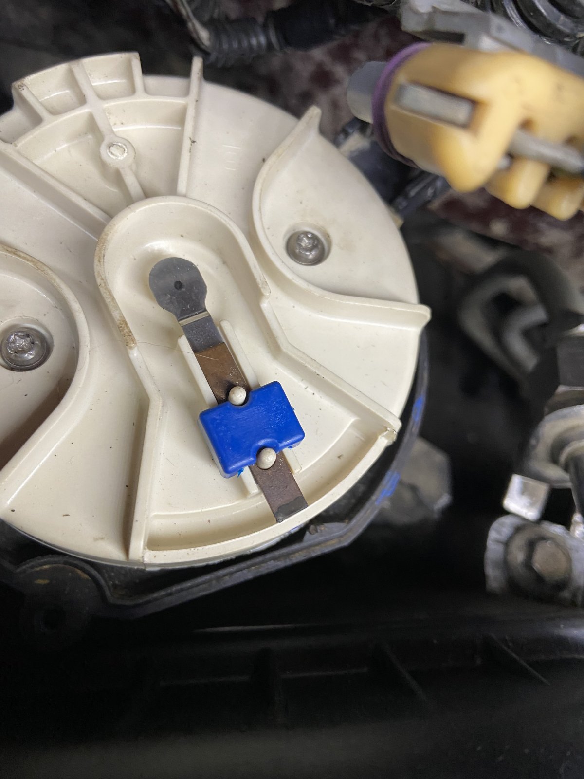

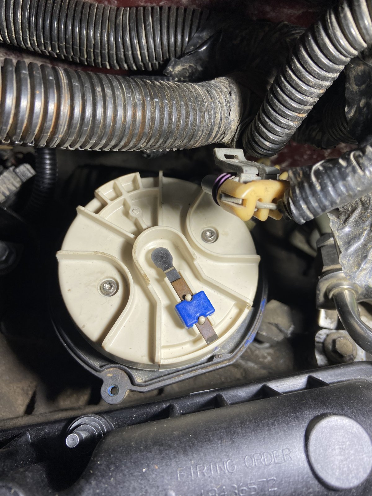

Does this look right for TDC compression on #1 before setting the CMP offset?
It’s the first time that I’ve ever set one after moving the crank. It’s pointing more toward three than one, so I’m second-guessing things but the manual says it should hit the #8 mark which it does.
What do y’all think?
The rotor moves maybe a couple degrees from the #8 mark when the housing is turned:

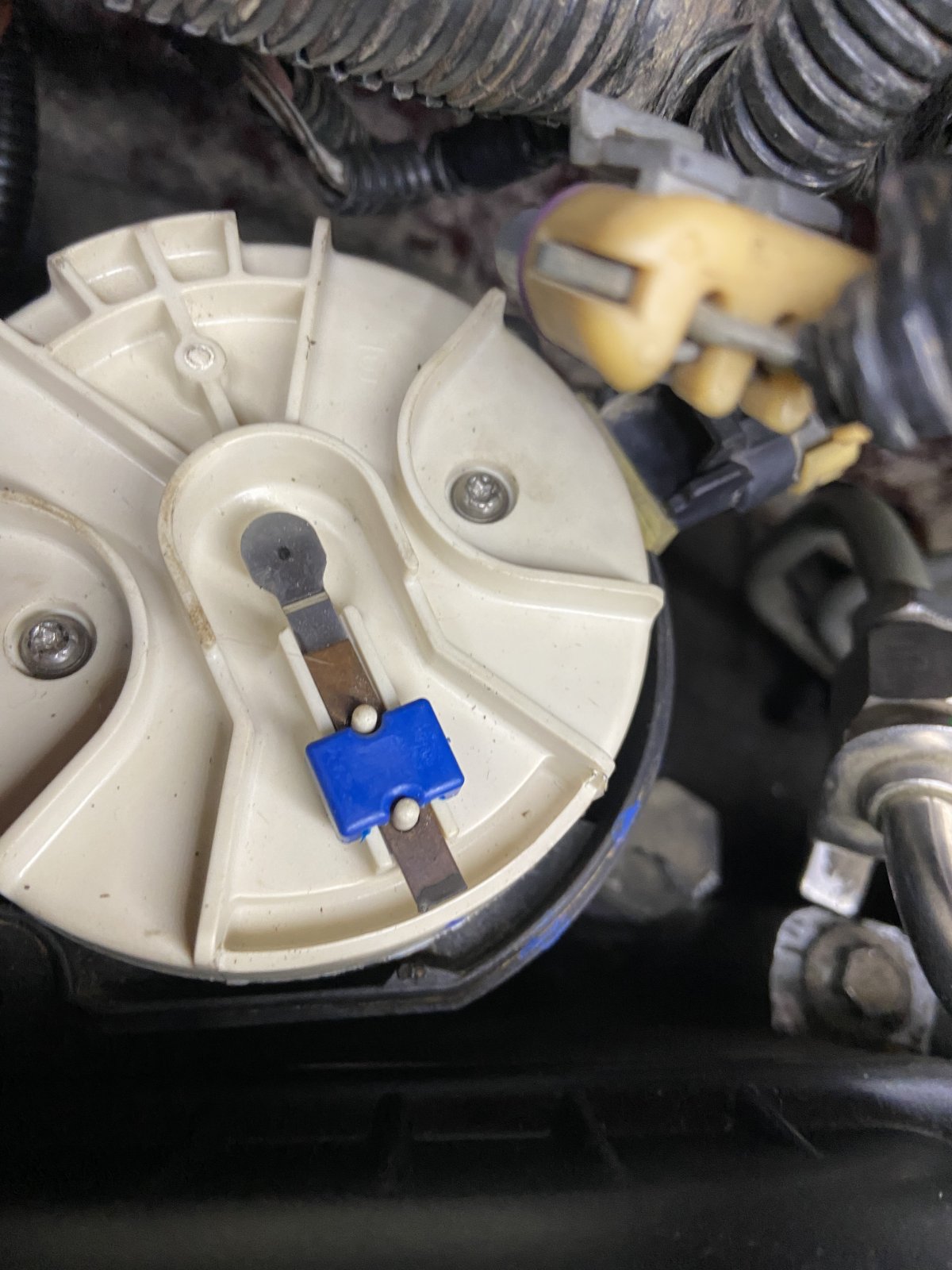

And here is the other extreme which better aligns with the #1 post on the cap.
