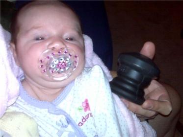

Z71 4x4 bumptops, problem solved. $25ea at dealer
Here's what I posted a while back:
The Z71 4x4 bumpstop is a tad shorter I believe, and they have a lip that reinforces them. So they look like an upside-down muffin. That thick lip helps with the bottoming out support when you lower your front. You will always ride on them in the front, not an issue at all. You want to ride on them to be honest. I swear by these - took me hunting about 4 hours at a junkyard to find the right one...I didn't even know I was under a Z71 until I got em out and looked later. I had a bad bottoming out issue that almost had me cutting my fenders until I found those.

00-06 z71 4x4 package is the truck I got em from .... I might have the part no...hang on lemme check the garage.
B
---------- Post added at 02:59 PM ---------- Previous post was at 02:52 PM ----------
15161762 is the GM part no.

Hers what they look like

and where do you put the bumpstops?

Look behind front wheels, there is a small cup that holds it. 2 flathead screwdrivers and pry em out. Truck has to be up on the side u work on though.
