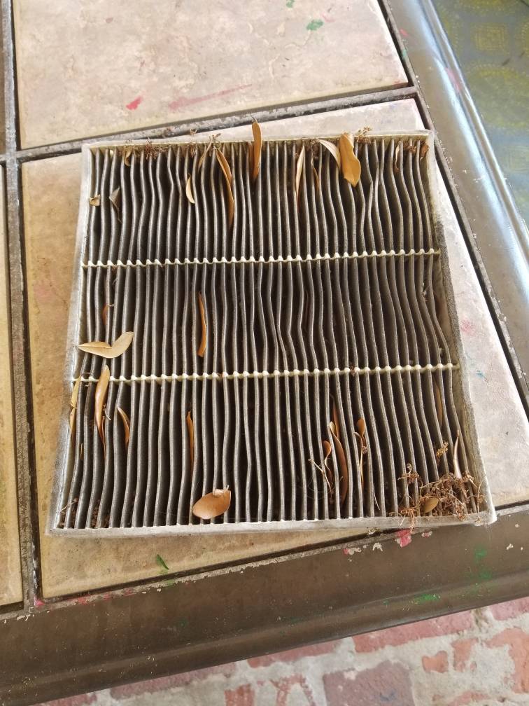

Changed the cabin air filter last week! [emoji50][emoji50]

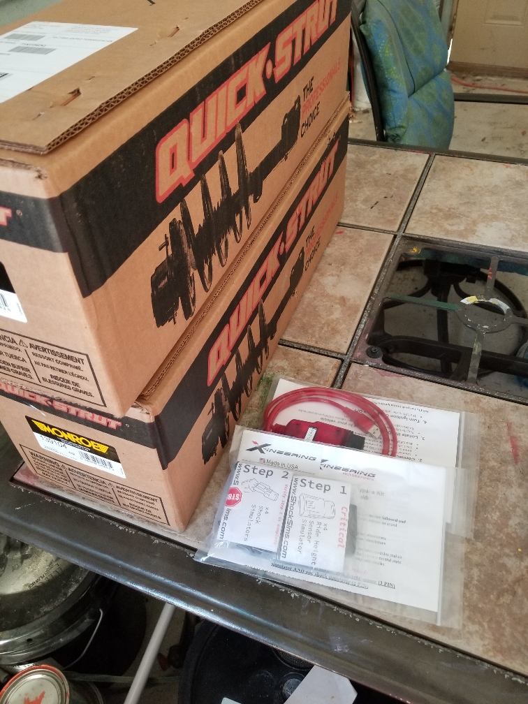

Well, I just spent a pile of money on this thing.
Just ordered 2 new Monroe 139104 Struts, 2 new AC 540-1723 rear air shocks , the full xineering kit and module to reset the trims! Gotta fix this crappy ride!

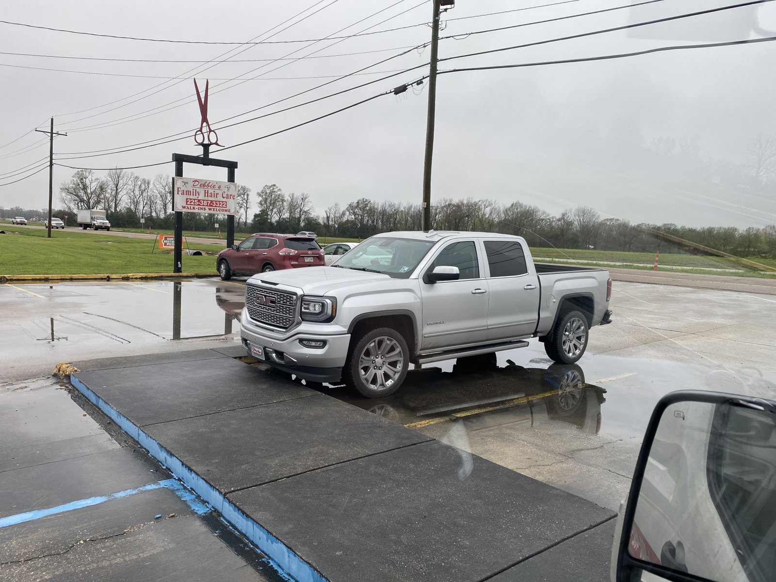

I was creepin by your place today around 1500. Didn't notice the Yukon cuz my eyes never made it past that sexy ass Sierra.
Lol, thanks. Should've stopped. I had just finished up
45,012
That Sierra's sick af with the monotone/grayscale look. I wanted to stop but I was in my work van and it's tracked by GPS. They monitor EVERYTHING including location, stops, etc. That time I stopped by to grab them struts I was in a rental. Talk about a feeling of freedom!

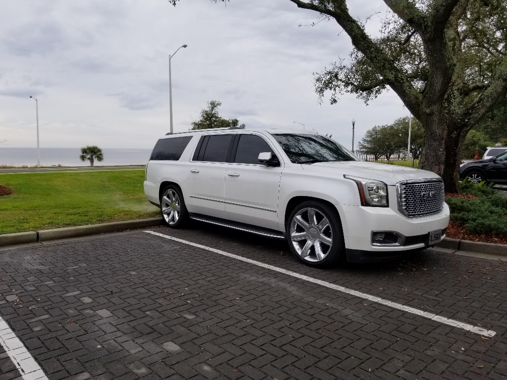

There's no way it was gonna settle 2.25". I actually swapped it to under the control arms, and that put it about 1/2" lower than the rear, but it rode like crap that way. So **** it. I ordered and installed coilovers.
Got the rear shocks swapped out today and removed the 1" spacer. Now the rear has heater hose on the top of the coils and the factory thin rubber at the bottom. My rods are set at 2.75"
It sits at 34" on all corners. On 305/35/24
I'd say the oem rear shocks were definitely shot.
