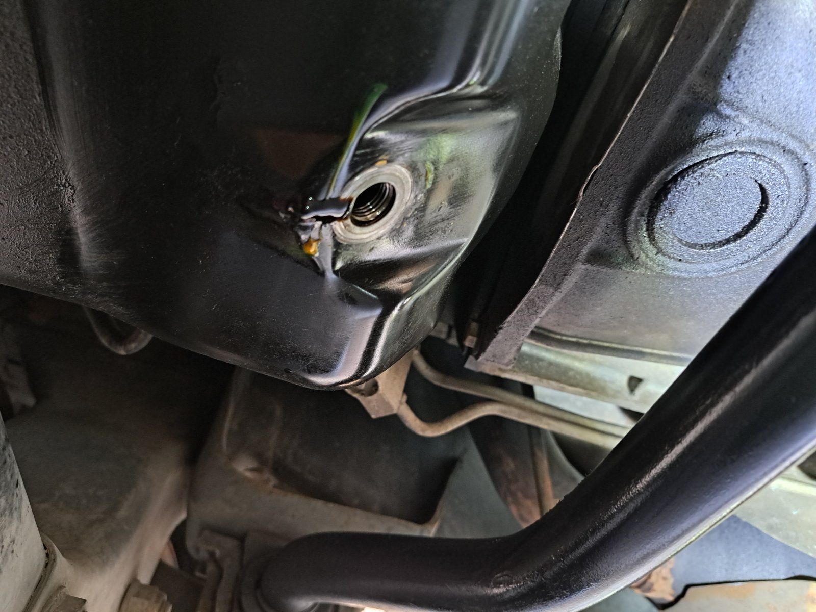

In another thread I had posted two pics of a neighbors F150 oil pan drain plug leak and I felt, after changing the oil and filter this evening and installing a new drain plug and seal I would post the pics of what I found. A little history: Bought new in 06, always changed oil at Ford dealer or Jiffy Lube. Has had oil leak for 3 years, Jiffy lube mentioned oil leak 2 times on tickets but never from where, someone had tried to use 3M Weather Strip under the drain plug, when i removed drain plug this evening it had a drain plug that had a flat out diameter but as it got closer to threads the drain plug was slightly dished and the seal was as well, the seal had a soft copper outer diameter and had the rubberized inner part that showed the same dishing. Sorry, forgot to save the old drain plug and seal. The weather strip just came off in chunks and the sealing surface of pan was clean and flat. I was worried about pan threads but you can see they look good, instead of stretched like I thought I was gonna find. The new drain plug threaded in easily buy my fingers, so no thread damage. With the old plug, I could wipe dry and then wait 10 seconds and it would be wet again and getting ready to make a drip. This is why I trust no one but myself for even simple things like oil changes. See pics and decide and I welcome your thoughts. Needles to say, I have now earned his work for my slowly but surely getting busier garage, out of my house. I cater to my American Legion friends, VFW friends and my neighbors. Don't want strangers around here scoping out my tools. I also, just yesterday, got a 2 or 3 day a week part time job at a local self storage facility, in the office. Those that know me, know that for the last 10.5 years I have been a resident manager at 2 self storage facilities.

As an aside, @OR VietVet, what do you think of that gasket, is it silicone or something flexible like that? All I see on stuff nowadays (in my limited exposure) are crush washers that are metal. Or is that a new style?
IMO, it is a hard version of silicone but not completely sure. I do know, that when I ran shops and ordered in new drain plugs and seals/gaskets for rigs my techs were working on, I have seen the seals before and we used them with no concern or problems. You would have thought that some idiot, that worked on this truck's oil change before, could have done a much better job than 3M Weather Strip. I mean really, C'MON MAN!!!! He/she was either an idiot that did it without telling anyone in the shop or asked the service advisor/writer/manager and that person would be an even bigger idiot for ok'ing the smear job.

I got an alert about this thread and when looking again at the new seal/gasket, I can see what else I should have mentioned, and that is the 3 rings of circular ribs on the surface of the seal itself. Those are 3 rings of barriers that oil would have to get past to allow for a leak. I looked at that drain plug two days ago and is still dry under there.
