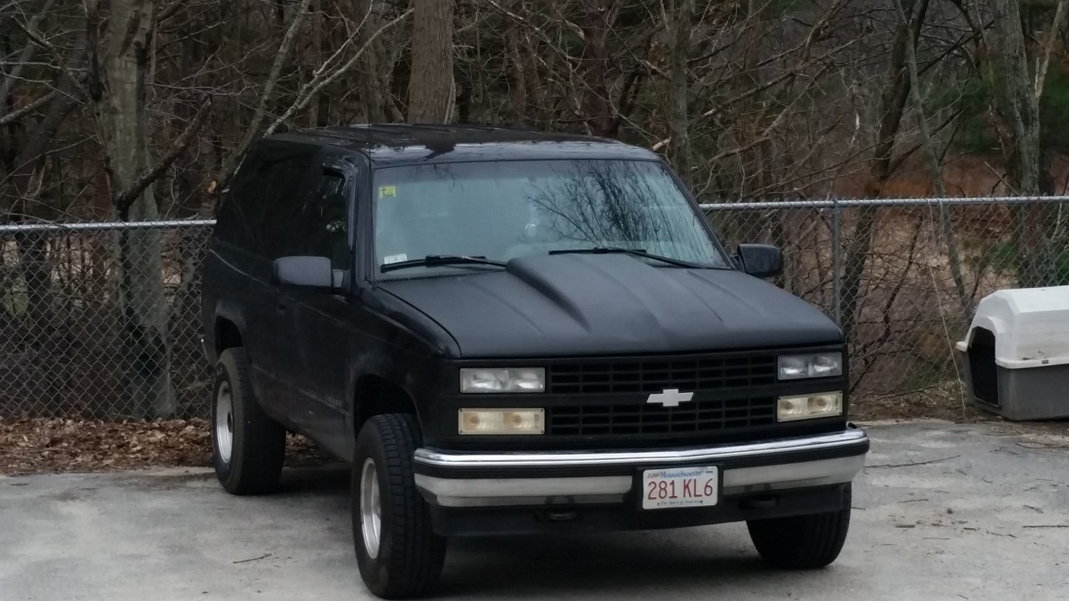

Welp i just scored a sweet metal cowl hood off craigslisy guy wanted 450 i got it for 250 but after install she sticks up a bit in the front anyone else have fitment issues ? Or anyone have a remedy ?

Im not sure if the hoes had an adjustable hood latch. Try loosening the bolts that hold your hood latch on and try to bump it down some. Also on the left and right side front corner is little rubber stoppers. You can spin them in and it will allow the corners to sit down farther. Might have some play in the hood hinges too if the back is too high.

After some plasti dip
