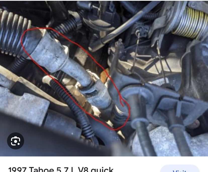

On the passenger side of the engine and on top of the engine, there is a PITA heater hose connection at the passenger side front top area. Known for leaking coolant and then can puddle enough to run back along top area and drain off at the back, when driving and the coolant moves. Or the intake. You can rent a cooling system pressure tester and do a proper basics test and see what happens. Do it with a cold engine.

Right on @OR VietVet. That plastic tee fitting in that area is a known culprit for cracking.

I have dealt with fixing that over the years, approximately a dozen times. Half the time the pot metal snorkle, where the hose snaps in, would not unthread and would break off. Some guys just said, needs a new intake. I had to do a new intake one time but the other times I was able to get a sharp small chisel and a hammer and coming at it from the side, was able to break off chunks and dig them out till I had a whole side out and then the rest would vibrate loose and collapse on itself. We always had one guy in the shop that had a thread chaser/tap to use and clean the threads and then gobs of anti-seize on the threads for reinstall of a new snorkle/fitting. PITFA! Worth every dollar I charged for the labor time to do that.
