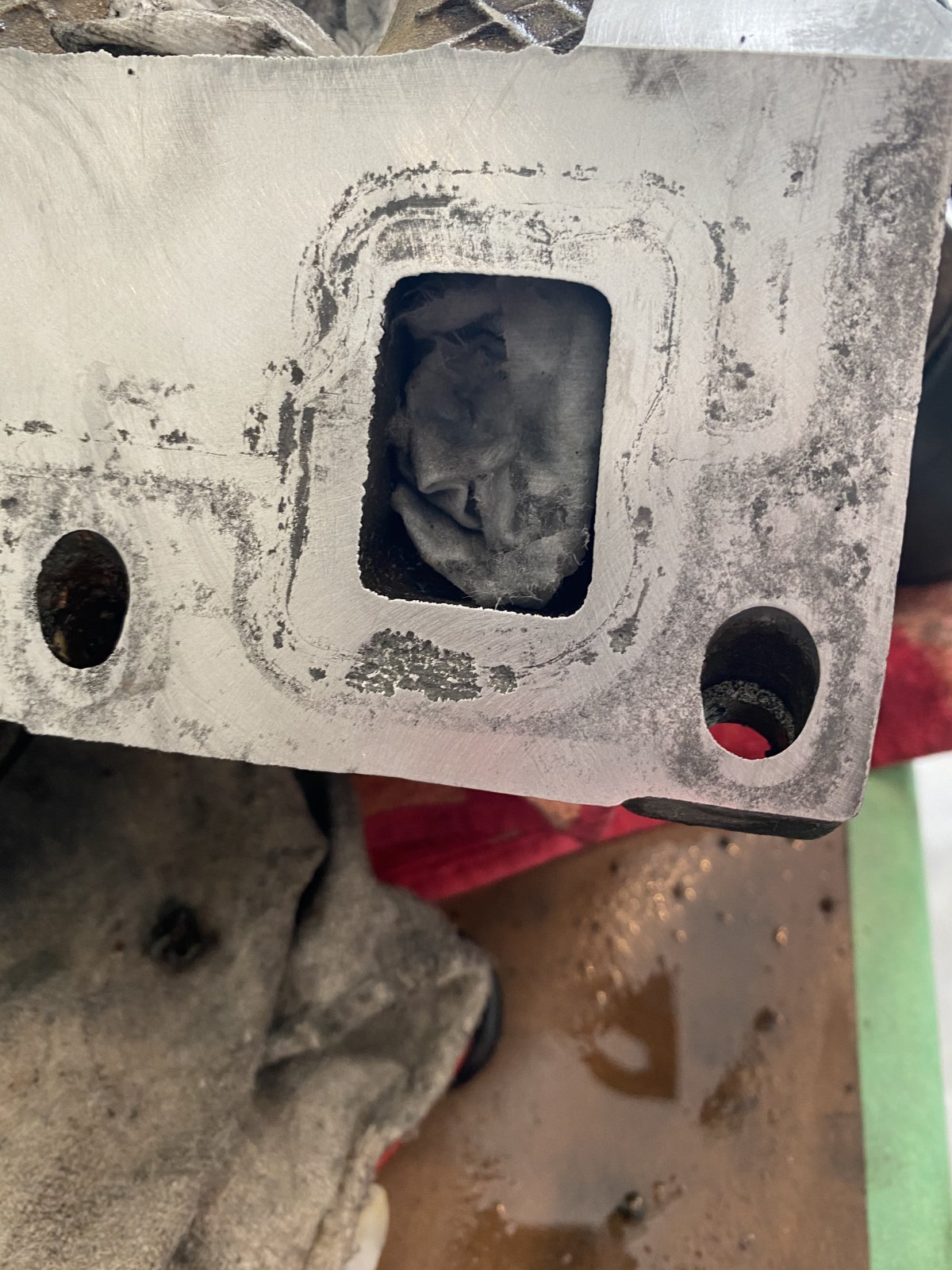

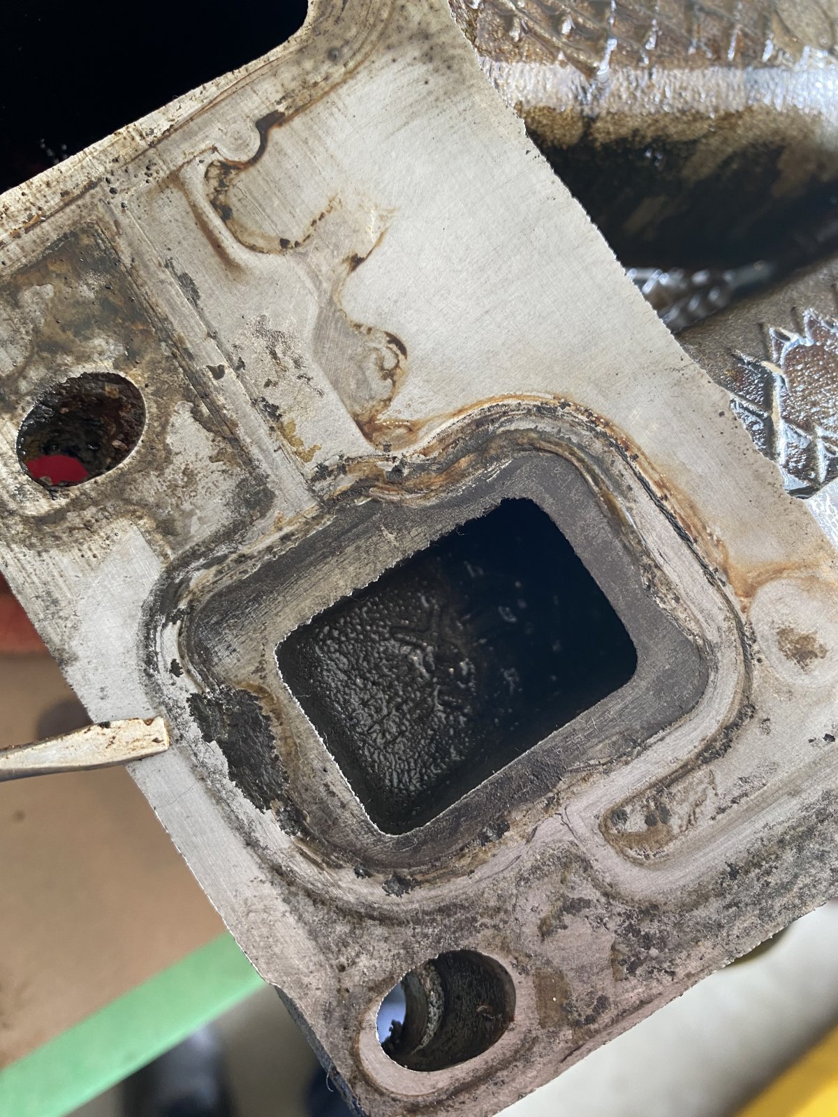

I had the same symptoms as you. (Along with misfire codes and a vacuum leak) I took a gamble and only replaced the lower intake gaskets, and cleaned everything, and luckily there was no longer coolant anywhere on the engine. This is what my coolant port looked like on my Lower intake.
