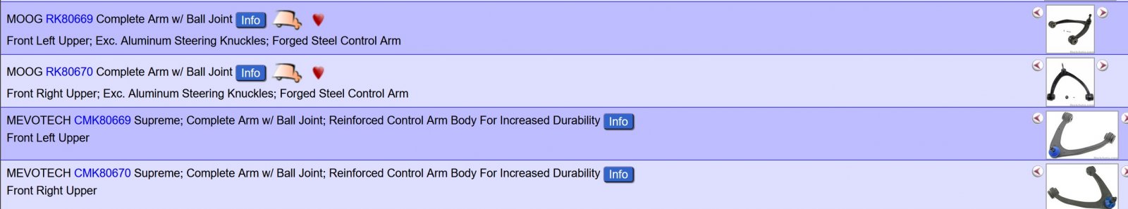

rock auto shows on some control arms "Exc. Aluminum Steering Knuckles"
You will need to verify if you have aluminum. Can be done by sight and using a magnet. Aluminum is lighter in color and is non magnetic (typically). You may need to do some scrubbing on your knuckle to get a good look at the color.
