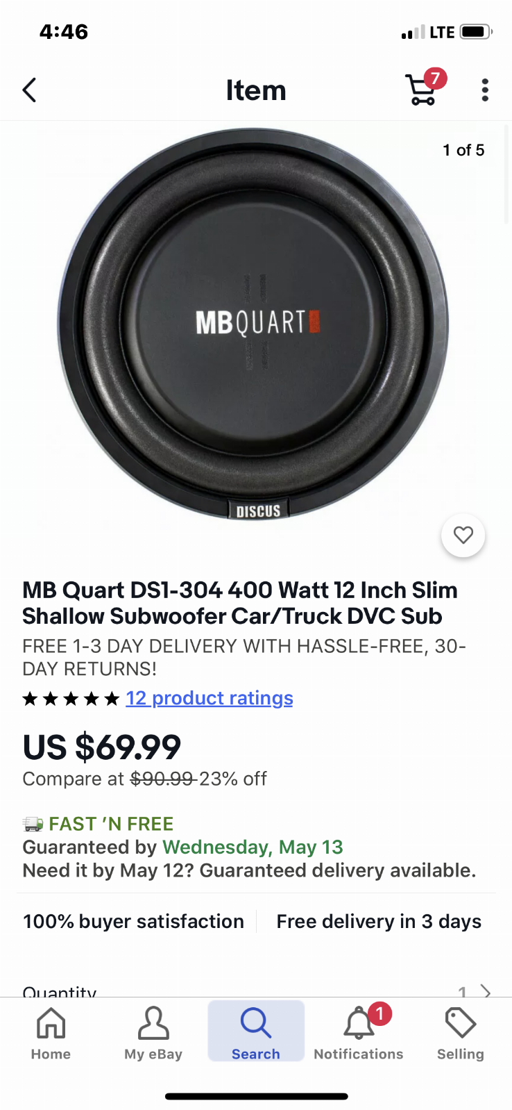

I also found that MB Quart makes a sub that fits the factory sub box really well. I’ve installed a few of these with good results.
https://www.ebay.com/itm/352671124194

Yep, junk yard is the best option. Get the little clips from the donor truck for the box! Otherwise you will have to fab something to secure it. I have the quart sub-it’s ok for what it is

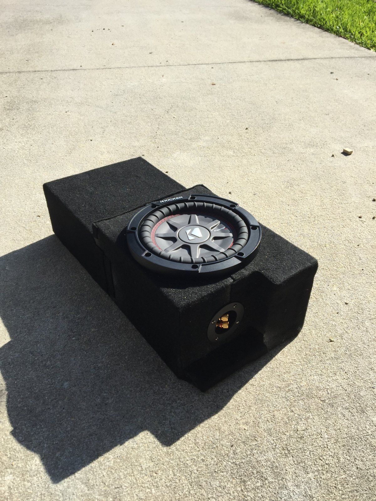

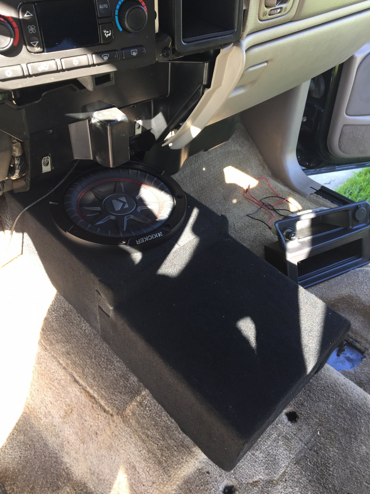

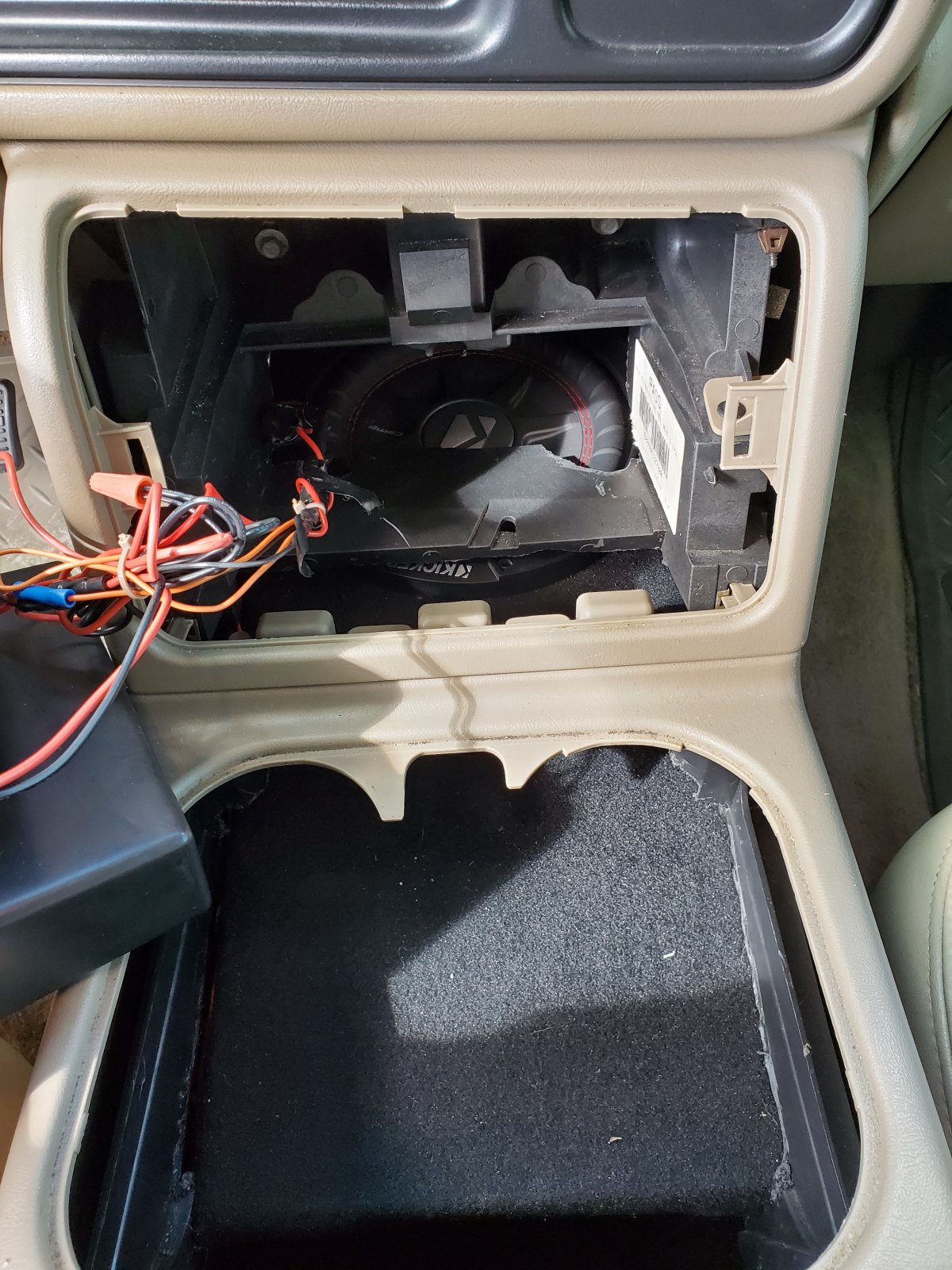

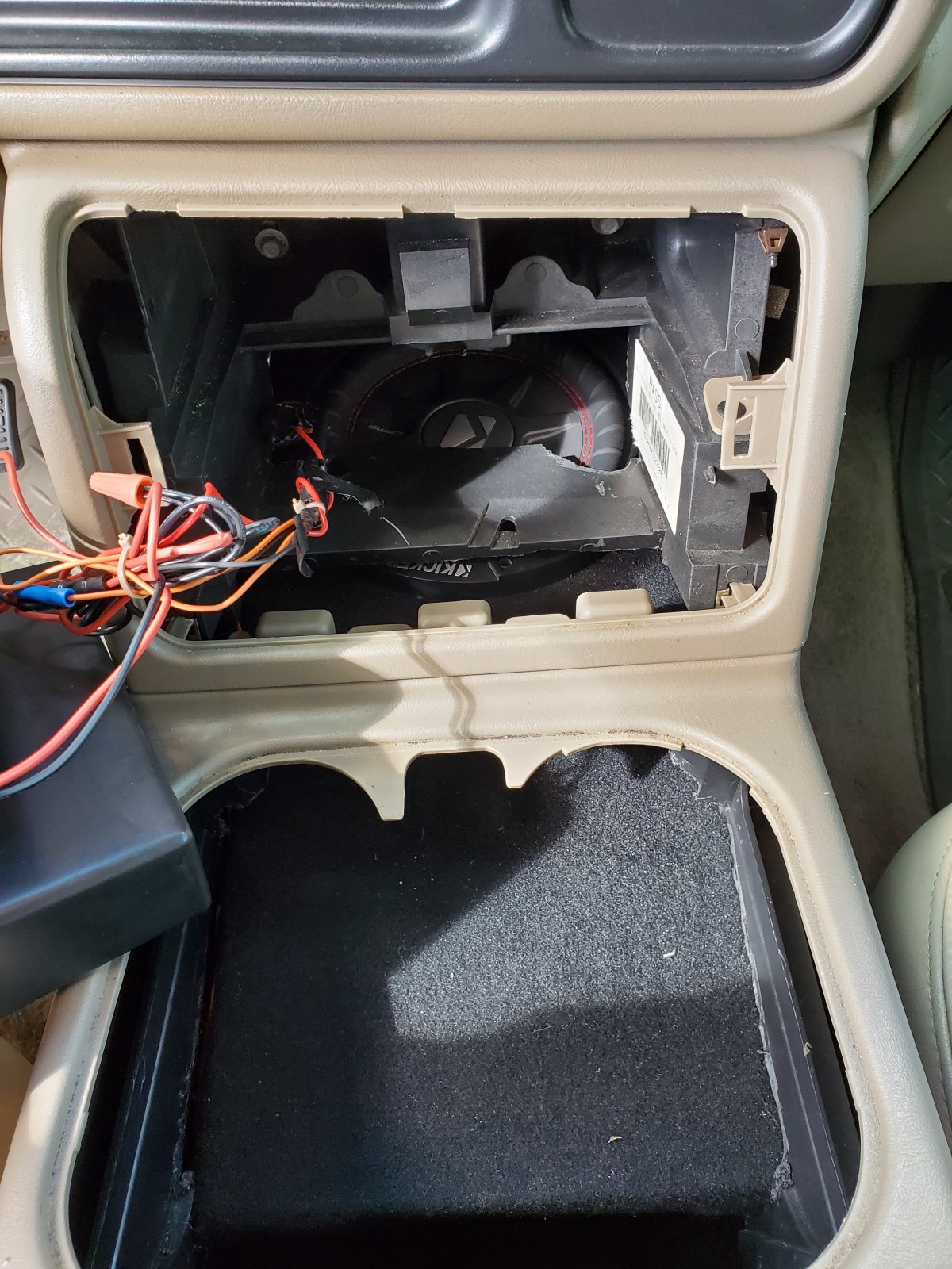

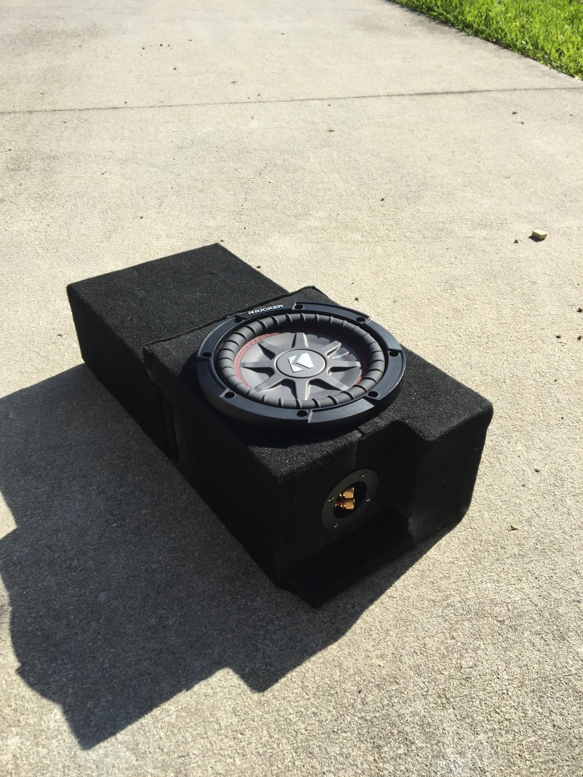

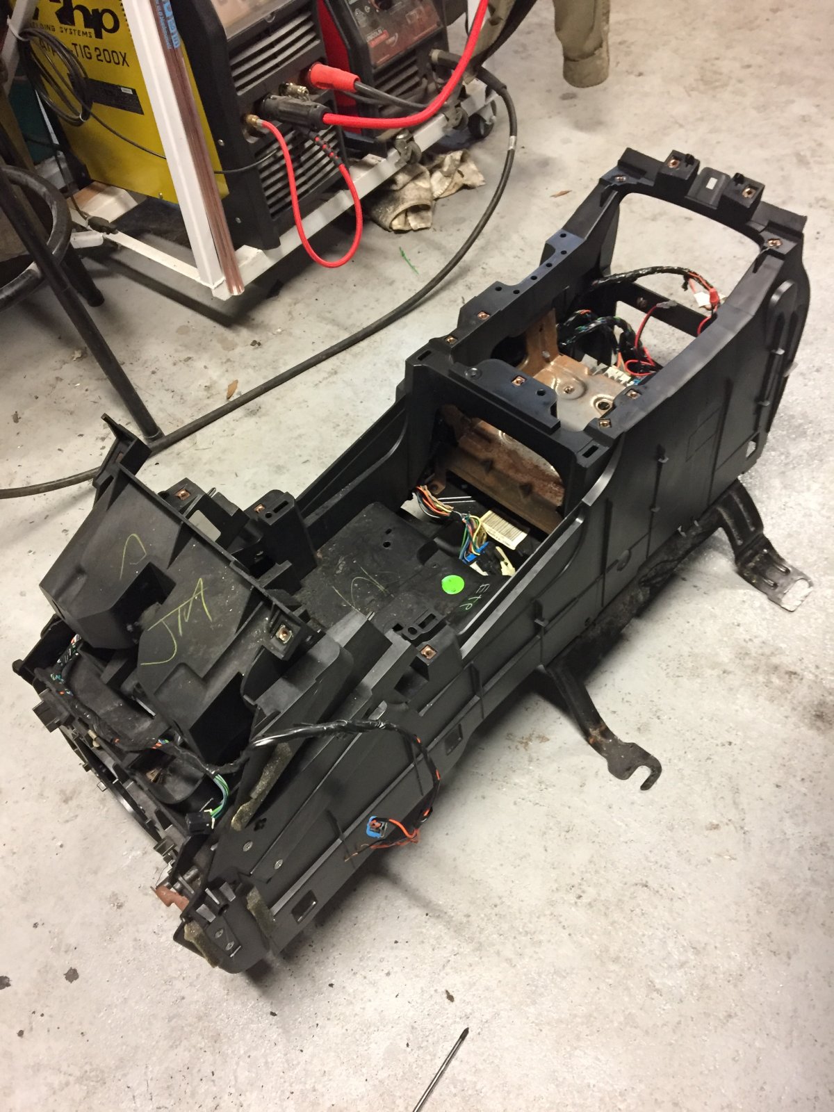

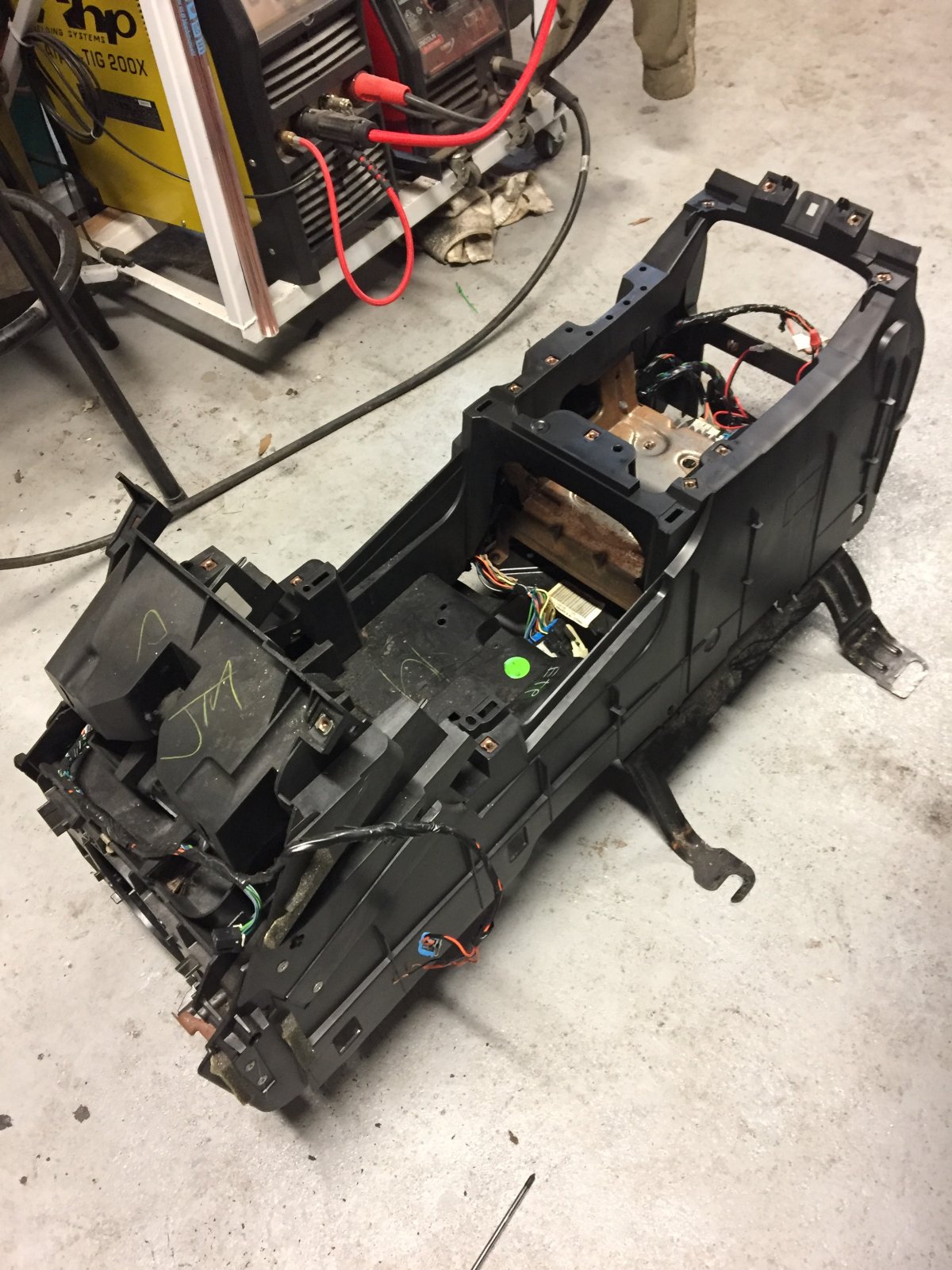

In my 03 tahoe (with bose) I gutted the center console amp and sub, and then made a custom fit box with an 8" kicker. It is just enough bass and it is right up front where you can feel it.
I used to have two 10" infinity subs a long time ago, but that took up space in the rear. This is much much better, and depending on how you make it, there's a nice opportunity for small hidden storage underneath your cup holders where no one would think to look.

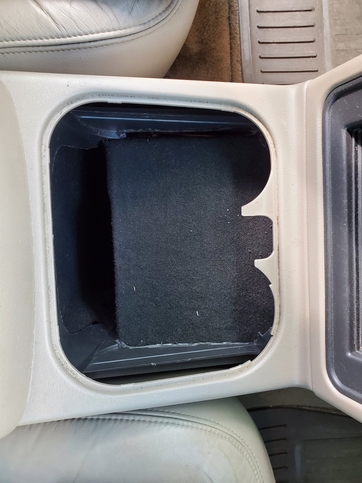

Pretty slick! Nice job. Have a pic of it inside the console with the cupholder out?

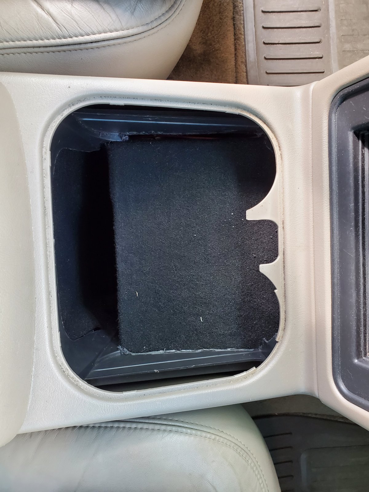

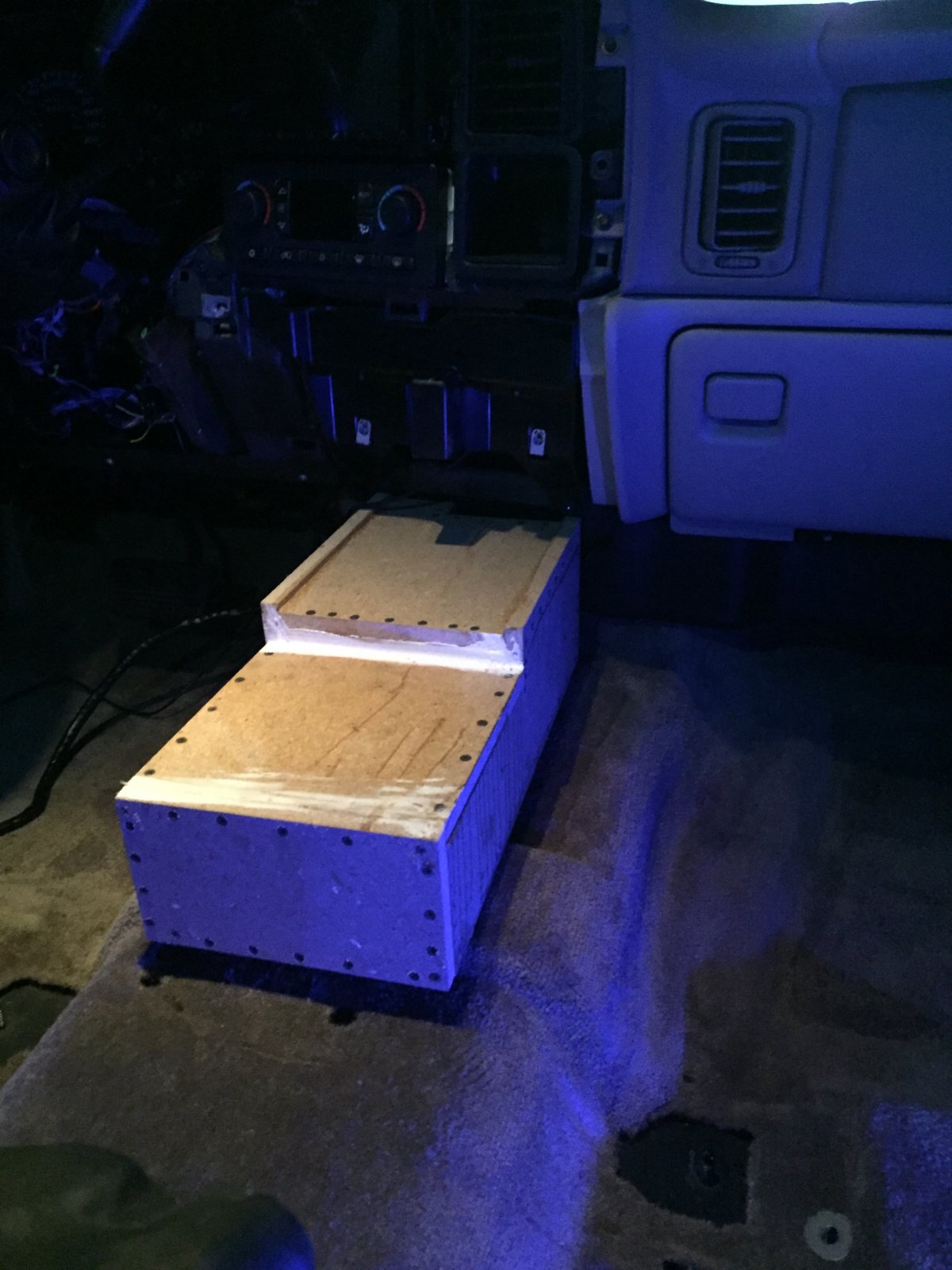

Thanks. Yup just took one for ya. The gap is between the back of the sub box and the front of the console compartment. It is deep and several inches wide, and I have some extra speaker cloth in there for a nice comfy storage spot, positioned just right to quickly reach in there.
I had to build a mock-up box with cardboard to get the sub box dimensions just right. It took me two days of building and I almost gave up, I am very happy I didn't.
