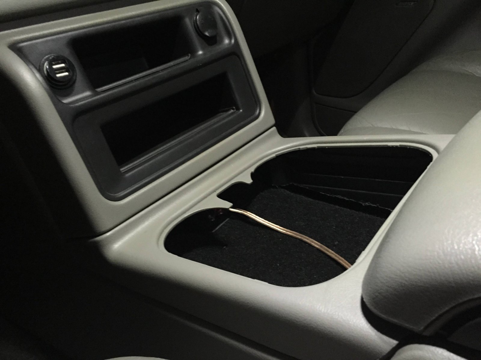

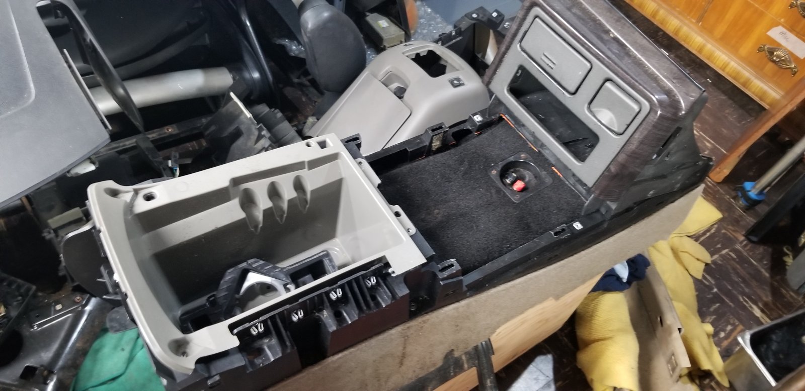

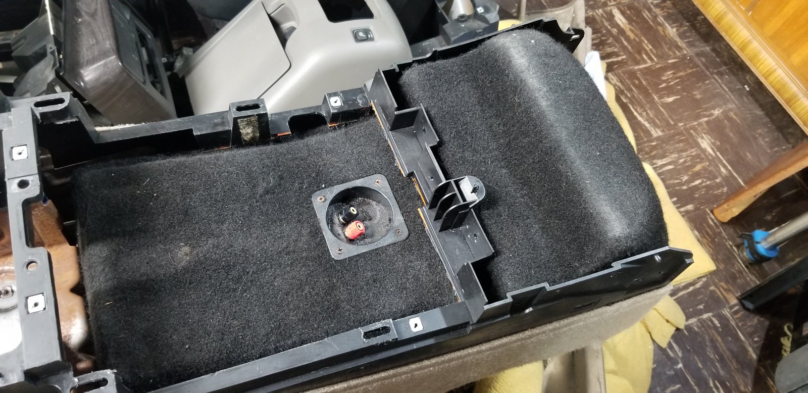

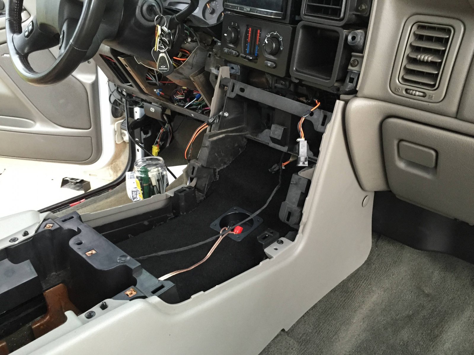

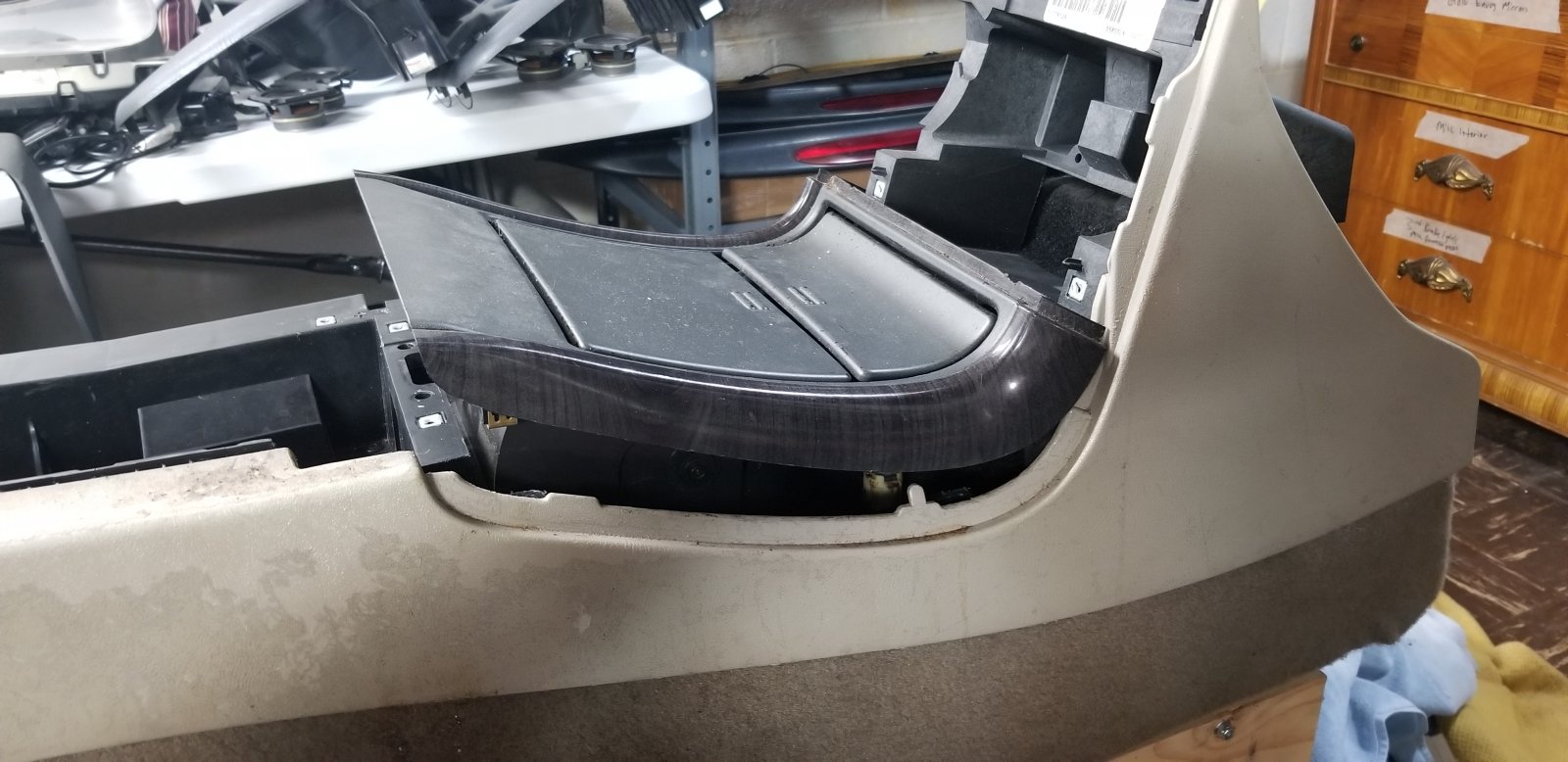

I had this same question after picking up a cheap stealthbox for my Denali, and happened to have a spare escalade console lying around as well. I did some cutting on it per the factory stealthbox instructions and discovered the issue largely lies in the cupholder design on the Denali and Escalade models. The stealthbox can be made to fit beneath the console as it would on a standard Silverado, but the lower sweeping top trim of a Denali cupholder piece will not snap down all the way. You will also have to cut out most of the structure that holds the cd changer assembly.
Here are a few install photos I found from a Silverado install. Lots more room height wise between stealthbox and cupholders.

Wow. Thanks. Couldn't be a more clear answer, even pics. Exactly what I needed. Now begin process of piecing slt console into denali. I like slots and cubbies better than scratched lids in denali/ caddy. Did not expect that nearly all '100' pieces of each console were different between models.

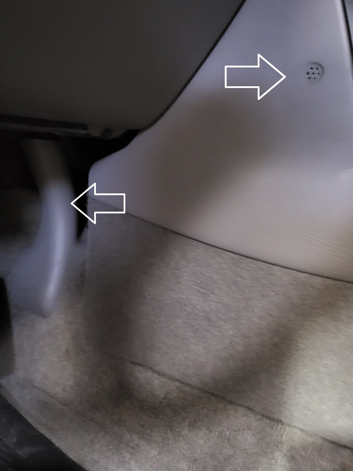

Also, because the denali version is new to me, wondering what these 2 differences are? 1. Tiny round speaker grill.? 2. Upright plastic piller (guessing it hides a harness)
Thekidandy
Aug 4, 2021
The small grill has a microphone sitting behind it. It's part of the noise canceling volume function of the Bose audio system. The plastic pillar is a cover for a mental support bracket that if I remember correctly bolts to the floor and up under the dash
