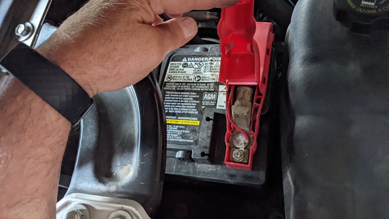

I have a set of LED cube lights that I am installing on my bumper. The installation for these lights says to connect to the battery. However, the battery terminals I have don't have a location for attaching accessories (no threaded post with a nut). The only threaded post and not that is on the terminals are there for tightening the ends to the battery post. I attached a picture of my terminal type. Is there another place on 2007-2014 models for accessing battery power for accessories without connecting directly to the battery?

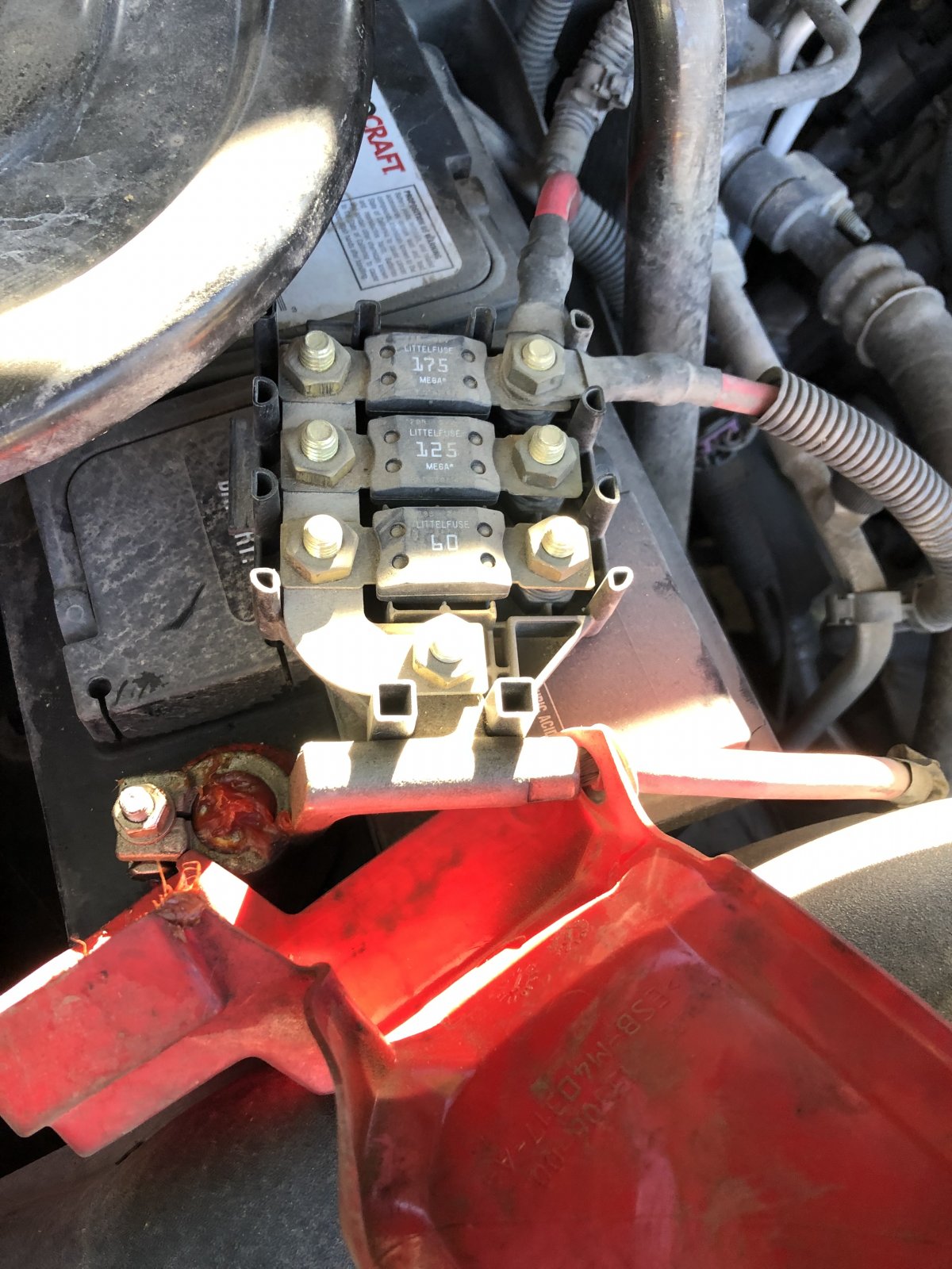

Install the positive lead on the main fuse block on the firewall on the passenger's side. Just be sure to install it on the side AFTER the fuse, and not on the battery side of the fuse. You can connect the ground wire to a ground post anywhere in the engine bay.

I see no problem attaching an eyelet to the positive battery cable "tightening" stud/nut/bolt. Just make sure your positive wire to your fog light relay and switch are fused.
Similarly you could add an eyelet to where the large positive battery cable bolts to the main under hood fuse box.

Does it have a fuse as well? With that low draw, you could potentially use one of those add-a-fuse things to the fuse block under the hood.
^^This. No need to connect directly to the battery for that low draw.
Some of the 7-blade trailer connectors have the reverse light circuit wired to one pin, so you could use that if it's suited to your purpose. Otherwise the 12v Aux circuit in that connector would be an option, but you'd need to add a switch somewhere.

I guess I should have asked, are the lights going on the front bumper or the rear? If up front you should be able to use the stud (under the fusebox) for the trailer 12v auxiliary power. Look up trailer brake controller wiring on etrailer.com and there are videos showing where the studs are. I'd use the aux circuit, not the trailer brake circuit.
