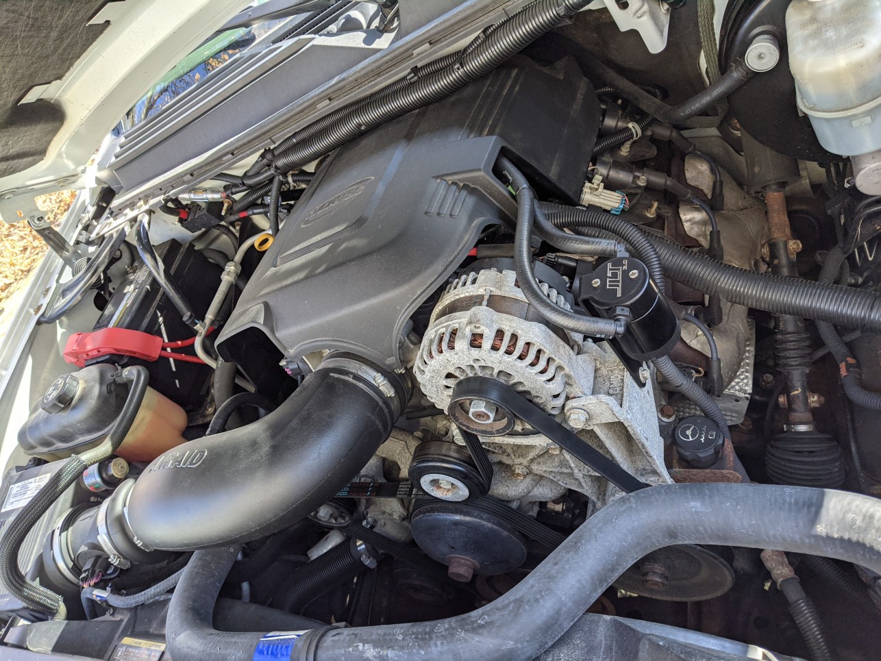

$58 Amazon special. Purely for sound and aesthetics.
The TB, manifold, and heads are where you'll find gains, not the tube.

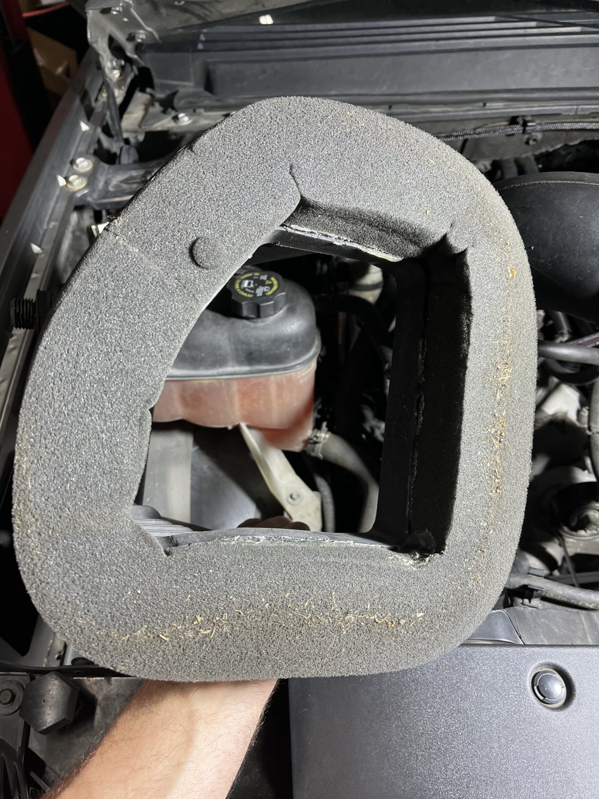

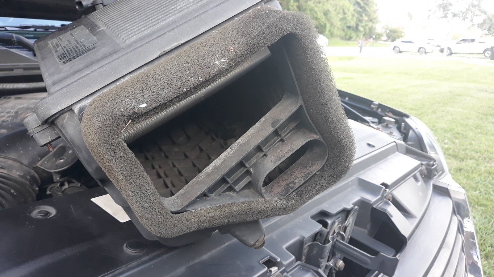

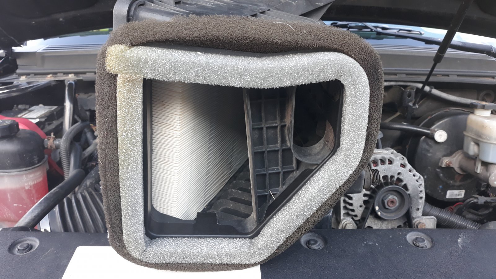

The factory setup is a damned good design as it isolates the intake air from the engine bay heat. It just looks boring and the duct has Hemholtz resonators to quiet down the intake air sound. It is NOT choking the engine of air. To improve the looks and sound, throw on an MIT. The one weak point to the factory design is the seal between the filter box and fender. That thin foam seal and the adhesive securing it degrades with time. It falls in or rots away, allowing a little engine bay heat to be sucked in. It's still a very small amount of hot air compared to the pretty chrome tube and giant cone filter setup.
My solution for the seal starts here:
Checking it after three years- Sealing great!

Swathdiver,
What type of foam and adhesive was used for your airbox seals?
Critters got to mine.

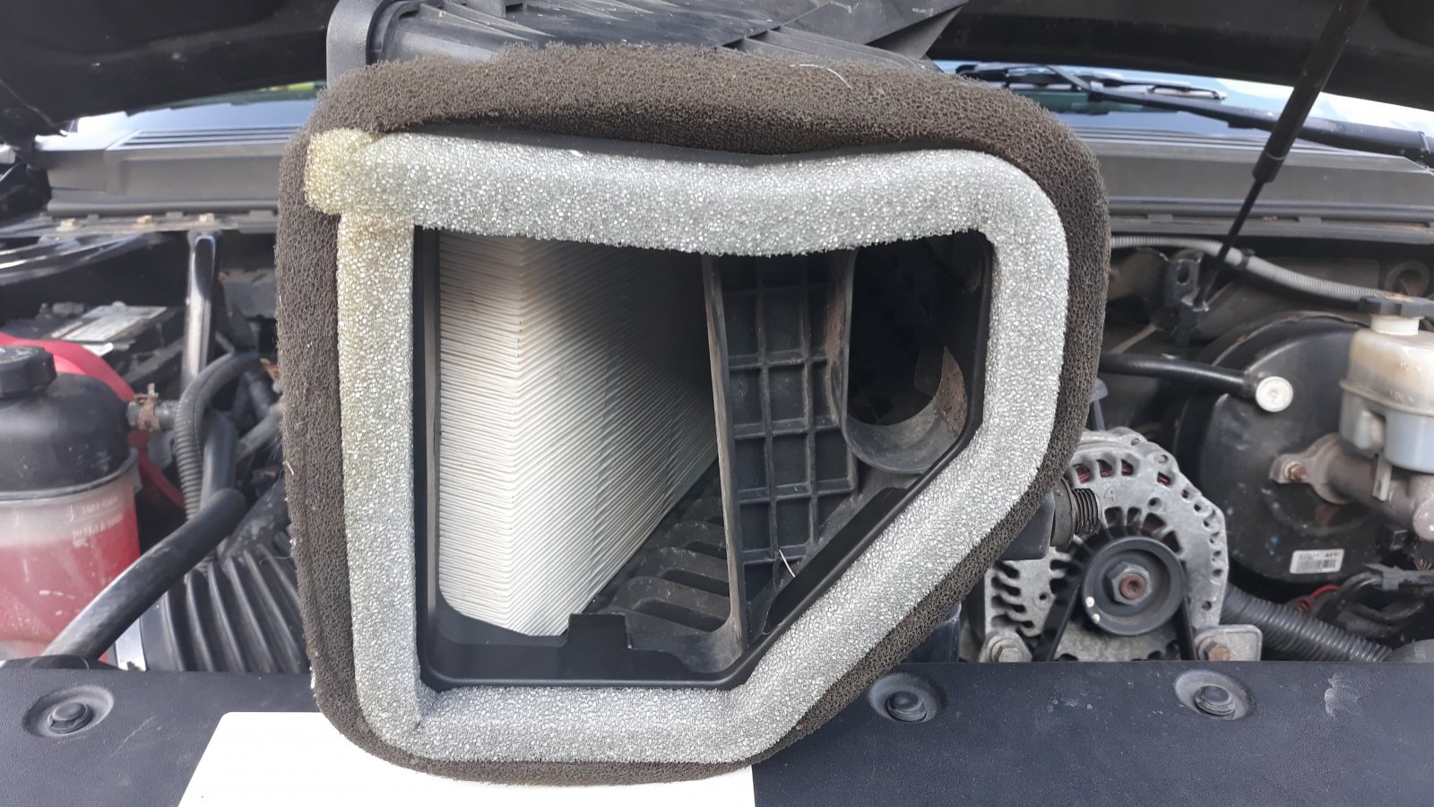

I forgot there was a snap-in factory replacement! I still prefer the super tight and firm seal I made, though. Although that new one looks to be wider and more dense than the original.
