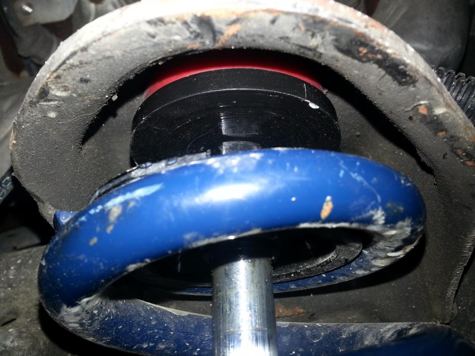

Got the prototype bushings installed... now I am totally maxed out on threads for as high as I can go, and my ride height actually might be a bit lower than it was. I think these will be a good solution for those looking to go lower
Took a couple pics of my shock towers and they are in just as good of shape now (2k miles) as they were when I installed everything. Pics later

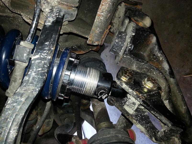

These pics show the shock tower and how it is still in great shape after 1900 miles with no reinforcement. Also shows how much threads I have run the adjuster nuts up, which was basically as much as I could possibly turn. Idk if its actually maxed out, but my measly 240lb ass couldn't get another 1/4 turn
